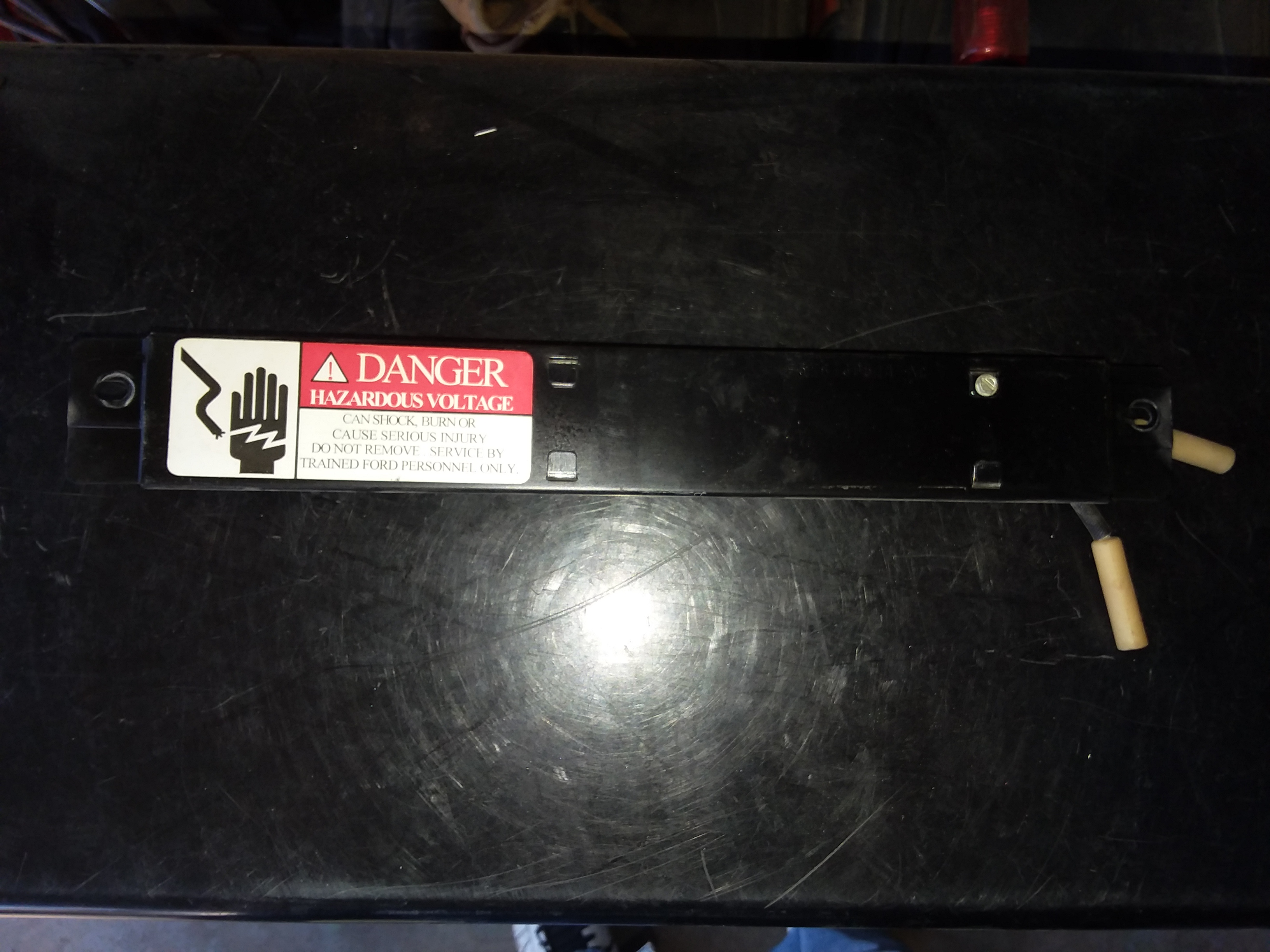

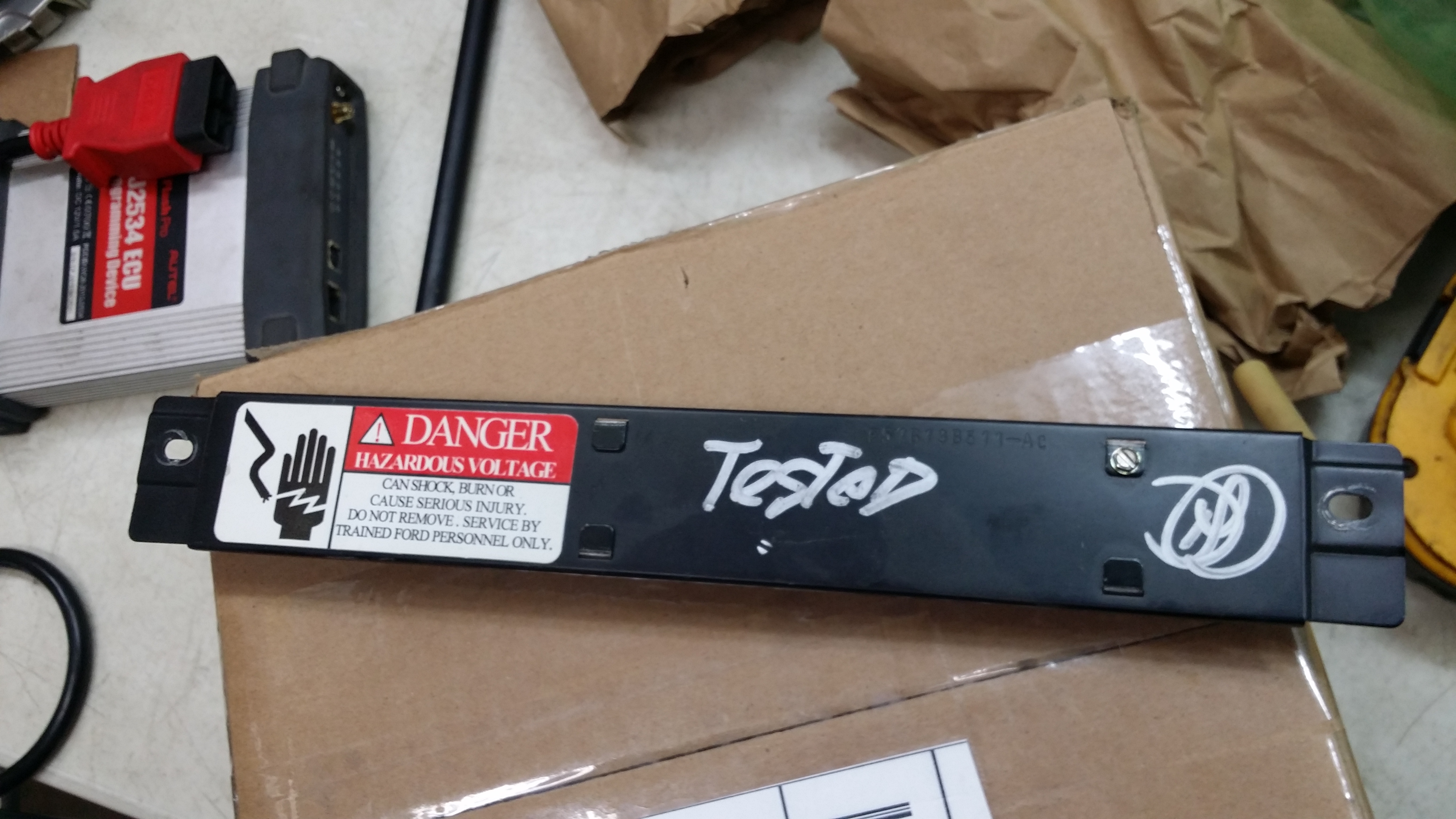

Oh and the 3rd brake light issue is probably the ballast. If you use the brakes with some but low voltage they like to die out. I have a good one I could ship you for testing purposes.
Yeah? That would be awesome. Thanks! :)
I just picked up the new switch, and will get it on, and see WTF is going on. I was going to put the meter to the power source going into the ballast, and see whats up with that too. If there is power to it (pedal depressed), I will give you a shout about that ballast you have. If no power, then I know to trace that circuit back to the harness that was made.

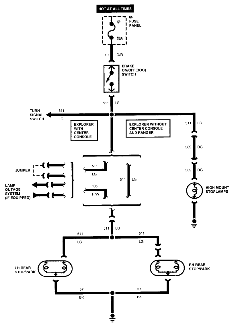

#1 on the priority list was to get a ballast for the 3rd brake light. The rig is stuck in the driveway again, until the brake lights are working. Simply ridiculous to have to go thru this, but it is what it is. I swear this rig, just doesn't want brakes.

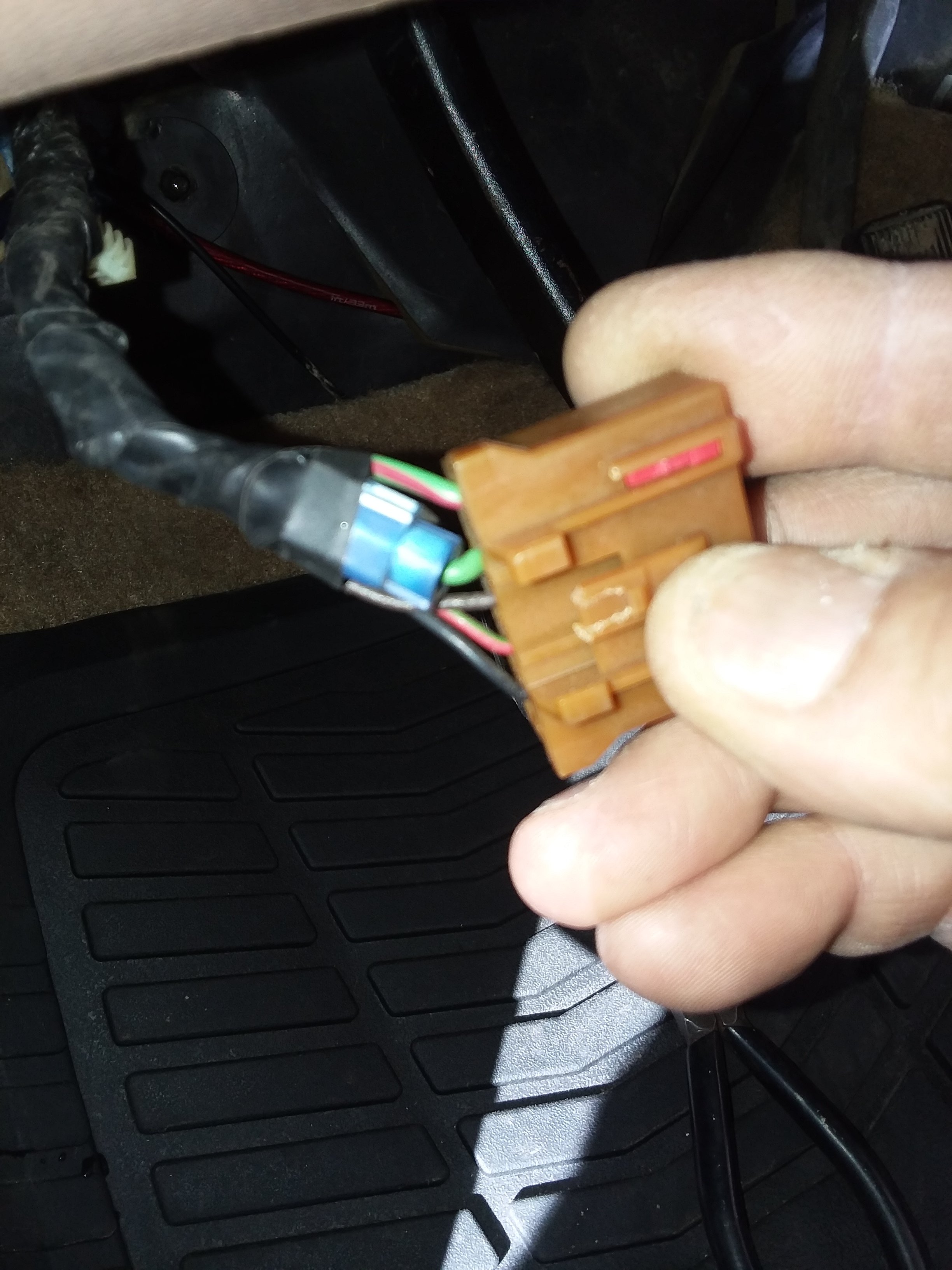

So I installed the new brake switch. Upon closer inspection, I found that there was one of those cheap ass splice connectors on the LG wire, and no other wire leading into it. Ok, wtf? Left it be until I can continue on. Brake lights work, and they shut off. Did this same thing with the last switch, but this time, I made sure the pigtail was secured better with the push plug. I'm pretty sure that wire is broken, and movement with the pedal is causing the short.
So I checked for power to the Ballast. The Multi meter read good at the battery, and another hot wire in the back. Disconnected the ballast connector, propped the brake pedal, and checked for power. Nothing. Nada. Zilch. Hmm, ok, so for grins, I swapped in the new ballast, propped the pedal, nothing again.
I then disconnected the gray can connector at the tow harness behind the Dr side brake light. Cleaned it real good with contact cleaner, and then with the air gun. I am familiar with this procedure, because it is the very reason, I found this site back in 08, looking for answers to getting this light working to pass state inspections. Turned out to be nothing more, than dirty connections inside that gray can. Nothing, nada, and still Zilch.
So I asked a friend to send me the diagram from Aldata, for the 95 brake circuit. It looks like the LG wire for this, runs the main power to all the lights, but it changes to DG, mid circuit for the high stop.
Tomorrow, I am going to try a jumper from one of the brake lights, to the ballast, and see what happens. If it works, then I know that power is cut to the ballast, and more then likely, the BOO switch harness is the problem. If not, then I am up a creek, without a clue, how to fix something in this hybrid home made harness by that shop.
