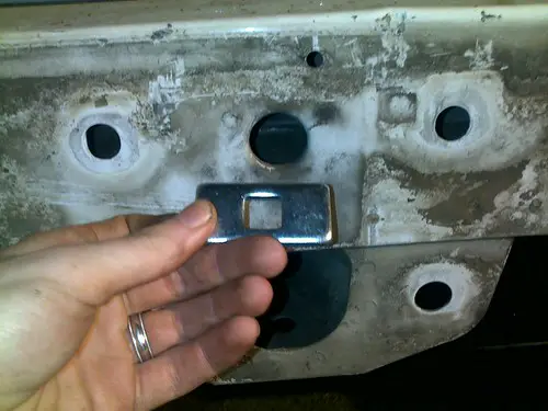

so with the bumper off I realized the access hole to the frame is WAY to small to get the bolts in with the brace that the hitch requires. So I've cleaned up and given up for tonight. I'll start on it again tomorrow here. Any ideas on the access to the frame?
I'm attaching an image to show what I'm talking about.
I had the same problem and drilled a couple of clearance holes for the plate to pass through. Had to file a little bit but worked.

Where exactly did you drill access holes? Because waking up this morning I have renewed strength. I have to get this done today before the trip. But I'm still baffled on how to get these darn things on. The reason I can't just drill and nut everything on. Is because there is no access to the top side of the frame. The bolts have to go INSIDE the frame. But the access hole they have is way to small for that. Argles...
I can't remember exactly but I selected a drill bit that was bigger than the thickness of the plate. Think of a slot needing to be cut into the metal. It just so happens that there is a big hole there already. Use a 3/8 or larger drill bit and drill at opposite ends of the large hole. Make sure and start drilling far enough to the outside of the hold so that the drill doesn't walk over. Do the same on the opposite end of the of the big hole. You may need to file a little bit or maybe you can walk the bit over to create the slot. I tried to attach a simple drawing but don't know how to do that. Hope this gives you the correct mental picture. I seem to remember that you need to fish this bolt and plate down the box channel. A guy at a UHAUL showed me a slick way of doing this with no cuss words involved. You need a piece of wire ling enough to go from one hole to the next. This guy used a Delta washerless faucet spring soldered to the end of the wire. The bolt threaded right into the spring, snaked the bolt and plate through the hole/slot and dragged the bolt right into place and through the hole. I've mounted a few hitches to my aerostars and this may or may not be what you are trying to accomplish. Good luck!

Well I was able to get some access holes by using 3 jigsaw blades, a crow bar, a hammer, 2 bloody knuckles, some burnt skin and a pair of plyers. Theres now a nice sized access hole in the frame UNDER the van on either side. I didn't realize that what I thought was an access hole was actually just a plain hole with another metal plate inside. I used your method with the wire. I actually threaded the bolt onto the wire and was easily able to drop it in place. Thanks for thar ^.-
