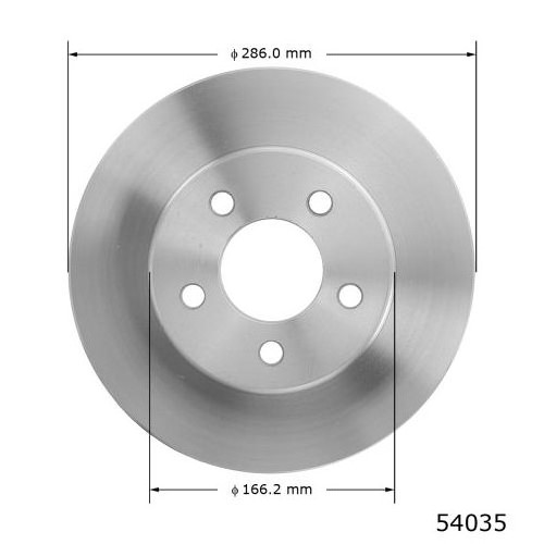

Ok Ive been looking at powerstop rotors and pads on Rockauto and they have a rebate/promotion with 70$ off til the end of the year. I planned on ordering these until I went to the description which shows the 11.22 diameter rotors with the front bolt circle being 4.5 and the rears being 4.25. part# KOE1861 .I am assuming this is the lug diameters which I know cant be right for the rears. I can get all 4 rotors and pads for $70 after the rebate.
On a side note Rockauto also shows a 11.29 diameter front rotor for the same vehicle but part# KOE1855 with the 4.25 bolt diameter.
Which is the right set to buy?
