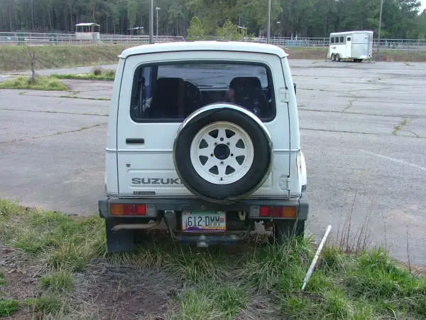

oh yea, heres what its butt looks like:D
That's exactly what ours looks like .. but we've been doing so much cutting in the past few days.. the entire floor behind the front seats, the rear bumper and the rear cross member are gone ... tomorrow new 2"x4" 1/4" wall cross members is going to be welded to the rear of the frame rails and right under the firewall.. these are going to be the mounts for both the roll cage and the rock sliders. The gas tank was also removed and ditched cauz we plan on making our own gas tank and mounting it higher away from rocks. I'll take pics and start a thread on it hopefully tomorrow.
BTW before we started cutting it up, I drove it off road for a little bit. It out climbed a lifted 4-door Blazer and a lifted Nissan pickup due to its very short wheel base. The Blazer and the pickup high centered where as the Samurai just kept onnnnn going :D
