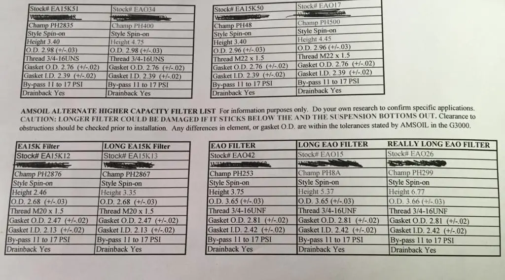

1. The standard filter is WIX 51515. As noted in another forum, there is another filter that is a few inches longer, WIX 51773. If you go this route, you will increase oil capacity by 1/2 qt, and the filter will be much easier to reach when it is time to replace it. The flow/pressure specs are the same. As with any filter, you will want to pre-fill it with new oil to prevent start-up lifter clatter. The longer WIX filter will take almost a full quart to fill. This filter is about $10, which is high. But, hold one in your hand, and you will get it.
