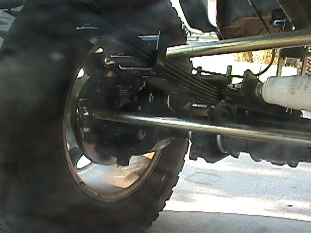

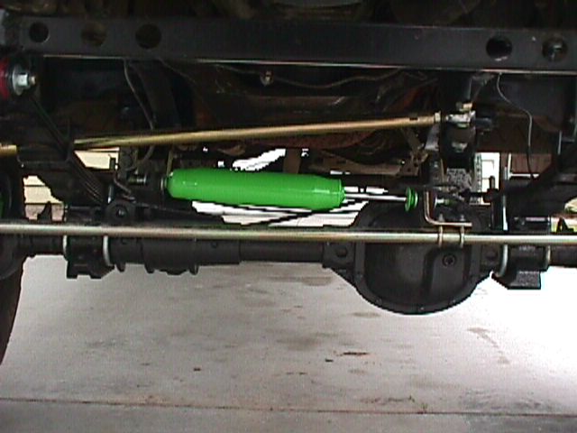

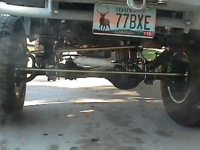

Great start! Here's a solution for your steering: M.O.R.E. makes a steering correction kit for the D30 and is awesome! That's the best mod I did other then the SAS. Here's some pics of mine:
