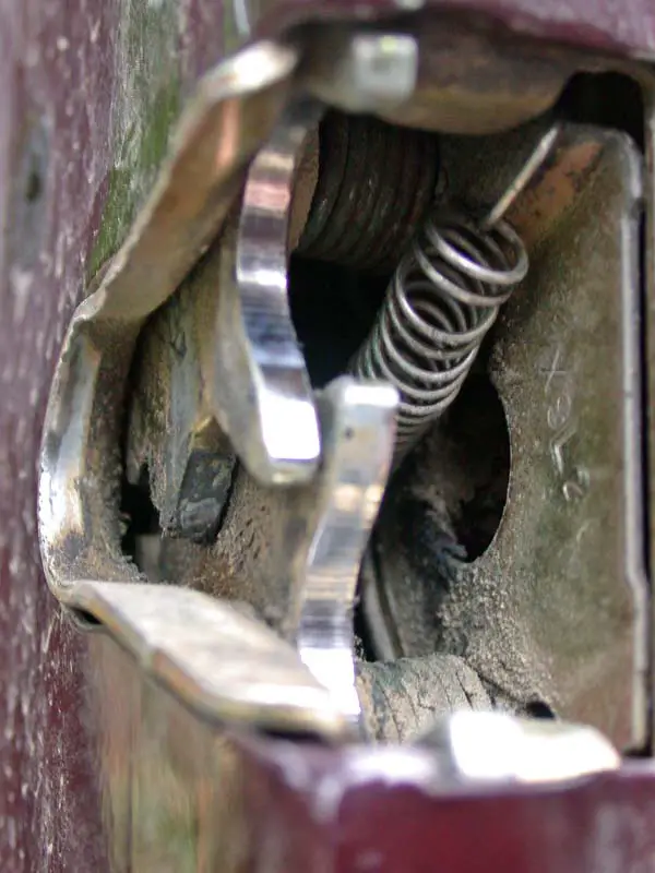

Maybe yours door failed the same way mine did. I just fixed up mine yesterday afternoon. I did a search for "door latch spring" and after a lot of reading I had some good hints. Here is the jist of it...
I could see a small spring hanging loose inside my latch - it was just laying there attached on one end only. I was able to remove the spring using needle nose pliars. The hook on one end of the spring had snapped off. I carefully bent a new hook shape on the remainder of the spring end.
Have a look at a working door latch to get an idea of what the spring was supposed to provide tension between. The spring holds onto a kind of T shaped piece of metal inside the latch that is pulled upward by the spring. It is easy to hook the spring back on that T shaped piece. I couldn't make the other end of the spring hang on to the same place that the one in the working door seemed to attach to but I don't think that is critical. I just hooked it to the upper part of the latch towards the outside of the door and it is doing its job again of putting upward pressure on that T shaped part and now my door will unlock reliably.
This didn't take a lot of manual dexterity to repair. I wish I had done some more reading before I pulled the door panel off and peeled back the inner door seal because it wasn't necessary at all. Everything could have been done on the outside edge of the latch. I can take a picture of it if you think it will help clear things up.

heyok: a pic would be great. i have already pulled the pannel and the inner seal and found that i didnt need too which kinda suks but owell. i see the end of the spring that is not attached but i cant tell where to hook it on to so a pic would be great. thanks

I took a pic - not the best - but it might help. The top end of the spring is just hooked over the lip of the latch casing.
