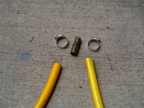

OK--Yesterday I added a bottle of "Prestone super flush", and the wife and I went for a long cruise--
Today I disconnected the left, or passenger side, heater core line-and inserted a double ended brass nipple to the hose. On the other end of nipple I used a 10' (or so) length of garden hose, which I had cut in half-so I could control the flow of water into the alley---Use the male end of hose for this.
I then drained all I could from the system, and poured it into used oil containers for disposal--
Next, I used the female half of the garden hose to plug onto the heater core stub.Just use the cut end, it will slide right on.
To this hose I attached my garden hose, and turned the water on.
Water immediatlely started flowing out of the hose that I had placed in the alley--
I left the radiator drain **** open, I have a small length of rubber line hanging off of it, to direct drain flow into a bucket. I then started the engine. I let it run this way for about 20 minutes.
Once the drain water from radiator was clear-I closed it off and let the radiator fill. Next I shut off the engine.
Then, I quickly re connected the heater core lines, started the engine and added a bottle of water pump lubricant--Then shut off engine and recap radiator.
I disconnected the overflow-and using a toilet brush along with the still running hose-I filled it while scrubbing it, letting it overflow to wash out the debris, in the process declogging my overflow tube.
I filled the overflow, ran the truck 3 times to burp it--and now am looking forward to cooler temps I hope---
For the summer I am using straight water--but I really think I fixed the slight overheating by unclogging everything--
Good luck!!
Here are the items needed to make the flushing tool-
` double brass nipple
1 cheap garden hose-cut in half-
2 hose clamps, so you can re join the hose and use it for other things--
