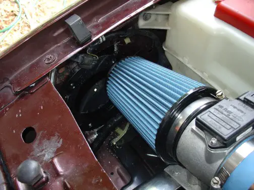

When I recently installed my new Amsoil EaU air filter ( http://www.explorerforum.com/forums/showthread.php?t=158049&highlight=amsoil+air+filter post # 8 ), I got to looking at the inner fender where the stock air box draws its air, and the holes are very small. I decided to open up the area to let more “outside” air in.
After removing the air filter as well as the custom MAF mount and MAF, I took a sawzall and cut a 4” hole in the area that Ford had recessed.
I didn’t like the appearance of this raw opening, so I went to Home Depot and purchased a 4” plumbing flange ( white PVC ). After test fitting the flange, I sanded the surface and cleaned with acetone. Since I didn’t like the appearance of the white color, I shot it with Krylon Fusion ( http://www.dickblick.com/zz014/11 ) flat black paint ( 3 coats ).
The flange was attached to the fender with sheet metal screws.
The project is the kind of task one accomplishes when a little spare time is on hand. The total cost of this 1 hour venture was less than $5.00.
I have no idea if this will have any benefit other than looking good ( and you really can’t see it with the filter in place.

Ah, now I see why you were asking me about fender space. ;)
I love your posts, just love them Al
Now I know what I am doing this weekend, I can spare me $5
Nice mod Al. I am thinking of just drilling like 12 1/2 holes in the fender well were the airbox is. I love your idea but am not good with the skil saw.
al, did this actually make any noticable difference in driving/performance?
as I was thinking, Doesnt the stock airbox just pull air from behind the right headlight and not even from the side fender wall? If I remeber correctly, the stock box has a small "horn" shaped cone on the front of the box and thats it

FYI That flange is a closet flange for toilets, and you can get them in different materials/colors.

aldive, couldnt you fabricate some type of sheetmetal box to house the filter? then it would be a cold air intake, or colder, at that point then drawing jsut underhood temp air
