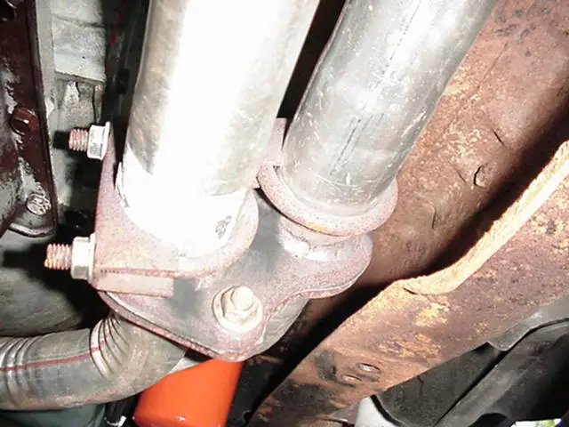

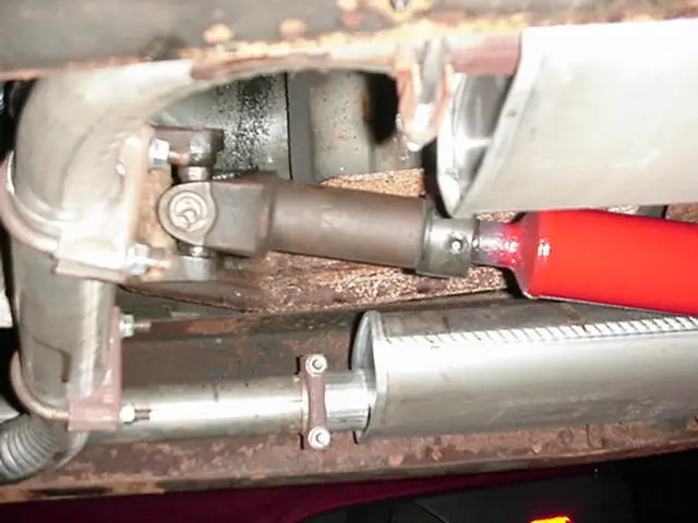

87 y pipe
That is a sharp looking dual exhaust. Correct me if am wrong. You have the small H pipe right after the driver side comes down over to the pass. side. Then both pipes go to somekind of flange. did you make that flange? Then both run back along pass side and then driver side exhaust crosses back over at end of transfer case to driver side, and then both over axels. Nice B11 :thumbsup:
Thanks for posting those pics :thumbsup:
the y pipe is a stock 86/87 one(they changed in 88)
which i might to use when i put a 302 in it. I cut the flange off a old one and turned it around so it would bolt the the y pipe.
??????????? :confused:
