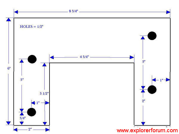

You can either order them thru Performance Accessories directly or you can make them or have someone make em.. I've attached the links front bumper & rear bumper brackets.

I found a shop to do it for me. There cutting them for me right now. $30.00
for the fronts. It looks like I can just drill new holes in the back brackets that came with the kit. I am giving the shop the template I made for them for the front brackets in case someone here needs some made in the future.

I see the layout up above for a bumper bracket but that is for a 3 inch bumper lift I am looking to lift mine 4 inches to meet the rest of my body I have a ford ranger and is is a 1996 also is it normal for the bumper to be welded onto the frame beacuse mine is and I can't seem to get it off to put it on but I will cut it if I need too to get the beast off
