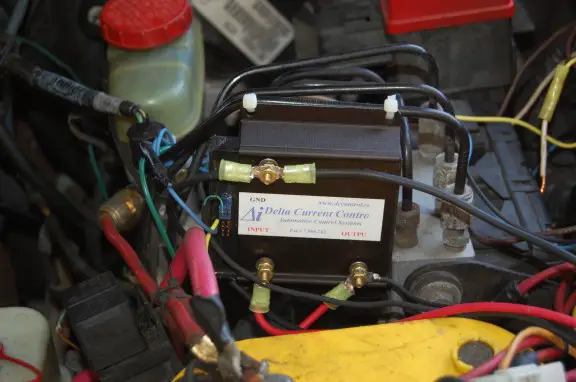

The most difficult part of the installation was finding a suitable location to mount the 3 3/8 x 4 ½” controller. I mounted mine to the tubing on the antilock brake Hydraulic Control Assembly as shown in the photo.

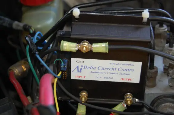

Then, using the supplied wiring, I attached the end of the red wire with the ring connector to the output terminal of the controller using the supplied star washer and brass 6-32 hex nut and the other end of the wire to the wire from the positive fan terminal.
After that, I placed the end of the other red wire with the ring connector on the input terminal of the controller and secured it with another supplied star washer and nut and then attached the other end of the fusible link which was in turn secured to the positive battery terminal.
Next I attached the end of the black wire with the ring connector to the GND terminal of the controller and this other end of the wire was attached to the wire from negative fan terminal. Then the end of the remaining black wire with the ring connector was attached to the GND terminal of the controller and both wires were secured with a star washer and nut. The other end of this wire was then attached to the negative battery terminal.
The next step was to attach the temperature probe to the radiator ( by inserting into the fins on the motor side of the radiator ) and plug the temperature sensor wire connector into pins 1 and 2 on the controller.
In light of the fact that I wanted continued cooling ( for several minutes ) after the engine was turned off, I connected the yellow ignition input wire of the harness to the unit and to an always hot 12 V source. Nevertheless, if one desires an immediate fan turn off, connect the yellow ignition input wire from the controller to an ignition switched 12 V source.
The blue AC input wire from the controller was connected to the positive wire of the AC clutch. This turns the fan on ( 50% level ) when the truck starts.

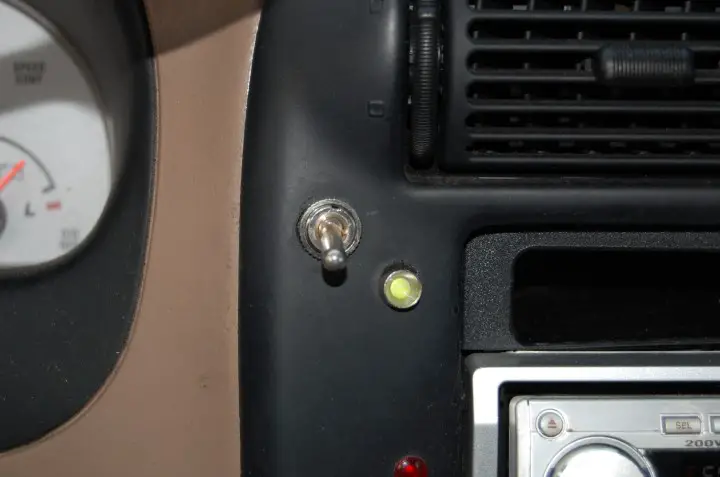

The indicator light ( L-101 ) was mounted in a 5/16 inch hole drilled in the radio bezel of my truck in clear view of the driver and wired by running the three wire bundle through the firewall and hooking up the black wire to the controller output terminal and the blue wire to ground and the yellow wire to a fused 12 V ignition switched source.

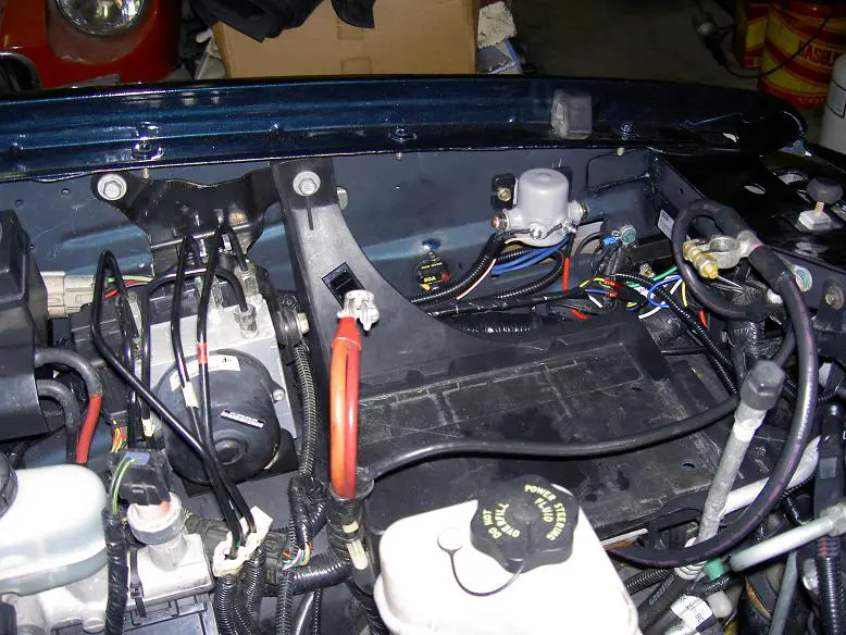

Excellent detailed review Al. Post a picture of where you mounted it if you would. Do you have other items in front of your battery, I wanted my added features hidden as much as possible? I installed my DCC fan controller and front strobe controller in front of my battery.
BTW, my fan was a little slow to come as well, but I wasn't in a hurry so I didn't notice as much.
Everyone should also know that the tiny terminal studs in the unit are extremely fragile. They are so small that the torque of a hand driver can easily twist them off. Thus barely tweak them by hand very gently. I installed my ground wire last and did twist that stud off at the halfway point. I removed the inner nut and installed the wire gently with that.
Those jumper pins/connectors are just like PC jumpers, very tiny and the pins are fragile.
I originally had the blue wire connected to my compressor. That compressor wire was not easy to find. If anyone had not noticed, the AC compressor runs intermittantly in all positions except vent. I don't want my fan to run at all u nless necessary, and as efficient as the radiator is, I unplugged the blue AC wire.
My thermostat seems to be opening earlier than the 197 rating as my temps hover right at 190 degrees. My fan setting of 194 is rarely turning on the fan, I like it this way. Regards,

Excellent detailed review Al. Post a picture of where you mounted it if you would. ,
Mine is mounted as shown in the picture.

That's a good serviceable location. Take a razor blade and trim the tops of those zip tie ends, they can scratch easily like they are. Regards,
These pics were taken prior to cleaning up the wiring and enclosing in split loom.

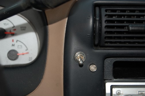

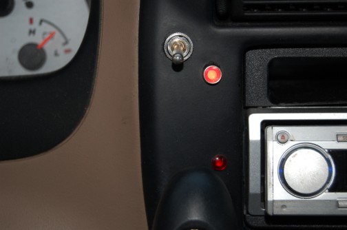

The pics show the progression from (1) ignition off (2) truck running with fan not turned on [green] (3) truck running with fan on low draw [pink] and (4) truck running with fan on high speed [red].

I still have no AC nor cooling issues with my e fan and controller set up. Still, I wanted to optimize AC operation and decided to hook up the underdrive jumper.
A jumper was installed between terminals 13 and 14. This jumper allows 10% minimal current to the fan to aid in convection flow. If the AC is switched on, the current to the fan is 100%.
Funny thing about the jumper; I lost the one supplied with the controller, therefore, I contacted Brian Baskin at DC Controls ( http://www.dccontrol.com/index.htm ) and asked how to order a replacement. He told me to just go to Radio Shack and get part number 276-1512 ( you get 10 for $0.99 [ http://www.radioshack.com/product/index.jsp?productId=2103807&cp ] ).
Further, the 12 v power source had to be changed from a constant source to a switched source. The constant source had the fan powered up all the time.
The end result of this mod is a cooler, more consistent operating AC system.
