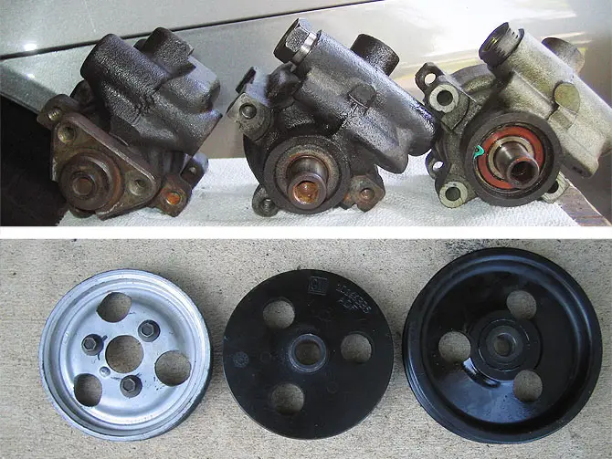

Well turns out that the Jeep Grand Cherokee pump can not be used for two reasons:
1) The SOHC pump has threaded tabs on its body which the mounting bolts then grip on. The Grand Cherokee's pump has tabs on its body but the holes are not threaded. And unfortunately you can't just tap these holes because in order to do so, you need to step up in bolt sizes and drill out the aluminum bracket that the pump bolts to (and there's no room to get a drill there).
2) The Lumina's pulley has a main shaft that is differnt diameter than the Jeep's. Sooo only the Jeep's pulley can be mounted on to the Jeep pump and only the Lumina's pulley can be mounted on the Lumina's pump.

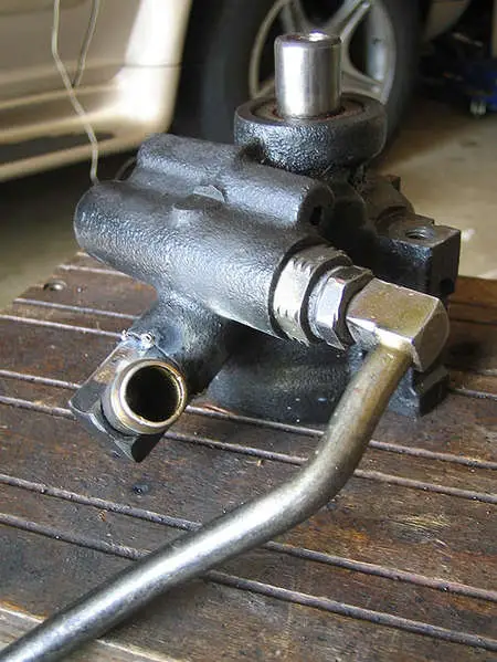

Soooo.. I moved all of the modified parts to the Lumina's pump.
Then tack welded the feed tube fitting onto the Lumina's pump:
Also had to shave/grind down the aluminum bracket under the pump so it would clear this feed fitting:

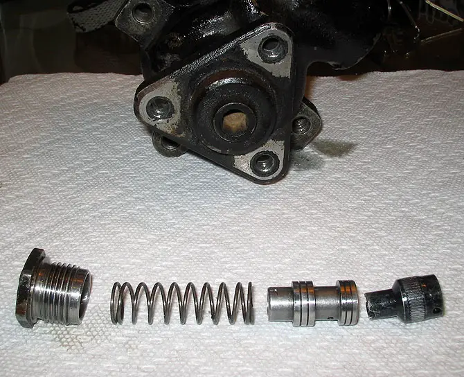

So if anyone is interested in seeing how our pump works, here you go:
(the centrifugal, as opposed to the centripetal, force keeps those vanes extended and the fluid fills between the vanes until its spun out to the high pressure side).
At first I realized that that I had left the high-pressure hose cap on. I use this cap to keep dirt from getting in the hose during installation. And as I just said, I left this cap on and never connected the pump to the rest of the system. Initially I thought, oh that must have been it! The pump built up too much pressure behind it and blew its back side off! But now that I think about it, I think it that my ignoraneous (yes thats a word) self forgot to shave the pin that the check ball-bearing sits on inside the flow piston. And even with the cap on, the pump should have gone to bypass so the pressure should not have built up high enough to cause the back to blow.
