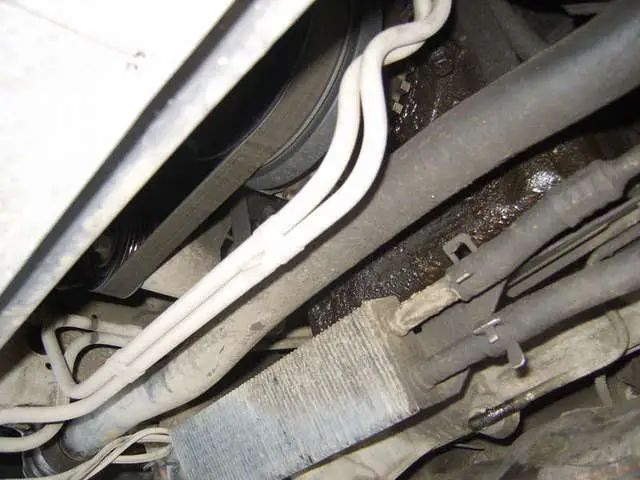

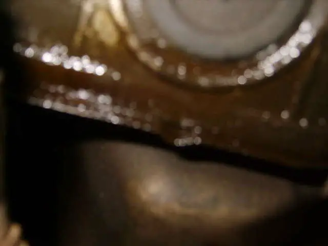

The oil leak looks like a rear main seal leak. Very common on high mileage 5.0L engines.
Problem is, I'm broke and I don't get paid until the 25th!... aah
Is that an actual leak? How do I fix it? I don't see any oil at all on the ground, here or at work where I park..
Could some high temp silicon fix this issue if it is a leak?
Those pictures are toward the front of the engine... uhm.. The first thing I'm going to do is get it changed and have them look at it.. any other information you might be able to give me?
Just keep adding to it until you get paid. Check it every day before you start it.
Rear main seal is a PITA, you've got to pull the trans, the flywheel, the oil pan, the main pulley, etc.
In the mean time, check that leak to see if it is indeed oil. That could be antifreeze that leaked from the lower intake gasket. I can't tell from the picture what color it is.
What do these pictures say to you?
Btw, I just got my oil changed... uhm.. they said they didn't find any leaks and the gauge issue is most likely caused because of the low oil....
As for all my oil disappearing, they said it's prolly getting burned or if I'm hard on the truck, it prolly is getting sucked through the PCV **** n getting burned..

Looks like its been leaking something for quite awhile. Not sure how they can claim there are no leaks. May not be pouring out or constantly dripping, but there is wet crap everywhere!
From those new pics, it looks like the front cover or oil pan gasket leaking. Or you were really sloppy when filling the oil. :D The stuff on the steering lines looks like it dripped from above. Still can't tell what type of fluid though. Dab a white paper towel on the wet stuff and show what color it is. Just try not to pick up too much of the dirt and grime.
Then get some engine degreaser and a wire brush and clean the engine really well. Takes alot of effort, not so much $$. You'll get a much better idea where any new fluid is coming from after its clean.
