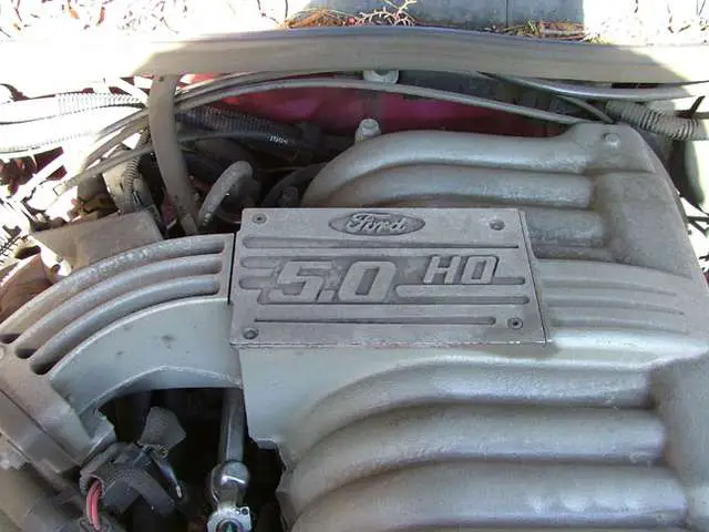

We bought our 93 T-bird just for a engine swap...that is still running great and passes smog for $300 bucks;)
Thanks guys, that is what the tech said too. Looks like a Stanger or t-bird then and not the E or F the intake is pointing the wrong way.....
or a lincoln mkvII?
