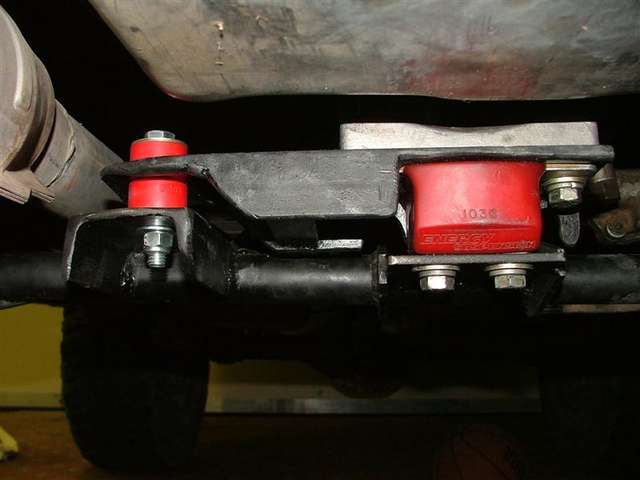

Okay, I got a 'Perma-Coil" kit in the right thread pattern. It wasn't that hard, only had problems with tapping one hole. The tap kept trying to go in crooked. I was more patient than the tap, so I won. I called the company because the coil inserts were too short. Turns out, you can stack them, and cut them down to fit. So, now I have well over an inch of stainless steel threads in the transmission housing. I fabbed up a "torque arm" today, which came out pretty good, if I say so myself. Got the adapter and the transfer case in, then had to go to the ranch and to a party this evening so I am finished for the day. I cranked those housing bolts down real tight, much more than the recommended 25 foot pounds, with a good slathering of blue lock tight to set the housing to the insert to the bolt. Did not want to use the red stuff in case I ever needed to get the inserts out, and the company did not recommend using it. Won't know if the transmission is okay until I get it filled up with fluid and tested in a day or two. Have to wait 24 hours for the sealant to set anyway. I ended up using the Permatex "Ultra Black" at the advice of a transmission guy and a few mechanic friends.
Found out the cross member that was done by my friend Jay Miller is 3/16" thick 1-1/2" tubing. I guess I don't have to worry about that twisting or bending.

A few pictures of the "torque arm" I created.
Thats beef Mr. Kennedy!!
Watching you guys over the years breaking some heavy duty stuff on the trail has made me into overkill. You even got me thinking a Dana 44 won't be strong enough when I haven't ever broken my ARB'd TTB Dana 35.
