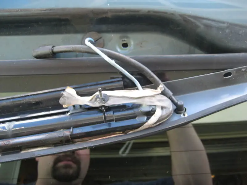

You also need to remove the 2 bolts on each side of the door. These hold the ends of the black trim the light is mounted in on each side of the hatch
Once you get the trim piece off, disconnect the washer fluid hose, and pull the white and blue wires and their grommets out.
- Nice goatee.. anyway...
4 - Turn the trim piece over, you'll have to get the lens out by prying on the side where the rivets were.
There is a metal bracket holding it in on the other side that has small melted tabs holding the lens in. I cracked these off and it all came apart.
From the outside you're left with this

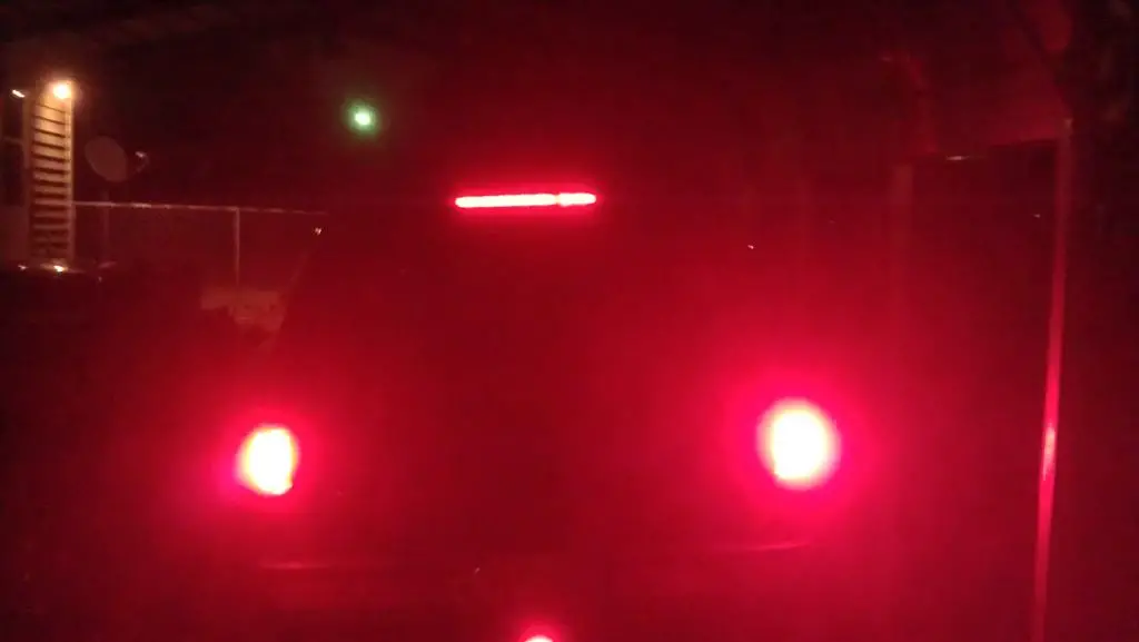

11 - Finally, wait until dark, get your wife to sit in the truck and hold on the brake while you sit back and have a beer :chug: or two :chug: :chug: and admire your work.
