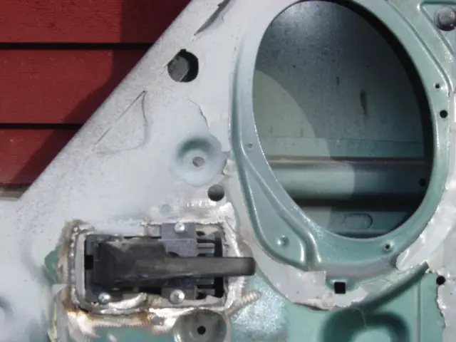

Doors are now at the boat canvas/window guy, who has some cool ideas for the vinyl windows ... and the inner door skins; had to move the interior door latches forward based on the cut-out...

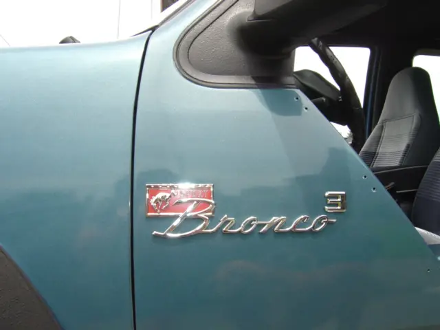

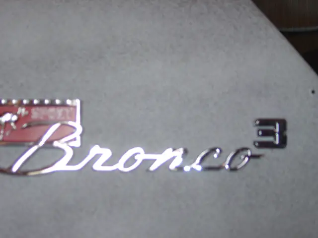

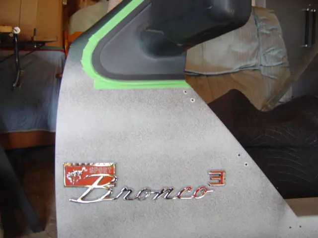

Okay, so not the traditional Bronco . . . but Hey, it's a two door and has been referred to as a "Bronco" more times than I can remember. . . so as I added the safari doors thought I'd throw in some "bling" Yeah, so I don't use the term "bling" too much either...
So, got a bit more work done; painted the door jambs a close enough color to match the rest of the rig, drilled holes for the B3 emblems, just need to paint the side view mirrors before sending it all off to Maaco...

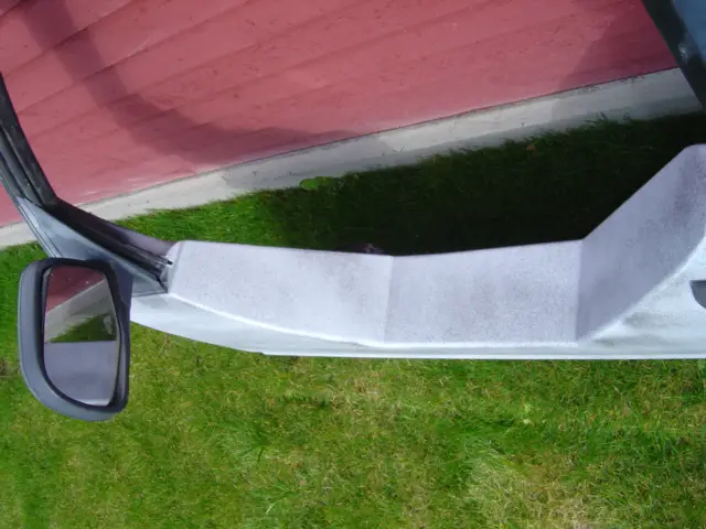

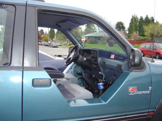

Finally something worth posting. . . Have been some issues getting the "windows" done, but need it to be more Spring-like around here, so I hung the doors with the hopes it would improve the weather - - tomorrow's forecast: Rain:wtf:
Here's the pics:
