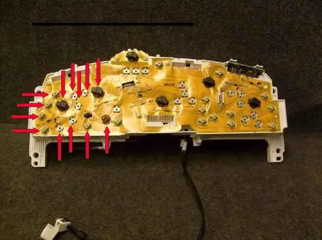

Almost at exactly 150,000k, my odometer and trip counter stopped working.
I could hear a clicking noise in the dash.
Did some research on the board, and it turns out the worm gears tend to break.
Its near impossible to find just the gear, and when you do can be more than $40!
And I didn't want a new cluster because I wanted to retain as close to my original mileage as possible.
So while going through the junk yard a few weeks ago, I found a cluster that someone had removed already. I pulled the center section with the speedo in it and got it for $6.00
When I got home I took it apart and could see the worm gear was intact.
I removed my cluster (it wasnt hard)
On the kitchen table...here is what I did.
1 - I took the lens off and removed the gauges on the right (oil pressure and voltage).
This section will just pull straight out with no screws once the lens is removed.
Now you should be able to see the in though the side and check out the worm gear. Its probably broken.
2 - I removed the odometer motor from the junk yard unit
On each side of the motor here you can see the clear plastic clip that holds it in. The motor has tabs on it that when you twist it, go under the plastic tabs. So to get the motor out, you have to push down on it and twist to get it out.
3 - Now comes the more difficult part.
Turn your original cluster over and you'll see its covered in a circuit board.
the bulbs have to come out to be able to lift the circuit board.
I didn't want to take it all off, so I removed the following pieces only and was able to gently fold back the flexible board to see the back of the odometer.
Bulbs just twist out.
The hardest pieces to get out were the connections to which the oil pressure and voltage gauges push into. But they are just springy, using needle nose pliers I was able to squeeze them on the front and pull them out of the back, then the circuit board could be lifted.
4 - Once the circuit board is lifted and gently folded back you should be able to see the existing motor through a round hole.
From the front side, disconnect the wiring of the motor.
now on the back side, push and twist to unlock the existing motor. It should come out. Turn the unit over and the remnants of the worm gear will fall out.
Once you get it out, you have this
6 - Reverse the procedure to put the new motor with good worm gear back in. it took me some time to get it to go in with the gear lined up enough so that I could lock it in place.
7 - On the front connect the wiring for the motor
8 - re-install the bulbs, push in and twist.
also the gauge connections, they just push straight in.
9 - push the oil pressure and voltage gauge set back into the front.
10 - assemble the lens and gauges and re-install in the truck.
Works perfectly!

Great rite up. while you are in there, replace the bulbs! This should be a sticky

Bulbs... good point... after I put everything back together, the top center bulb is not working in my speedo...

I did a little search on the internet and came across this thread while looking for worm gears for my explorer speedo. I bought an entire cluster from a LKQ U-pull it junkyard today to fix mine that was not working. I installled the replacement used cluster and low and behold the odometer was not working. So, I took my old unit apart to figure it out. I made a mistake of pulling the needle off the speed in order to remove the speedo body from the plastic bezel. I found the broken gear inside it and began searching for a replacement. My odometer stopped working a couple years ago, at 182,000 miles. Im certain it has 240,000 miles now so fixing my speedo does not matter as the miles will never be correct.
One upside was the speedo I had bounced badly between 0 and 30 MPH and this used unit is nice and smooth. I'd just like the odometer to work because I drive to directions off the odometer ( turn left and go 3 miles to main street and turn left).
I'm posting to give you a thanks for the motor part, but I'm gonna add the directions you have are kinda hard to understand. I removed the cluster and then removed the gold colored torx headed bolts from around the lense. Once the lense was off, I pulled the fuel/oil/coolant/charge gauge sections off by pulling the pins from the cluster. I then grabbed the speedo/RPM gauge section and pulled it off the cluster housing. I believe this is easier than pulling the bulbs and bending the printed circuit board over to gain access to the speedo/odometer gear motor. Also, I am pretty sure you can avoid removing the cluster from the dash for this repair. I think you *may* be able to remove the lense and then pull the gauge sections from the cluster housing while leaving the cluster in the dash. This would be easier for some people with automatics as the position indicator is slightly a butt-pain to remove along with the wires from behind the cluster.
Just a shame these worm gears are so expensive. The cheapest worm gear I have found online is around $25 shipped. In my opinion, that is a rip-off for a piece that could not cost more than a penny to cast.

Now that you mention you're probably right that you can probably pull the speedo from the front instead of removing bulbs and the circuit... that would be a whole lot easier

Followed all the directions and it works. Even got my gear part from the junkyard for free. Changed blubs also. Everything done for just the cost of some blubs.

Thanks for the pics and info. The bottom bulb on the gauge cluster just went out on me and I think I can switch it out now with this info.
