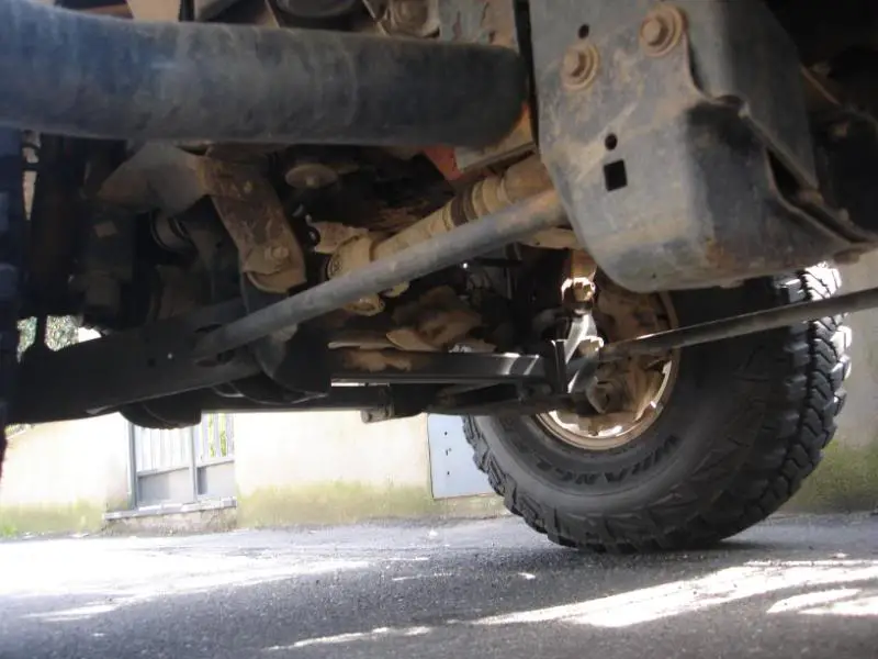

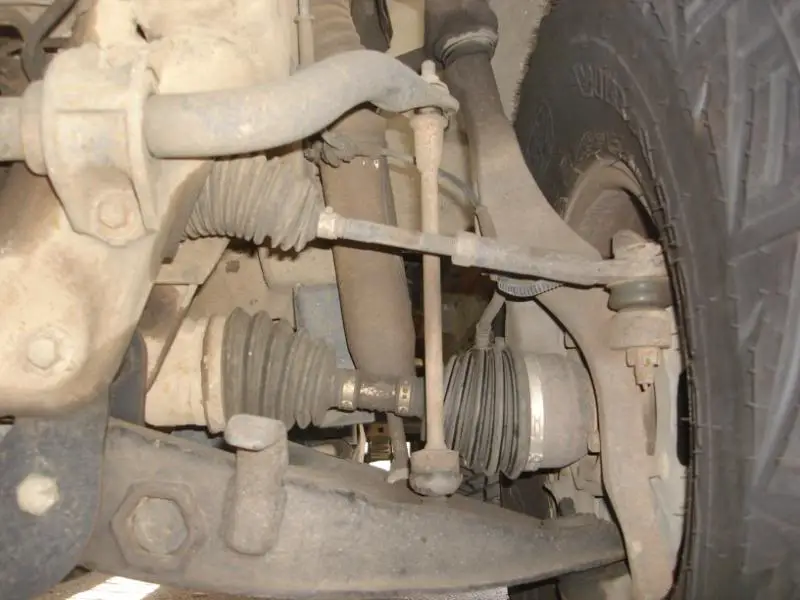

Heres a few photos I snapped real quick, she a little dirty...
As you can see here the connecting rod bushing at the top is completely gone and the one at the bottom is.... well, useless.
Heres some other shots underneath to see if any of you reconize the set up.
I can't tell... does that have spacers for the upper balljoint?
that's gotta be either a Superlift or Trailmaster 4" lift, along with a torsion twist.
those are definitely aftermarket front sway bar end links and will be longer than OEM.
Although the bushing from an OEM replacement kit would fit
I'll have to do some research into those kits. I ordered new oem bushings, with any luck they will go in without any problems.
you should be able to make your own links with some tubing that can fit a bushing on either end with a threaded rod going through then a bushing on the other side with a washer and nut
