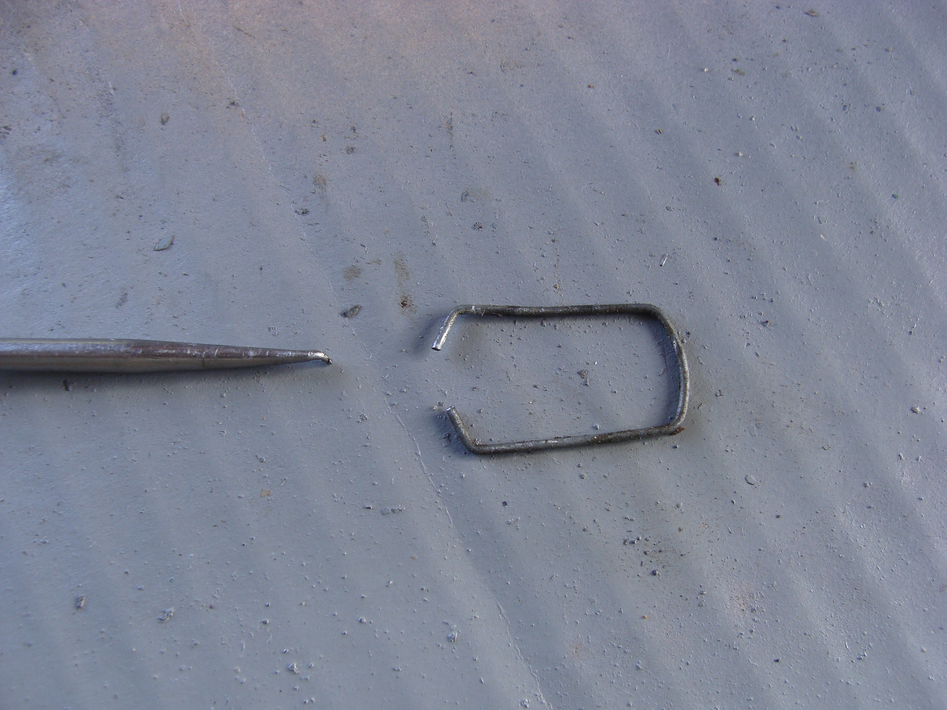

6. With the sensor removed it is now easier to see the small wire retainer that holds the plug in place and more importantly the direction the retainer needs to come out. I used a small straight pick to pry the retainer out of the groove. The new sensor comes with a new retainer so if you break it or bend it, that is fine. Once the retainer is out gently pull the plug straight out of the socket.
New sensor showing the wire retainer that must be removed:
Using the pick to pry the retainer out
The wire retainer removed:
