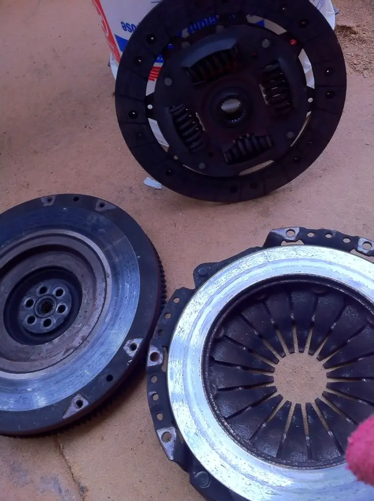

Started pricing/researching what would be needed for both, and my clutch starts slipping. Awesome! Get replacement prices for my clutch. A week later, no pressure and won't engage gears while I'm out one day. Awesome x2!!!

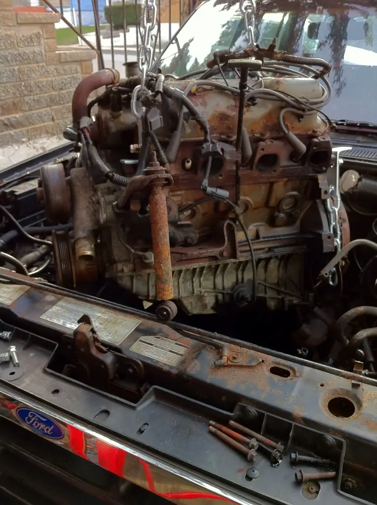

Take off all the belt driven accessories, air intake, fan, and radiator. Disconnect all, well most the wiring. Disconnect all the plumbing. Unbolt the trans. Unbolt the engine mounts.

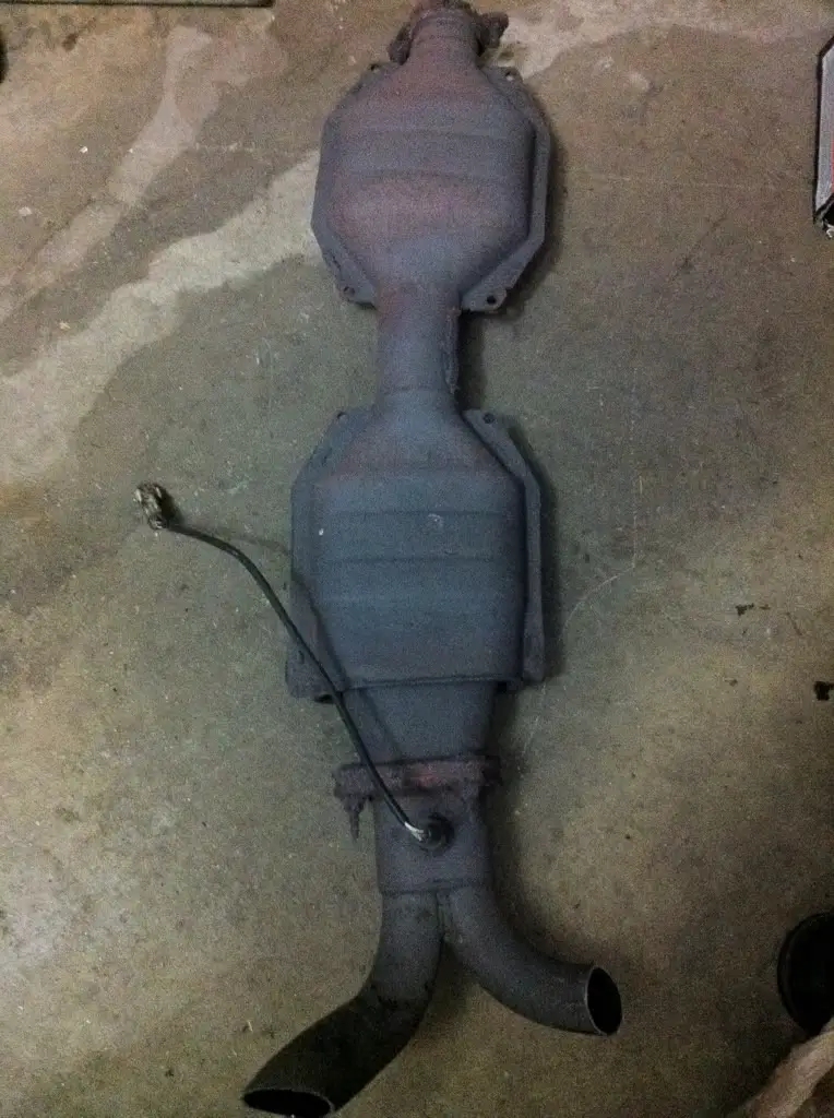

Got to the four bolts to the y-pipe. Wont budge. ANY OF 'EM!!!!!!! Torch and PB Blaster all of them. Repeatedly. Nothing. REPEATEDLY! So I say, 'why not take out the header bolts and stop stressing'. Torch and PB them ahead of time to save myself some disappointment. Get to the last one, lower bolt on cyl 3, with EVERYTHING in the way. Tried from the top and the wheel well. Wound up stripping the dumb thing! YAY! Go and get the Irwin bolt/nut extractor set. $YAY$!!! Get home, size it up, and the size I need is in the "expansion pack". $$YAY$$!!!!!!!!!! (Self hi-five for rushing and not paying attention!!!!) Get that, put it on, crank it, and it strips!! Awesomeness.

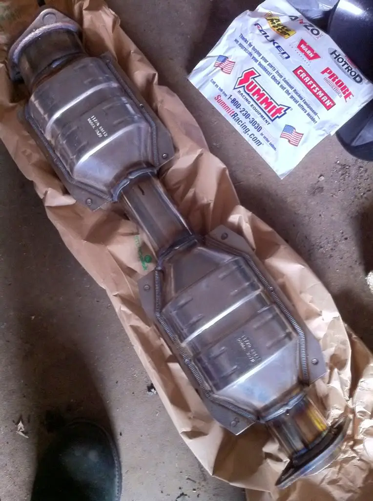

Stress and frustration set in and had a field day on my emotions. So I said 'F it' and took my sawzall to my y-pipe. So I had to order a new exhaust to the cat.

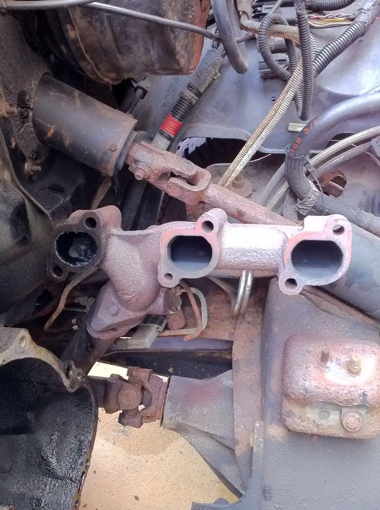

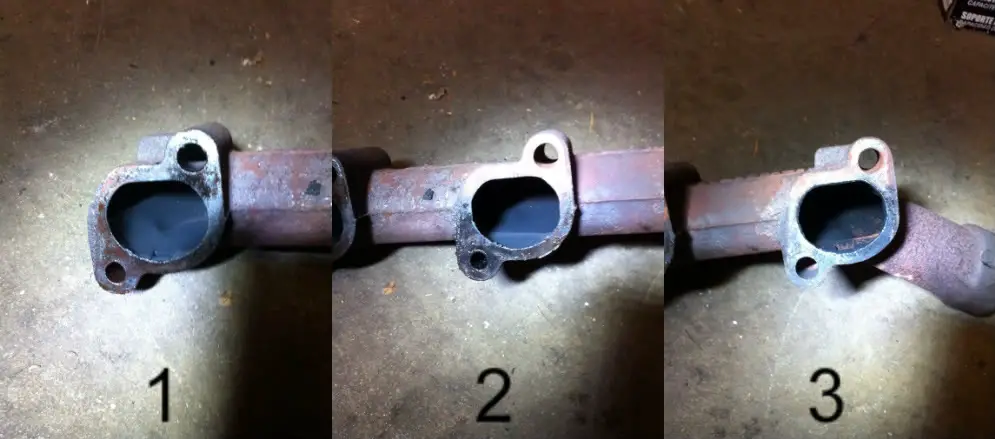

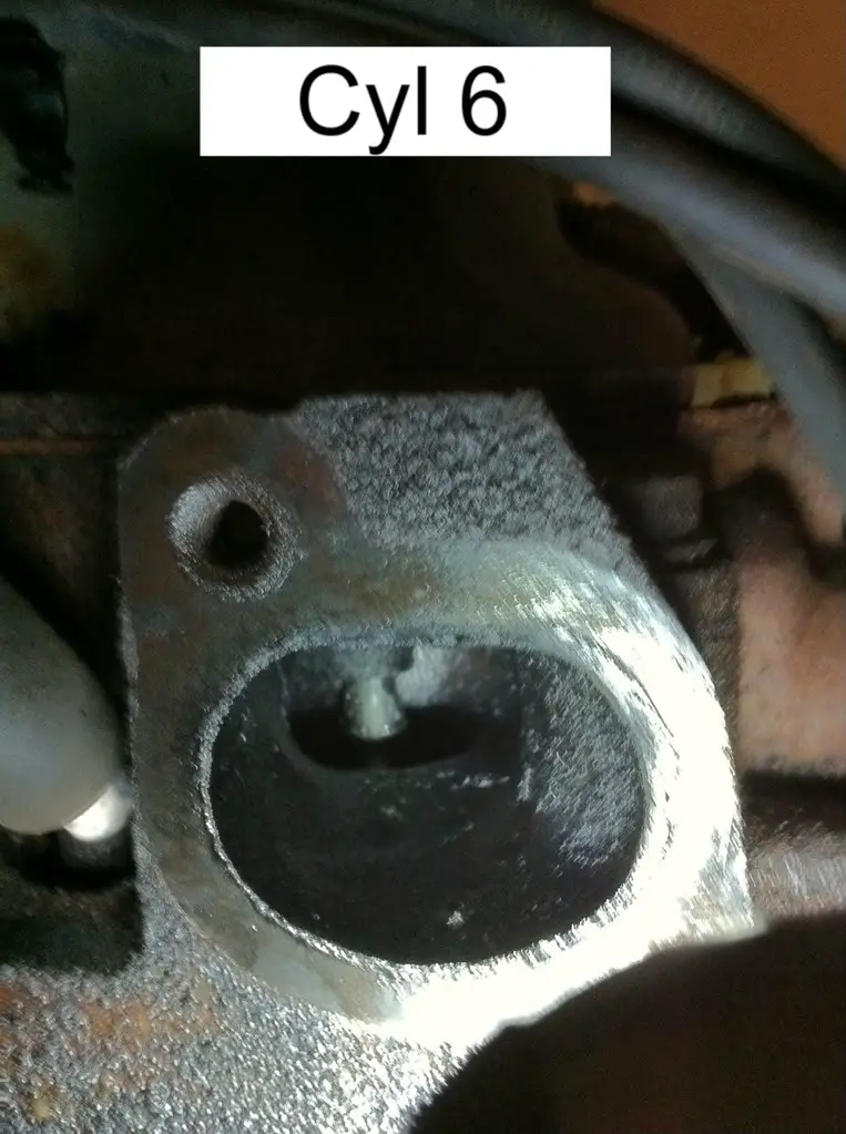

FINALLY pull my engine, and see a possible cause for my excessive smoking:

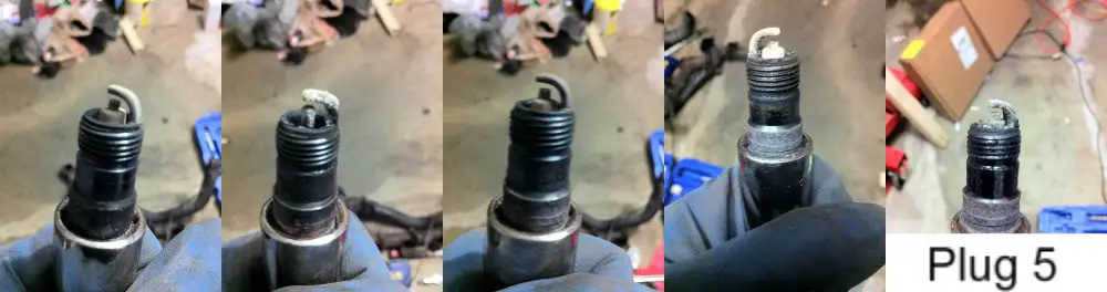

OIL AND GUNK---IN my 6th cylinder exhaust!!!!!!!!!!!!!!!!!!!!!!!!!!!

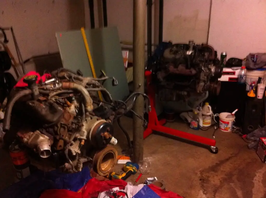

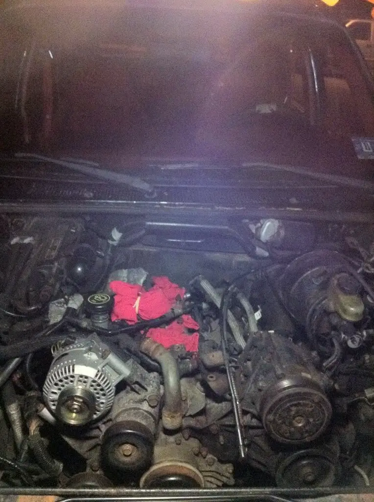

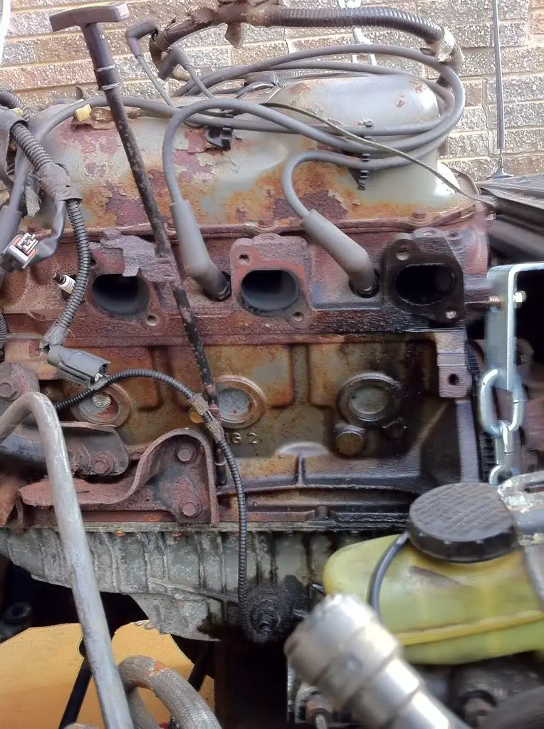

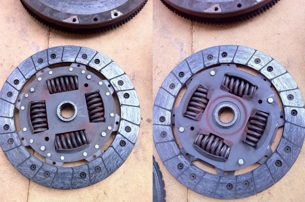

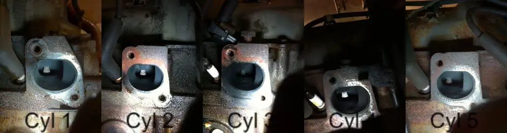

Thats the back story up to this point. Right now I'm in the middle of swapping the wiring harness to the engine I'm putting in my truck, while I'm waiting for my new y-pipe to get delivered. I'll let the rest of my pics speak for themselves.
Everything I removed to replace:

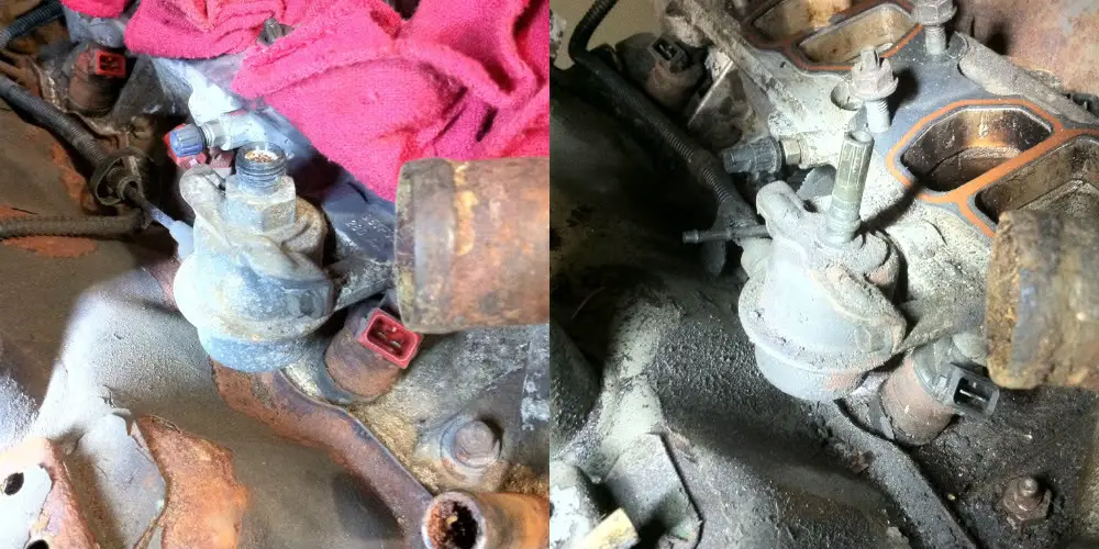

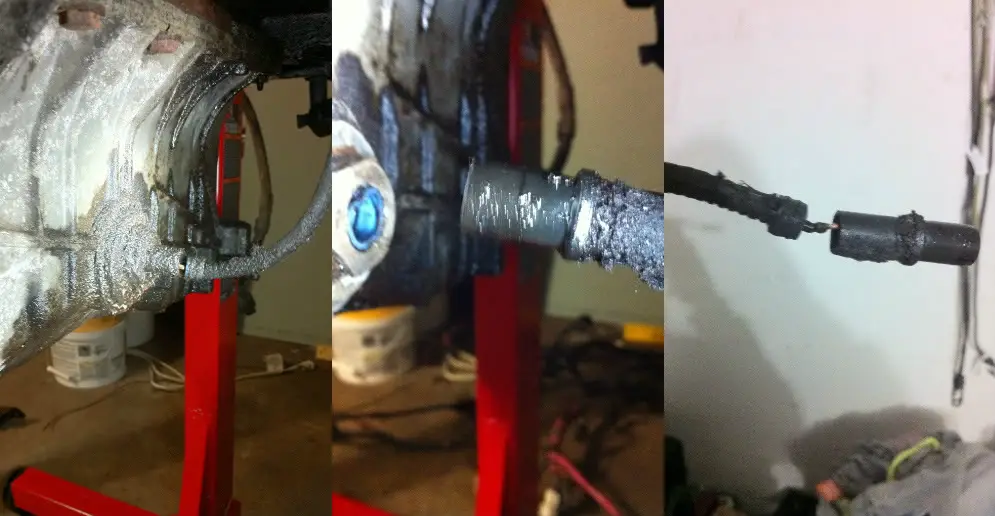

Pics of the removed engine's exhaust and plugs:
The transplant engine and the just removed is in the back.
