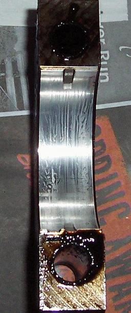

Here's what a main bearing looks like.

That sounds unreasonable to me unless someone just left them there after replacement. The bearings can spin on the journals but I doubt they can slip out.

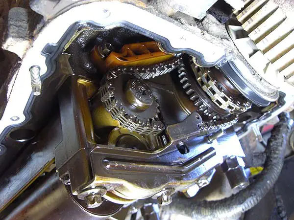

Well if it is the balance shaft's chain tensioner, then here is where it is located (the crankshaft pulley is on the upper-right corner of the pictures):
This is the tensioner with the plastic piece (which pushes against the chain) missing and the metal curved/arched spring (which rests behind the plastic piece) also missing:
Here is a new tensioner installed:
Wouldn't it rattle slightly, or make a bit of noise with it missing (assuming it is missing that is)?
Depends on what exactly is missing. If the guide is still there, then the guide will probably prevent the chain from "rattling" against the metal tensioner bracket.

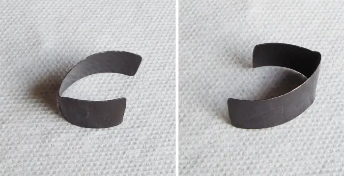

Okay, picture has been posted. The 2 metal strips along with 2 pennies.
Click to enlarge.
Yikes!!
Yikes!!
Looks to small for front main chain. Im thinking balance shaft.
Dale, can you compare that to your old main tensioner bits?
Im 99.9% sure thats balance shaft tensioner parts. :(
You may need to do some sonic checking to make sure thats just old stuff from sloppy work. You dont want to have that chain come apart.

Like I said, not sure when it did. Could have been earlier in it's life, could have happened recently. My Explorer has given me no headaches thus far.
Had it on recent road trips, and so far for the year and a half I've owned it, I have never noticed any weird sounds or ticks or anything. The engine is pretty quiet at idle actually.
balance shaft chain tensioner
Im 99.9% sure thats balance shaft tensioner parts. . . .
Bob
I won't have time to dig up my old primary tensioner until this evening but I agree with IZwack that it looks like the balance shaft chain tensioner. There are 3 leaf springs in the original primary chain tensioner and I believe only 2 in the balance shaft chain tensioner. Here's a photo of my old primary tensioner and guide.
