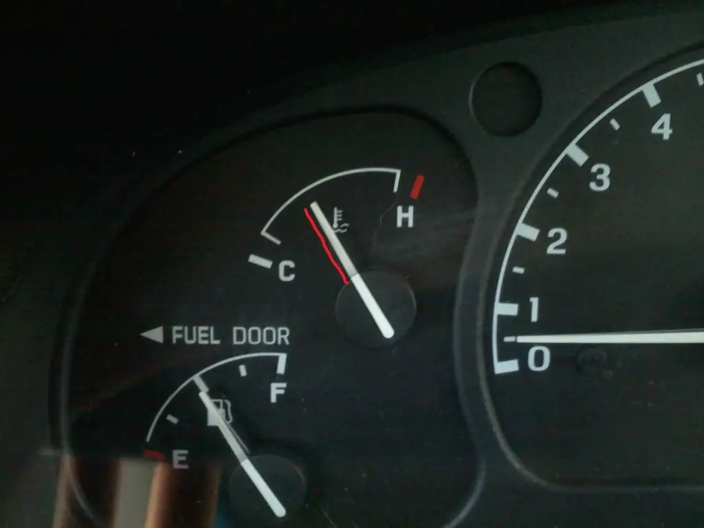

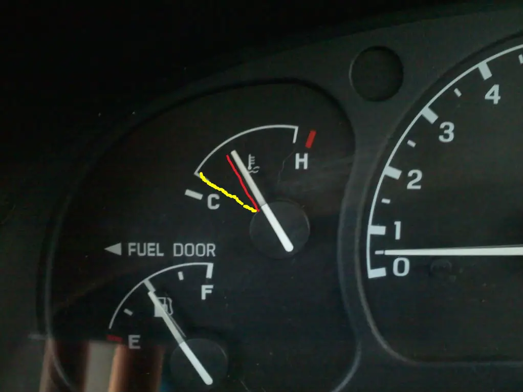

So i stopped at advance on the way home and was robbed for 18.99 for the 195 degree Stant thermostat. Why on earth is this thermostat 19 bux?! Anyway, it's in the truck now. I took a picture of the temp gauge with the new t-stat and at operating temperature. It definitly moved up some, but maybe im over analyzing it but it seems to me that it should still be a little "hotter" to be in the middle? The red line is about where it was before, with the 180 degree T-stat. How does this compare to your temp gauge? Am i worrying to much about this?

looks perfect where it is now .stop obsessing now..lol
