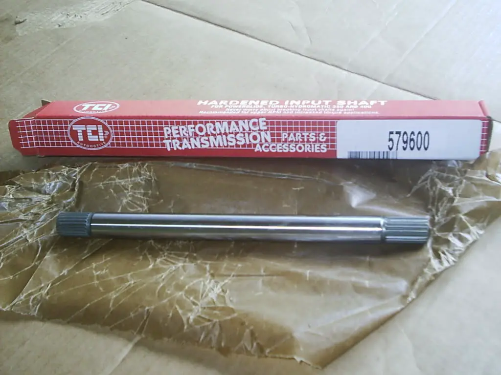

TCI High Preformance Input Shaft #579600
TCI® Hardened Input Shaft is constructed from hardened, aircraft quality Vaccu Melt 300 billet steel. Features increased lubrication flow and strength with a resized diameter that provides optimum stress distribution along the entire length of shaft and along the extended high gear splines to the oil ring.​
