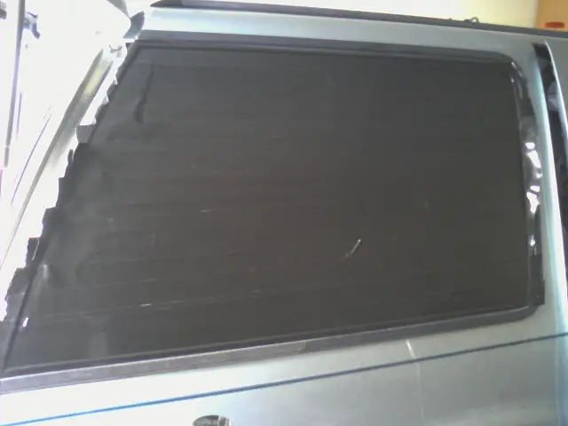

Somehow, my rear quarter glass shattered. No idea how. No indication it was shot.

Who need a replacement, when you have Gorilla Duct tape :D
Kidding... Gorilla Duct tape was applied to both sides to keep the glass together for removal. Worked perfect :thumbsup: Came out in one piece :thumbsup:
In retrospect, was the tape necessary? Did it flex much coming out or going back in?
Now that's what I consider "privacy glass"!
Yes. It shattered in pieces, and pieces were falling out. The Gorilla tape held it in one piece for removal. Way easier than dealing with pieces falling out, going everywhere, and having to clean up that mess.
No tape was used to install the used replacement glass.
