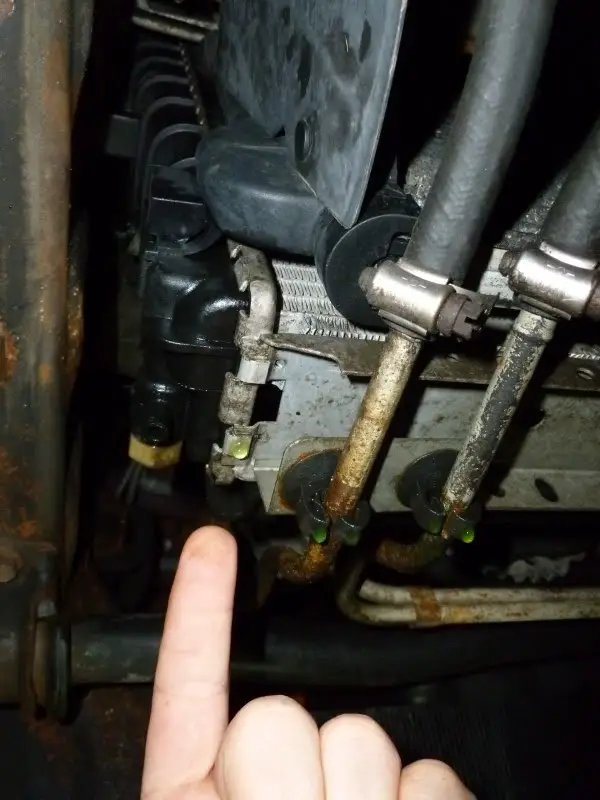

This is where mine was leaking, common- the seam between the aluminum radiator and the plastic tanks. It starts as a faint coolant smell once in a while, with no coolant showing up on the floor.
This is where it goes, and why it doesn't show up on the ground...

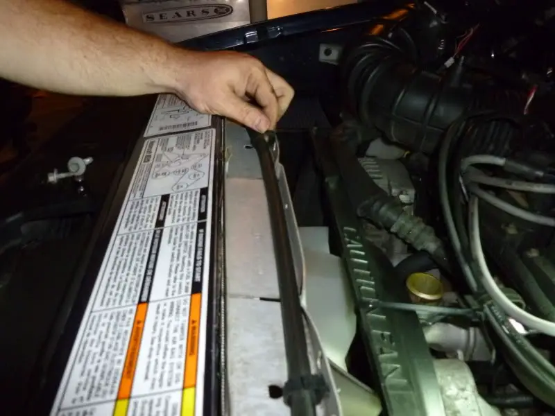

Start with removing your airbox cover and stash it up top out of the way. No need to remove it from the throttle body.

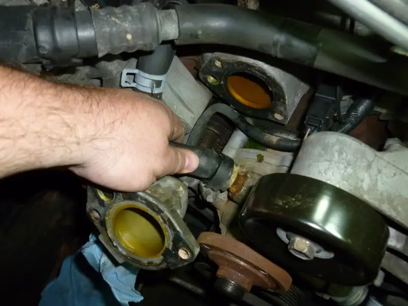

Do the same on the thermostat housing end. Twist the hose and remove from the vehicle.

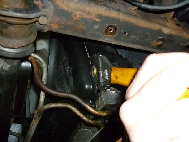

Remove the transmission cooler lines. 5/8" on the smaller one, I just used a crescent on the larger for stability.
Removed.

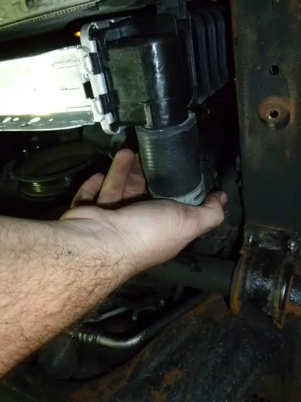

Remove the clamp on the lower rad hose. Leave the other end attached to the engine.

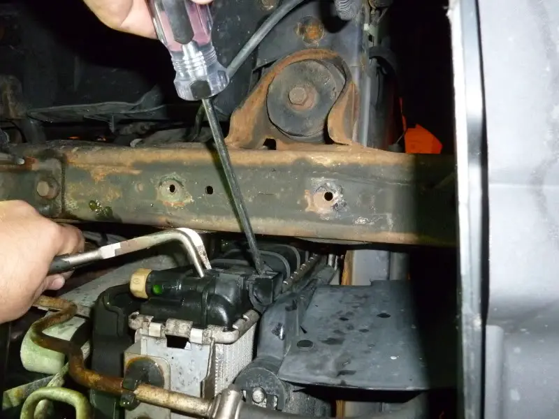

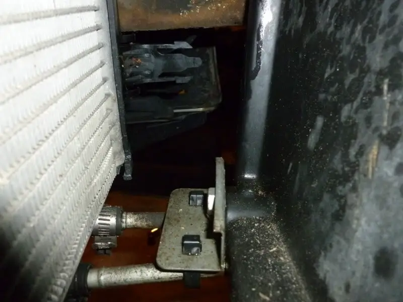

Now... The fun part- the infamous clips.
In all honesty, they're not bad- they really aren't. I think the job is way over-hyped. Anyhow, here is how you get the rad out.
Here is the fanny-pack clip.
Process- squeeze the clip together, and use a screwdriver to pry it out while holding the clip. Pry until it comes loose.
Remove the bolt holding the transmission cooler lines and actually their bracket to the radiator. 10mm.
You'll then have this.

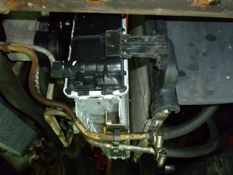

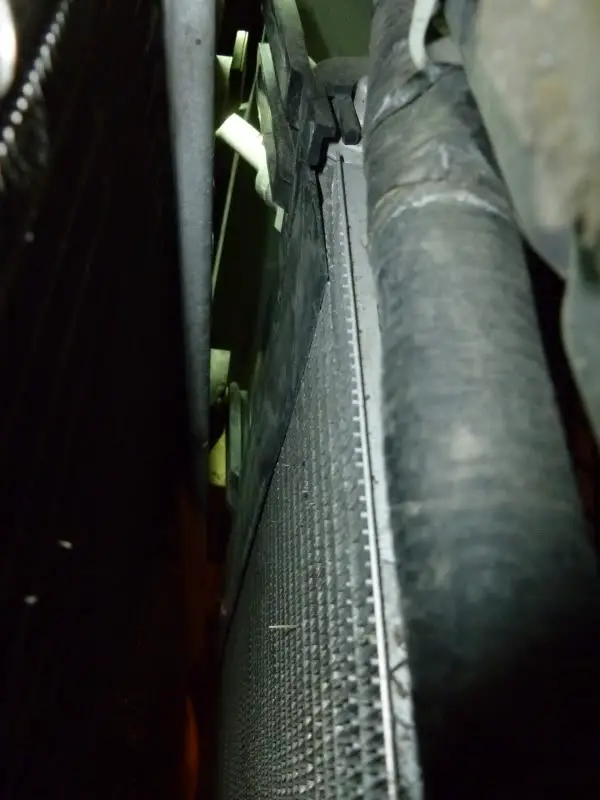

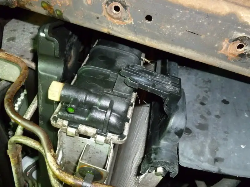

Now, let's go back up top to the slide locks.
If you look at this pic, you can see them.
If you look down, you can now see the clips. The radiator has the female portion of the slide lock, the condenser has the male portion.
Since the A/C condenser is loose as well as the radiator, you can now pull, push, and generally have fun getting the slide locks out. The condenser can be pulled as far to the passenger side as possible, and the rad slides to the Driver's side to remove.

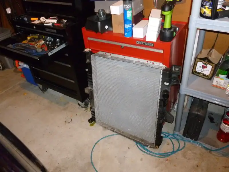

Success!
Here are some more pics of the condenser slide locks.
And the fanny pack clip.

Out with the old thermostat
Off with the hoses
The old thermostat

Lower hose on, reattach to the engine as well.

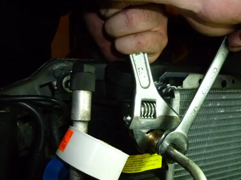

Reattach transmission cooler lines. USE TEFLON TAPE! Tighten them using a support wrench.

Reattach the bypass and inlet coolant hoses to the water pump.

Success!
