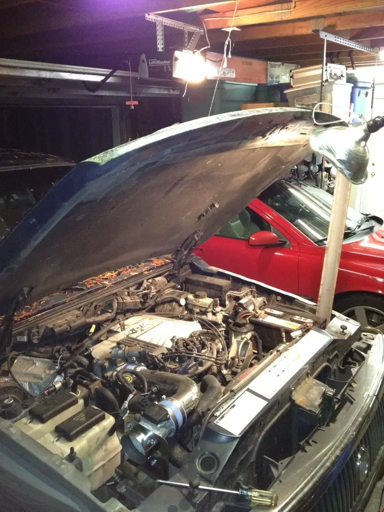

Here is the donor. 98' Mercury Mountaineer.

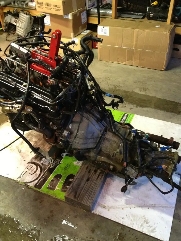

Pulling the 5.0 out of the Mounty now.....

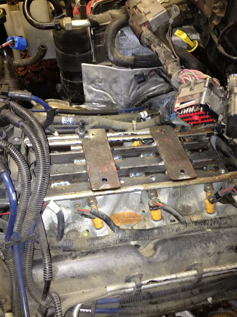

Built a bracket to bolt my 4 barrel engine lift bracket to the EFI lower manifold
Bolted the 4 barrel adjustable bracket to the EFI lower manifold. Most everything is unhooked and ready to pull tomorrow night.

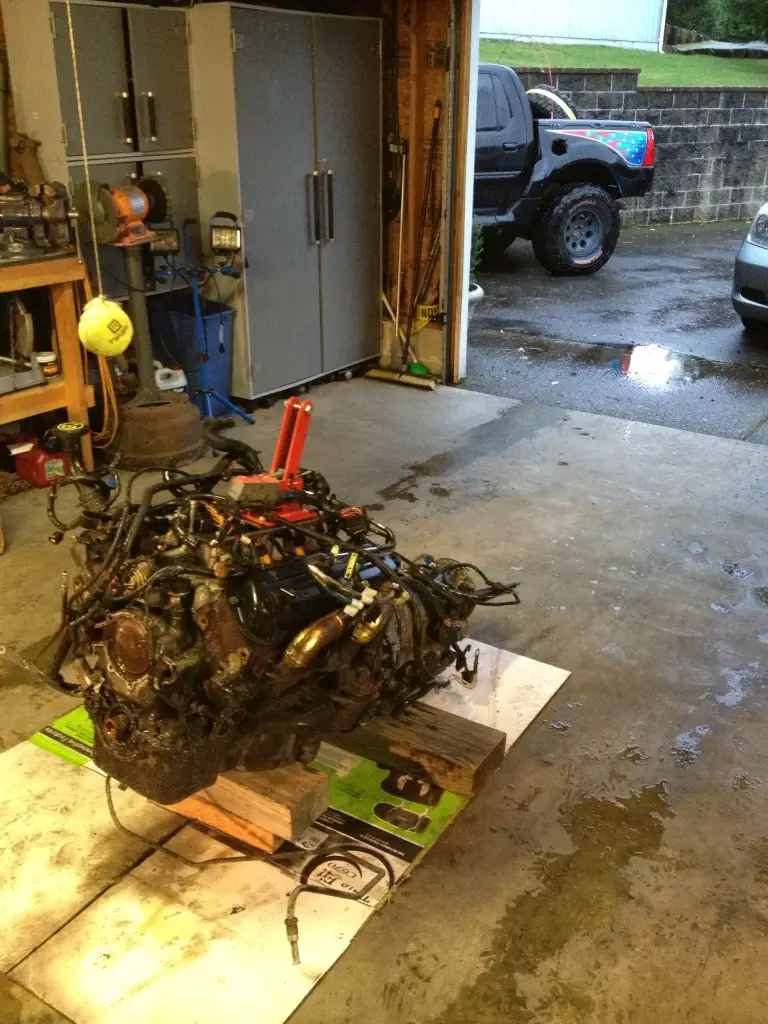

Block is at the machine shop and transmission is at the tranny shop.
