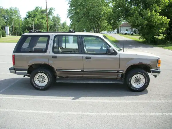

Well, I've been wanting to do this for a while, and finally got the chance to start this week. Last year I bought two explorers from a used car lot in Louisville, Ky. One is a 91 and the other is a 93. The 91 was rotted out so bad it was unsafe to drive and was trailered home and the other was cosmetically trashed by its previous owner and ran on 5 cylinders all the way back home (cracked head).
Between the two I have everything i need to build one good vehicle and have wanted to do this conversion ever since the movie came out. I was 11 and loved dinosaurs and explorers, still do I guess.
For those who want to follow along, this thread will be updated as I get the chance and as time and money allow. I am really going to push hard to get this thing done in time for my best friend's wedding in August of this year.
We'll see what happens I guess.

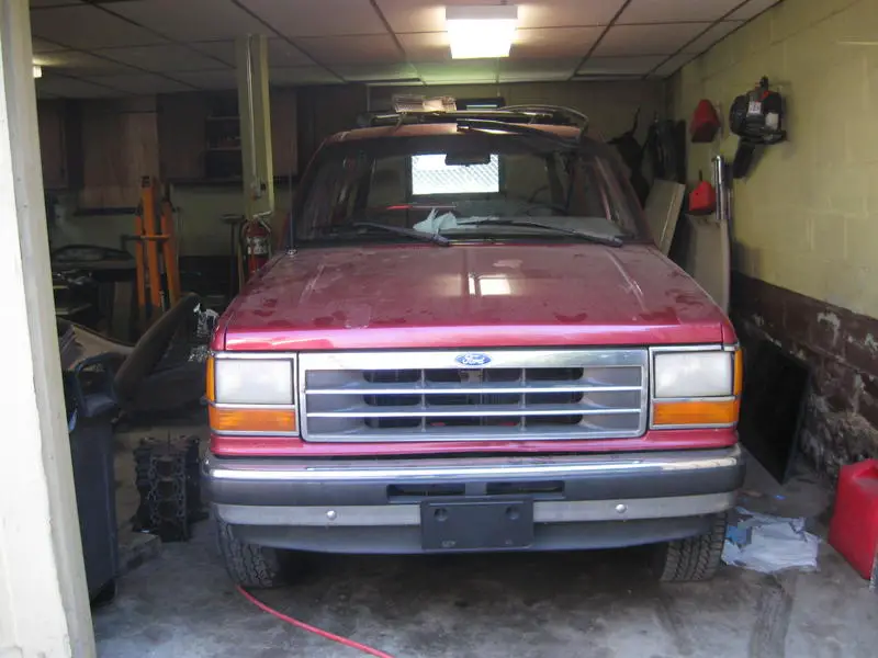

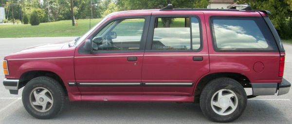

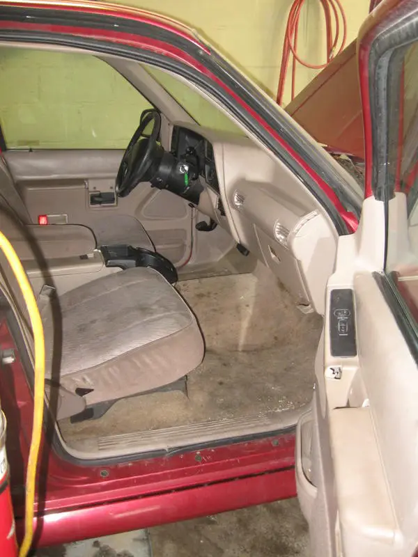

The red one is the 93 and the gold one is the 91. The 91 had the clear glass I needed, and correct running boards and a perfect interior. Only had about 90,000 miles.
The 93 is solid except for the normal rust spots, nothing a little welding won't fix. Both are 4x4 and the red one will be converted to 2x4, like the movie cars. I will be scratch building the brush gaurd and roof extension. A friend is working with a contact to help me make the clear roof, hopefully he'll come through for me. That will probably be the last thing done. My goal is to finish everything but the roof for august.
Enjoy, I know I will... This is my first complete auto restoration.

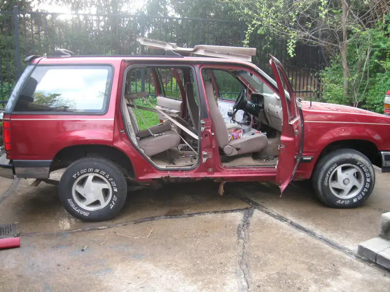

Part 1 Dissassembly
I was suprised to learn that sometime in this truck's life, it was wrecked down the passenger side.
Both doors had evidence of repair and they put a new quarter panel on that side. It was a genuine Ford part which leads me to believe it was a dealer fix and happened sometime early in this trucks life.
Who ever did the work, they did an exceptional job. I never noticed anything at all until I pulled the interior panels. I'm kind of detail oriented; as you may notice in the future of this project.
I'll shut up and show some pics.

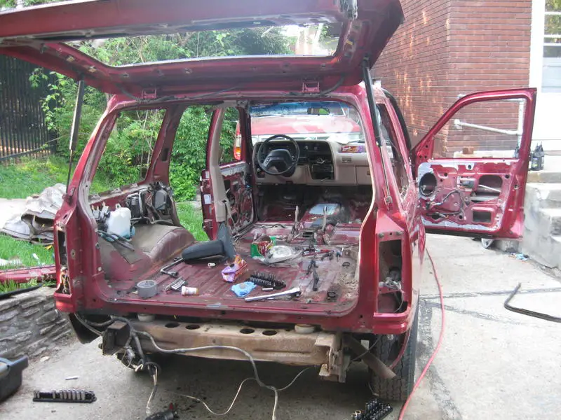

Some more disassembly:

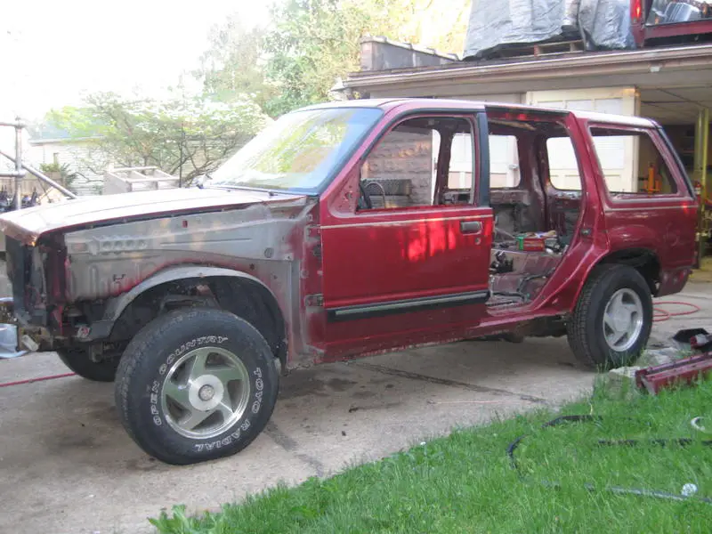

Got her down to a shell, gonna order some panels now. Needs both front fenders, stone deflector, both rocker panels and some misc body parts-headlights, weatherstrip and such.
Found out too, someone must have hit a deer. The bumper is not orginal to this truck and it also has a different grill. That explains the damaged stone deflector. I pulled the headlights and grill off only to find damaged mounting brackets and stuff. Nothing major but, this Explorer has had a rough life.
The last pic is how she sits tonight. I'll probably pull the dash and front doors next. Having them off will allow better access to remove the bad rockers. The previous owner even broke the dash board and i'm going to use to one from the 91.
I don't understand how people can destroy stuff so completely, but strong work for not being half a$$ed!

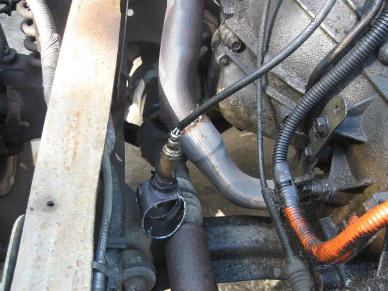

Shown is one of the great repairs that have been done recently (before me), and the reason for a persistent 'check engine' light.
Next step will be loading the chassis on the trailer and heading to the shop for a good cleaning.
