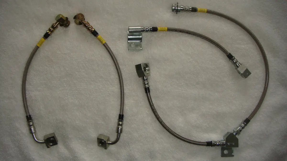

These seem to be the only pre made stainless brake lines available for the Gen 2 Explorer. Price and build quality appears comparable to custom made, and DOT approved. Anyone tried or found any benefit with SS? I've read conflicting reviews. TIA

30 months later I finally pulled the trigger. First impression is these stainless brake lines are very high quality. My mistake was ordering stock length hoses and not specifying being lowered 2.5" front and 3" rear. When lowered, the front wheels and calipers move up putting the banjo fittings at a different angles and binding the hoses at full steering lock. Rear drivers upper hose appears longer because the axle moves up with lowering blocks. DP replied and said the 90 degree banjo fittings are annealed and can be carefully straightened to my preferred 45 degrees, or I can get 2" longer hoses. After several bending attempts the hoses were still too short and binding at maximum turn causing stress on the banjo fittings. Had 2" longer hoses made with outer spring protectors in case the extra length hoses made contact with other parts. J.B. from Deerfield Precision said they were normally not needed but installed them for me anyway. Turns out he was correct and there is no contact in any steering position.
INSTALLED PICS. (Post #70)

You can get all four corners in rubber from Raybestos for ~$50 without shipping from Rockauto.com. I found a local shop that will fab some stainless braided for the same price as deerfield precision, so I'd rather support a local shop.
I'm definitely going with the stainless braided lines. The brakes will feel less spongy, and we have a lot of $hit on the roads in Calgary. Either option will outlast the trucks though. You'll have to decide for yourself if it's worth the extra ~70. You probably don't have to worry about salt and ice in hawaii, but with the extra heat there, you would notice the brakes were more solid with stainless.

i've used braided ss brake lines on my hot rods. they give a firmer pedal feel as they don't expand like a regular rubber line will.

Got my lines installed today. Picked it up from the mechanic. All they said was the old ones were "fun" to get off.
I haven't driven a lot yet, but I will say the pedal is a lot less "smushy". It feels nice and solid and doesn't take much movement for the brakes to do their job. Overall I like it so far.
