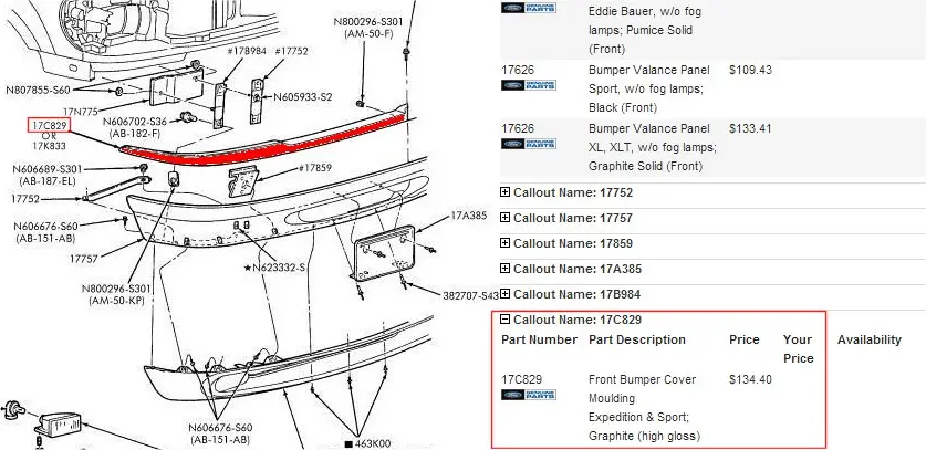

What the name of this part? Or the part number?
Is the part showed in the picture. Made out of fiberglass. Is the same color as the car.
I have tried to search several exploded view, but none been found so far. Any help will be greatly appreciated.
Also need one, if anyone has one up for sale. Let me know the price and shippingcharge for the part. I'm located in Puerto Rico, zip 00650.
not sure what that part is called. have you tried looking at the LMC catalog?
Part above bumper and below grill i belive is called a valance. Would try looking in nearest junk yard.
All of his arrows were pointing to this part, so my bad. I assumed the arrows all the way around it meant that particular piece and not the header panel behind it. Looks like he was pointing to this part.
He also said it was painted the same color as the X and made of fiberglass. So, I'm still going with the part I pictured.
the part you have shaded in red is made of plastic. a header is made of fiberglass
I still think he's referring to the piece between the bumper and grill. We'll just have to wait on him to respond to confirm which is which.
The way the parts diagram looks, and they he's describing and illustrating the part, it sure looks like the Front Bumper Cover Moulding to me.
