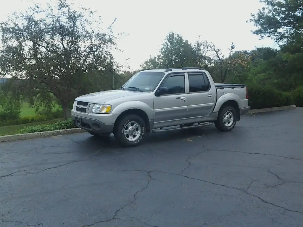

Well, Apparently I’ve caught something because I can’t stop buying Explorer’s now… Just picked up an ’03 Sport Trac with only 63K on it. Silver (did I mention I hate silver vehicles….) It’s very clean (not as clean as my green ’97) but clean for a northern vehicle. Apparently it’s from southern Jersey. It does however have a salvage title which doesn’t bother me. It got crinkled right below the passenger side rear door. New door and rocker chunk (common theme in my life) and it looks fine. I checked over the repair and he did a decent job. The rest of the body looks good too. Only minor surface rust underneath around the holes. I’ll touch up anything bad an oil the piss outta it and it’ll be fine for the next ten years! Any way, you guys don’t want to hear my life’s story so here ya go…
As you can see from the pictures, she’s a virgin…

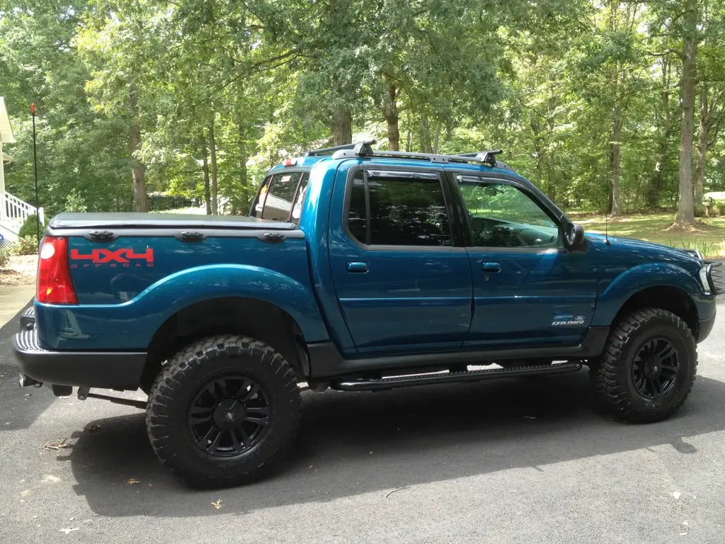

For the plastics, check out the pics in my normal registry linked in my signature. It should be on the 1st page. I used Krylon Fusion gloss black and love the way it turned out and how it holds up. Just remember prep is key!

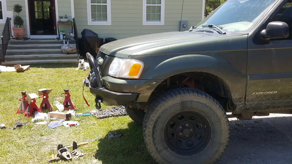

If you want a different bumper check out RLC bumpers and a couple threads down from this one in the ST forum has a couple guys that are running them right now.

I Absolutely need to have that RLC bumper! I like the second truck down with the hoop up over the winch. Definetly may do that. Not too keen on cutting up the front fascia but oh well.

The hoop was definitely worth it in my opinion. You can get it welded on or bolt on. Welded on makes shipping a good bit more expensive. Bolt on only cost another $75 when I bought it (not meant to be a quote for anyone else in the future). Great to work with and quickly built and shipped.

Offtrac – Any more pics of that front end? Maybe from the side diagonal shots? Got a link to your photos?
O1ST – I know you said you used the Fusion gloss black but it does look Matte-ish in the pics… Is that just how the pics look are is that the real deal. That is almost exactly the look I wanted. Any closeups? Also, what did you do to prep before painting? The plastic on mine looks good an dry and I want to paint it before I get the urge to spray it with tire foam. It does look like the previous owner wiped it down with something but I’ll clean that off with acetone or such…
This is all I have right now. Still need to get pictures with the RCI skid plate installed.

I did a decent amount of prep. I ended up taking all of my cladding off to paint so I didn't have to worry about it. I scrubbed it with Dawn soap and hot water and then pressure washed everything to make sure all the soap was gone. After it dried for a few hours in the sun I started spraying it. Lots of light coats is the way to do it so you don't get any runs and get even coverage.
I'll find some more pics and post them up. Most people do go with a matte or satin black. I can't think of anyone else that is running gloss.
Pics:
Most recent (1st wash in a year or so)
Day after it was painted. You can kind of see the gloss in the sun on the rockers but imo it works with the dark paint. Not sure if it would be any different on a silver truck but you can see what that would look like on "can't think of his name from Indiana."
