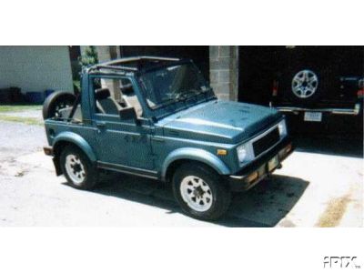

Well, I too have joined the dark side :D . I picked this up this afternoon.
Those oversized ATV's really do rip it up on the trail. I didn't see any in Colorado when I was there but I didn't hit the trails on the weekend either. There is a group about an hour and a half from me and these guys are crazy.
www.rpm4x4.com if you need an idea or 2
I saw a couple of zuki's in action and they do really well when they are built up right.
