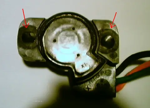

unplug the sensor, and remove it. you will see the two mounting holes that need to be elongated to allow the sensor to be rotated-

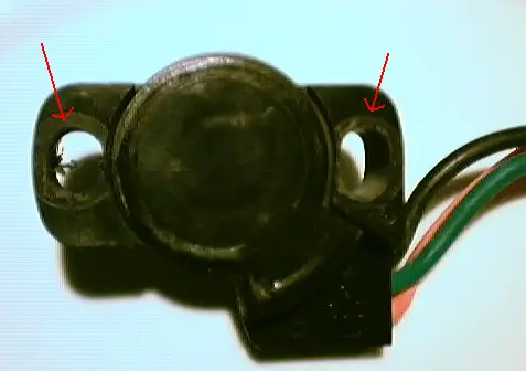

now, get a drill with the appropriate sized bit and "carve" on the holes in either direction to make them elongated. be careful, this is plastic and it is easy to remove alot of material rather quickly. take your time and GO SLOW.
when you are done, the holes should look like this. now, reinstall the sensor and plug it back in. you are now ready to adjust it.
