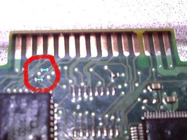

The problem was that the serivce port was dissabled. The solution is one of two options. First, you can send your eec to Apten and they will activate the port. This option leaves you without a ride for a few days. The second option is to do it yourself. This can be done my soldering two jumpers between two sets of pads. See the photo:

question to SGR1600, i have a 2000 Ford Explorer 5.0 and i think i may already have jumpers connecting those 2 points. here is a picture of my ECU:
so are they already connected or do i need to somehow bypass or remove those connectors? thanks.
Should I just call apten on Monday and find out what I should do?
