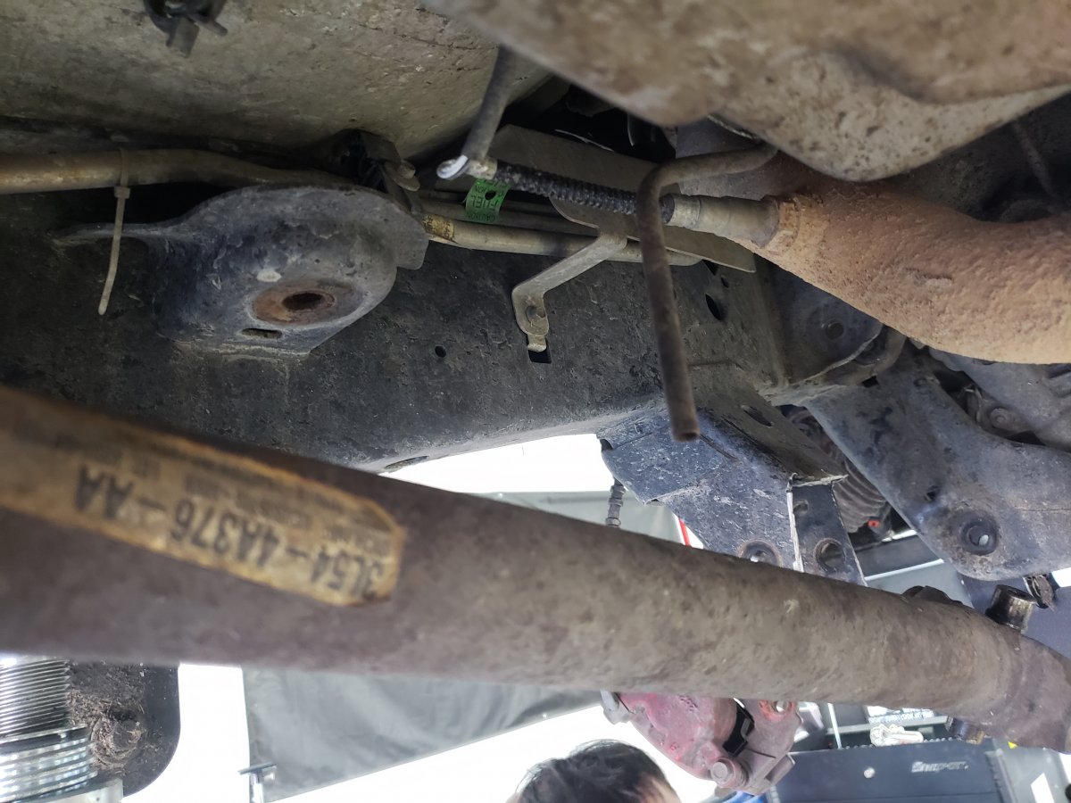

On a 2005 Sport Trac 4x4
No bueno.
There is a front diff support bracket moved back almost a foot.
Using factory arm (almost a foot longer), redrilling a 2.440" aluminum spacer to keep the angles, and use a 6" bolt.
Spindles.
Milkshaked CVs on one axleshaft.
I would go with a 3 or 3.5" spacer, but the bolt would need to be over 7" long.
