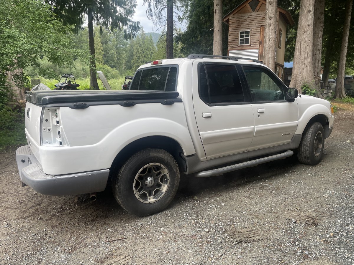

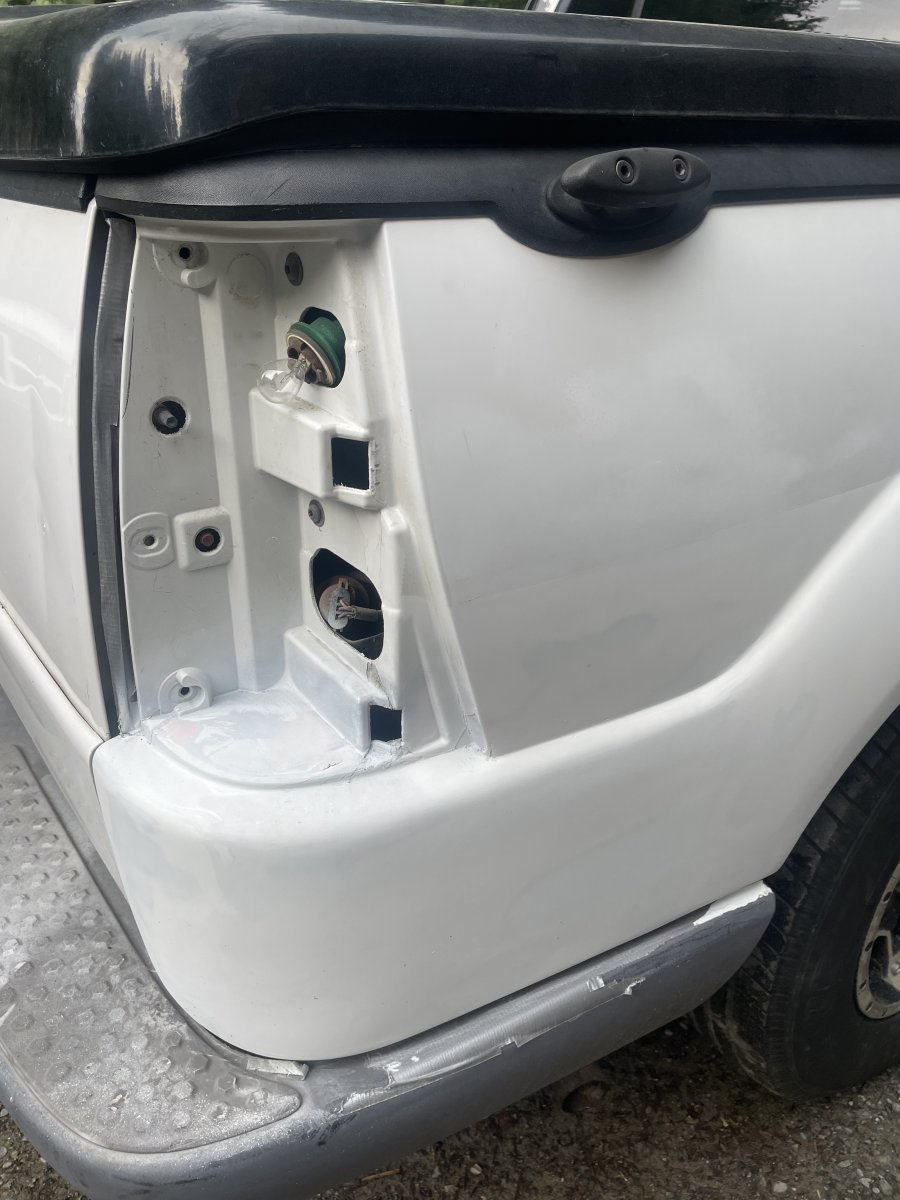

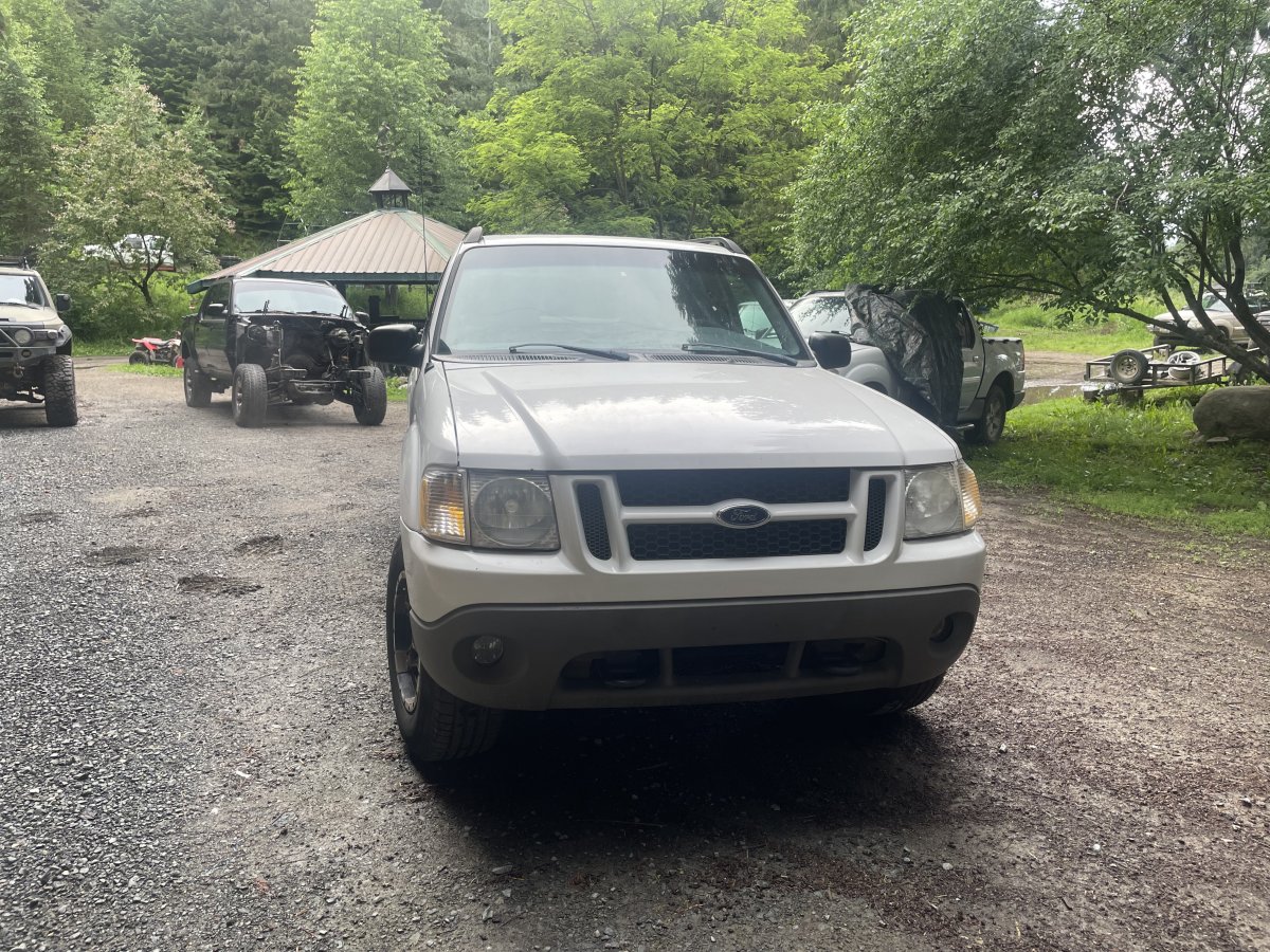

Bodywork completed, Al came out awesome! The white primer is a close match to body color
01 sohc truck back together and driving around under its own power all is well! I was able to get the door locks working again by being persistent with the pb blaster both of them were stuck… I was starting to wonder if I had the right key since I last touched this thing in 2018… the key fit the tailgate and it turned… now both door locks are working phew. One less thing to worry about.
Now I can bring the black truck in

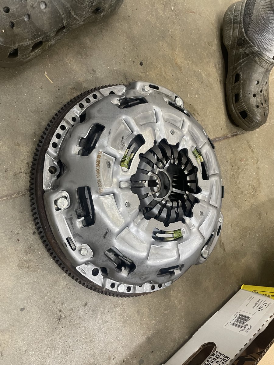

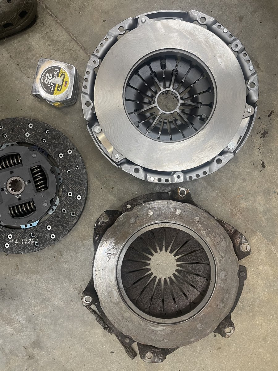

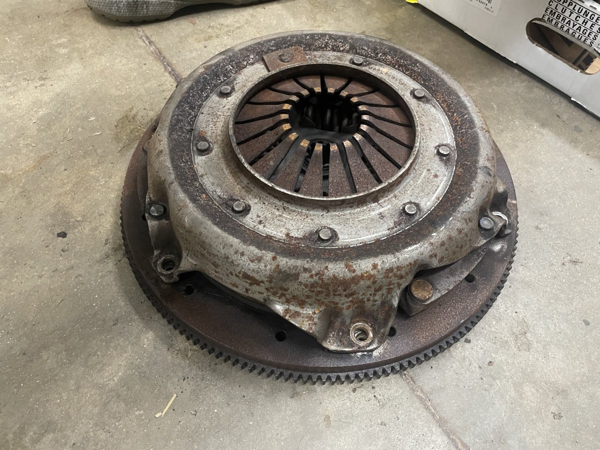

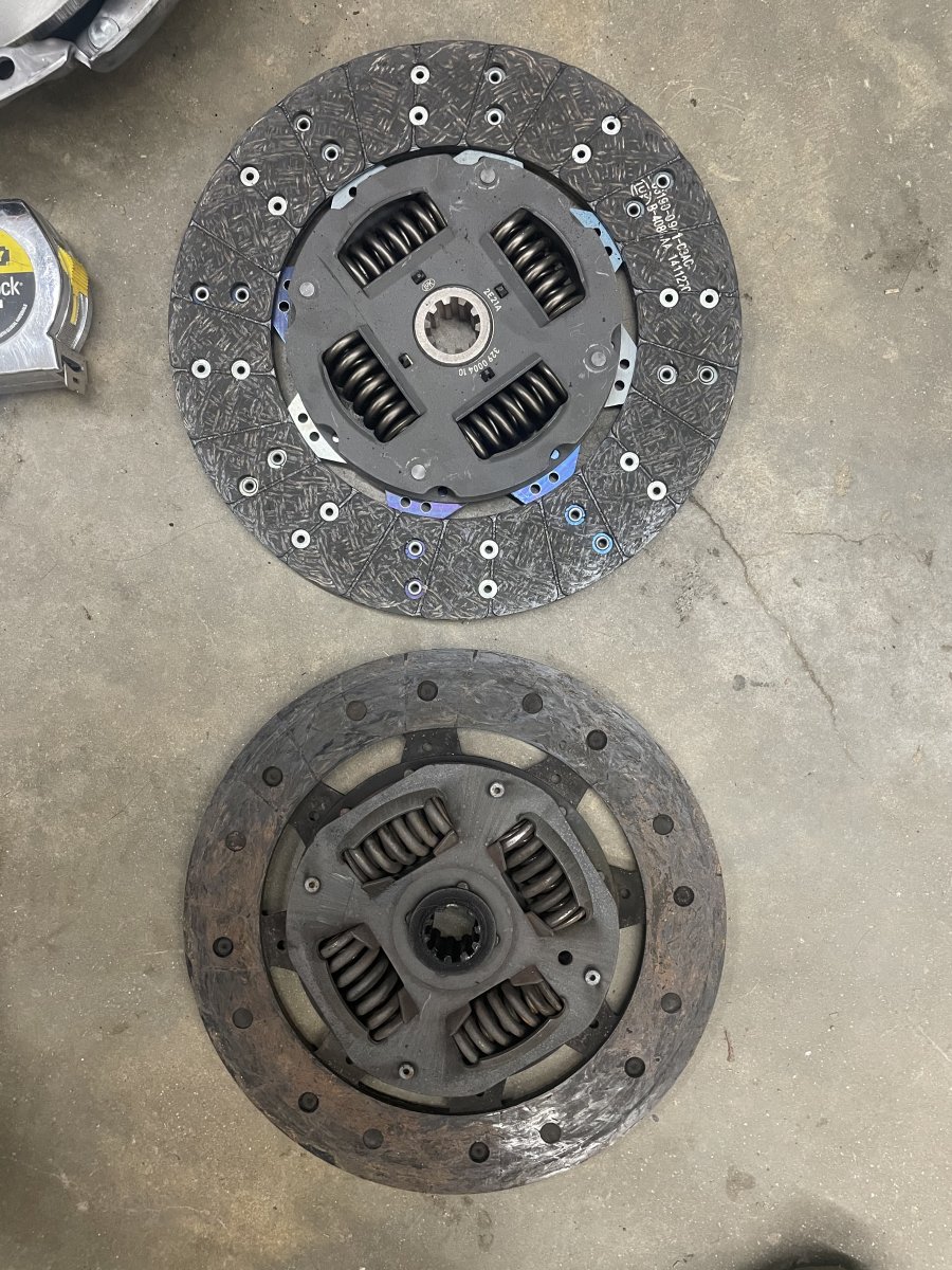

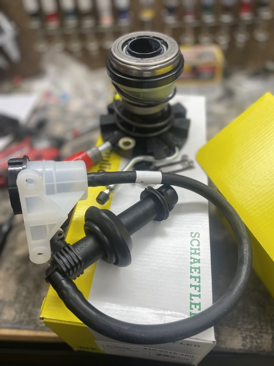

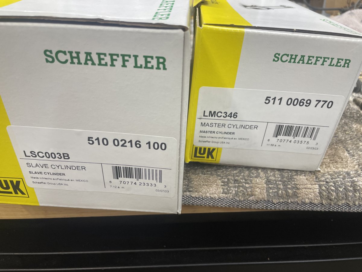

First through my new clutch arrived
This is a luk clutch for a 2001 f150 w the 4.2l v6. To my surprise it is much larger than the one that came off the truck…. New hydraulics included as well. Will have flywheel surfaced in town
I am glad to see it fits the flywheel and the bellhousing, was worried for a moment. This is my first 5.0 to 5 speed in a rbv

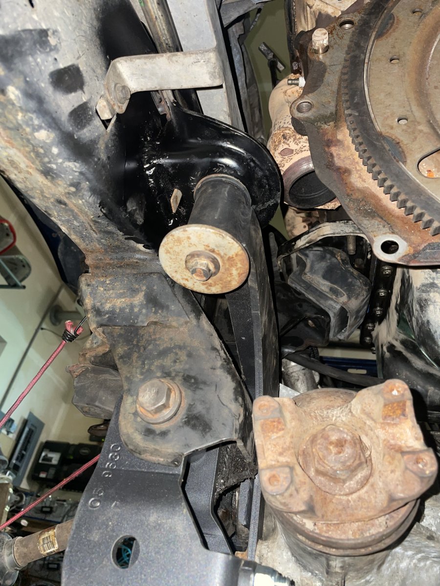

The custom modified crossmember

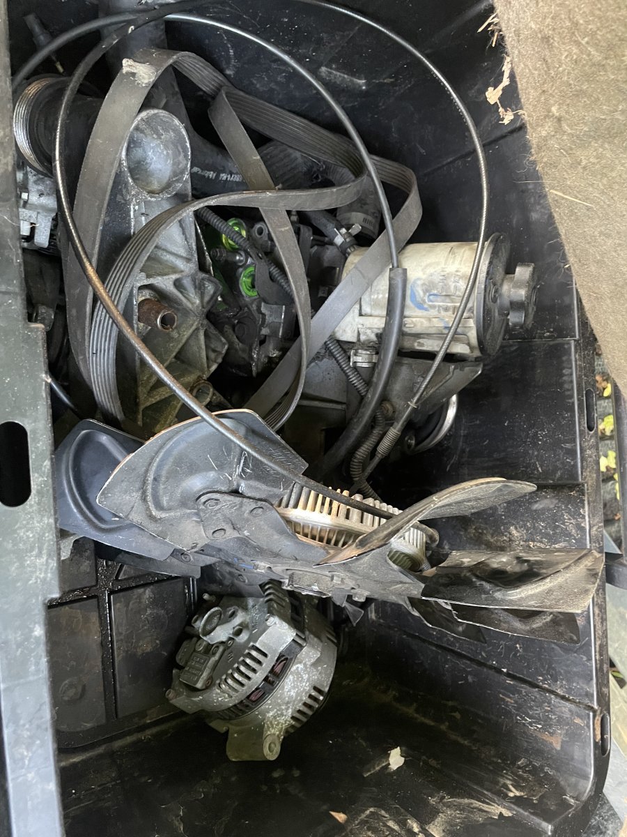

Headed to the junk yard this am for some 5.0 parts, we are short some front dress/serpentine setups. I am always robbing parts off the next 5.0 to complete the one in front of me. We are hoping to change that today!

Went to the junk yard yesterday this time 75 miles away we scored two 5.0 accessory drive bracket and front dress, metal fans, hoses, vacuum lines, etc. prices at the u pull yard have gone way up over $$150 each for this stuff. I love how they ring you up at the counter, shouting numbers at the register guy and then when you get the itemized bill there is a bunch of stuff we didn’t buy…. He was marking every pulley, every hose, every bracket….charged me for “overflow reservoir when it’s actually the power steering pump
Fluid container… wiper arm instead of dipstick…. And “keep your receipts for the return policy” oh yeah like that’s gonna work when it’s listed incorrectly. Then tells me what a great deal I got because he left some things out. Gone are the days of the “how does $75 sound” for the whole wheelbarrow worth… ah well we scored the parts we needed
5.0 stuff throttle cable cruise
Cable and front accessories
Both radiators were fubar so were the alternators

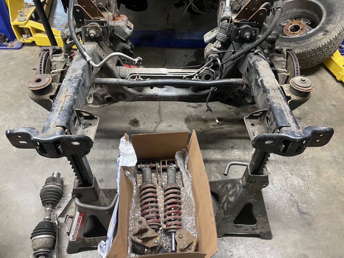

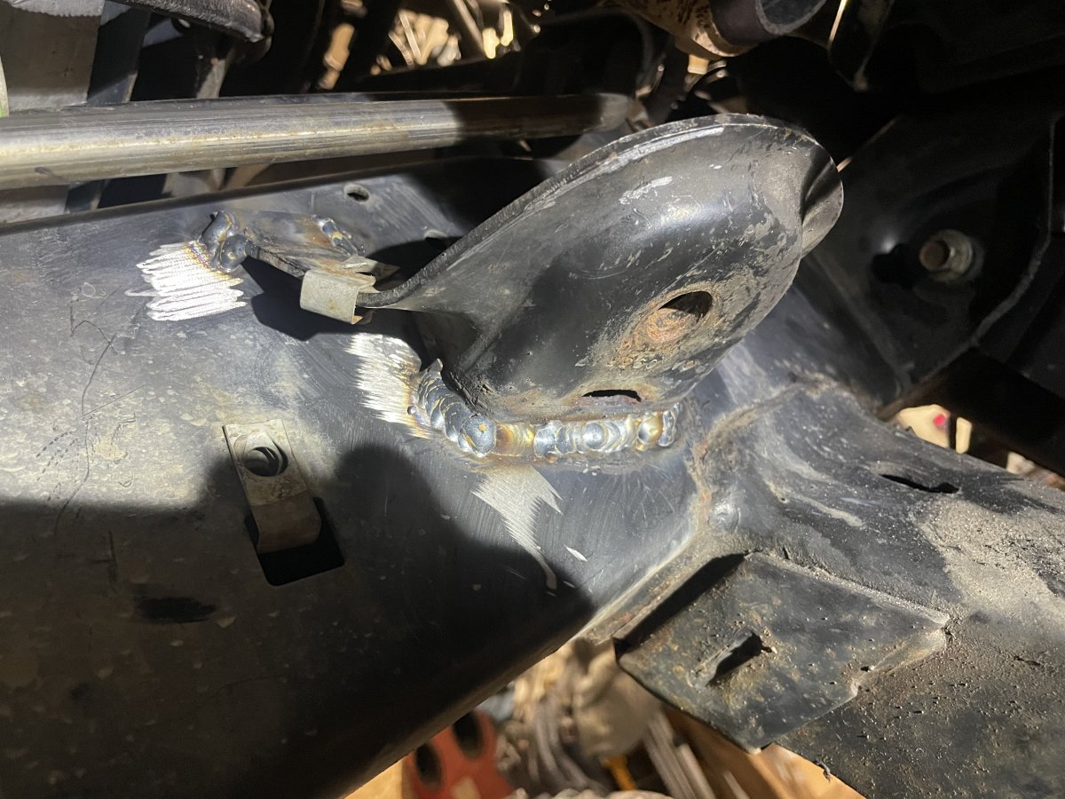

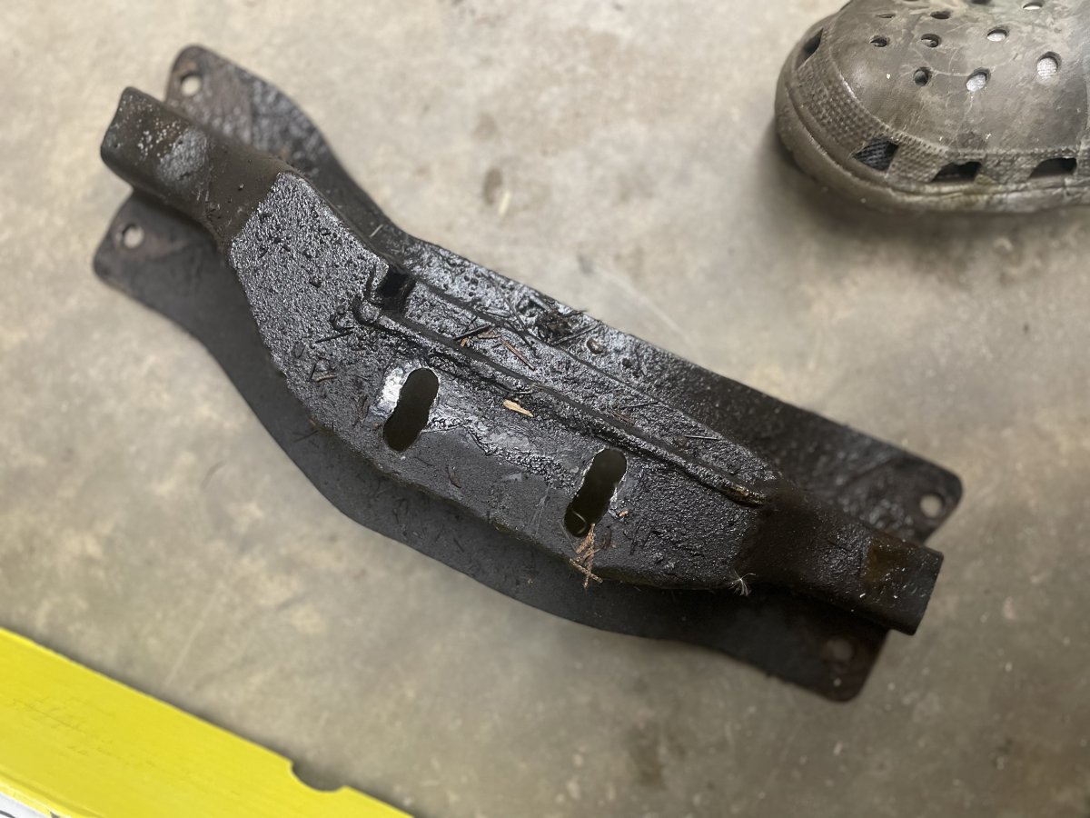

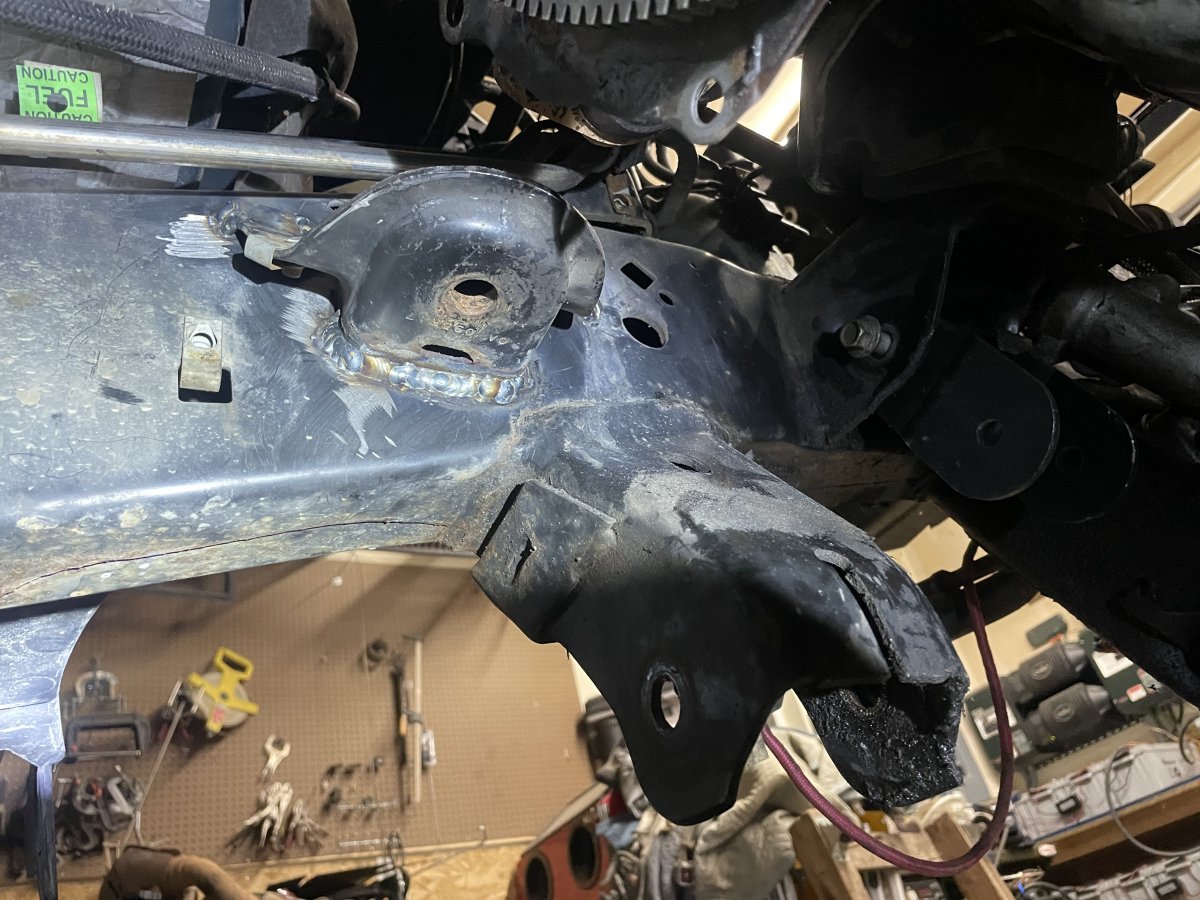

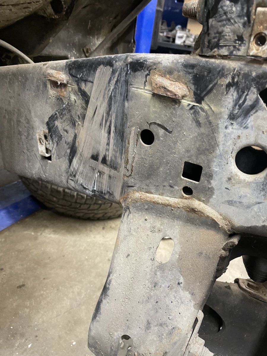

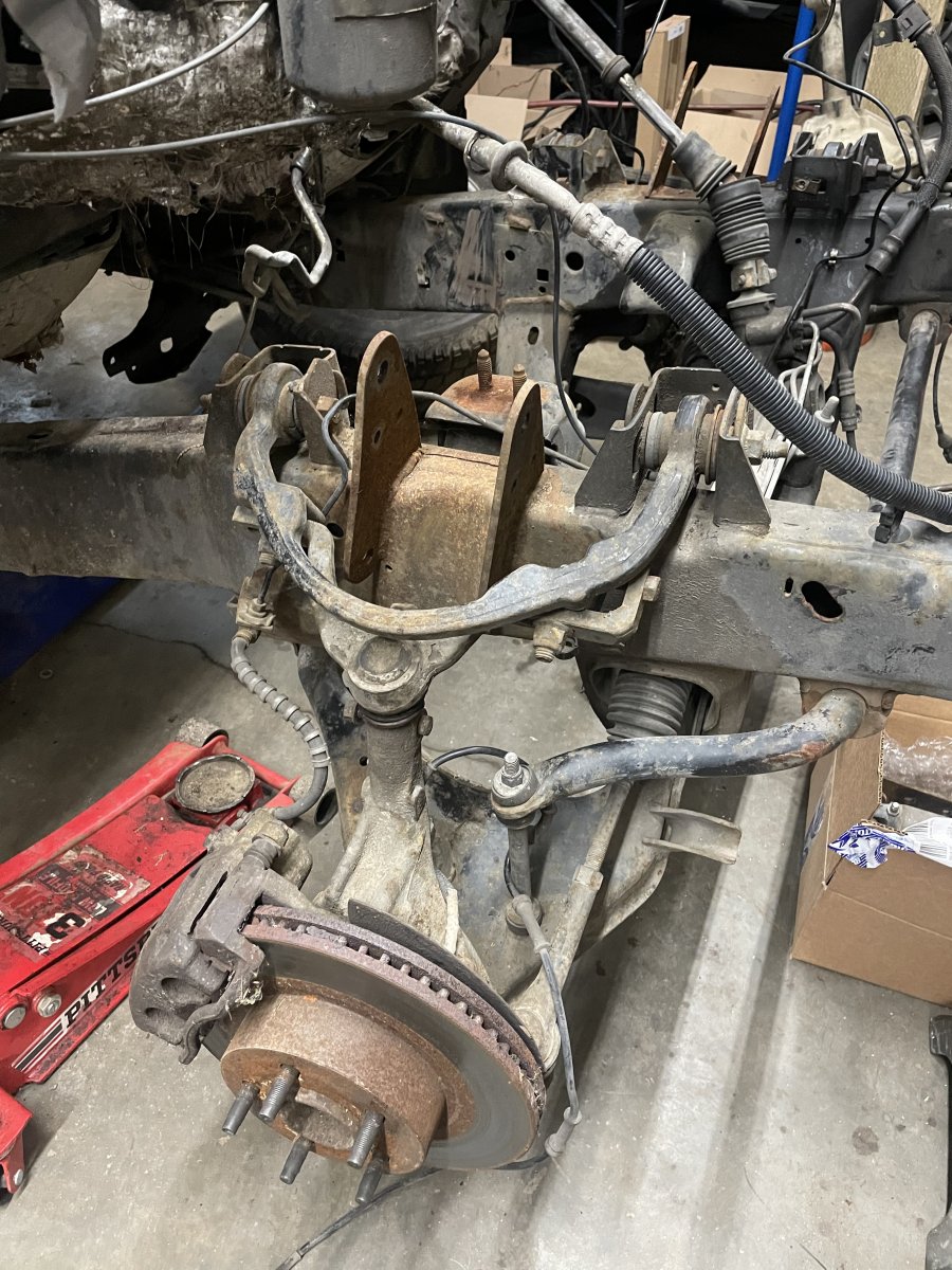

First up we needed a frame bracket in order to install a superlift onto a 05 trac…
Grinder and sawzall made short work of cutting it off the frame

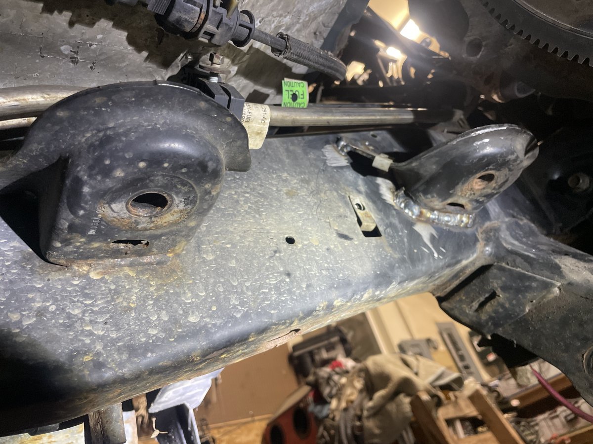

Part was mocked up on new truck, tack welded, diff removed then final welded… stepson happy he can now complete the front lift and stab the v8 trans
Look ma! Twins!
This is why 03-05 tracs this bracket was moved back about 12” so the superlift front diff hanger would not work
Upside down mig welding is my fav
Area was painted and diff was re installed
I will have to do this exact same thing for my $700 03 since I have a used superlift going on it along with the 2” body lift.

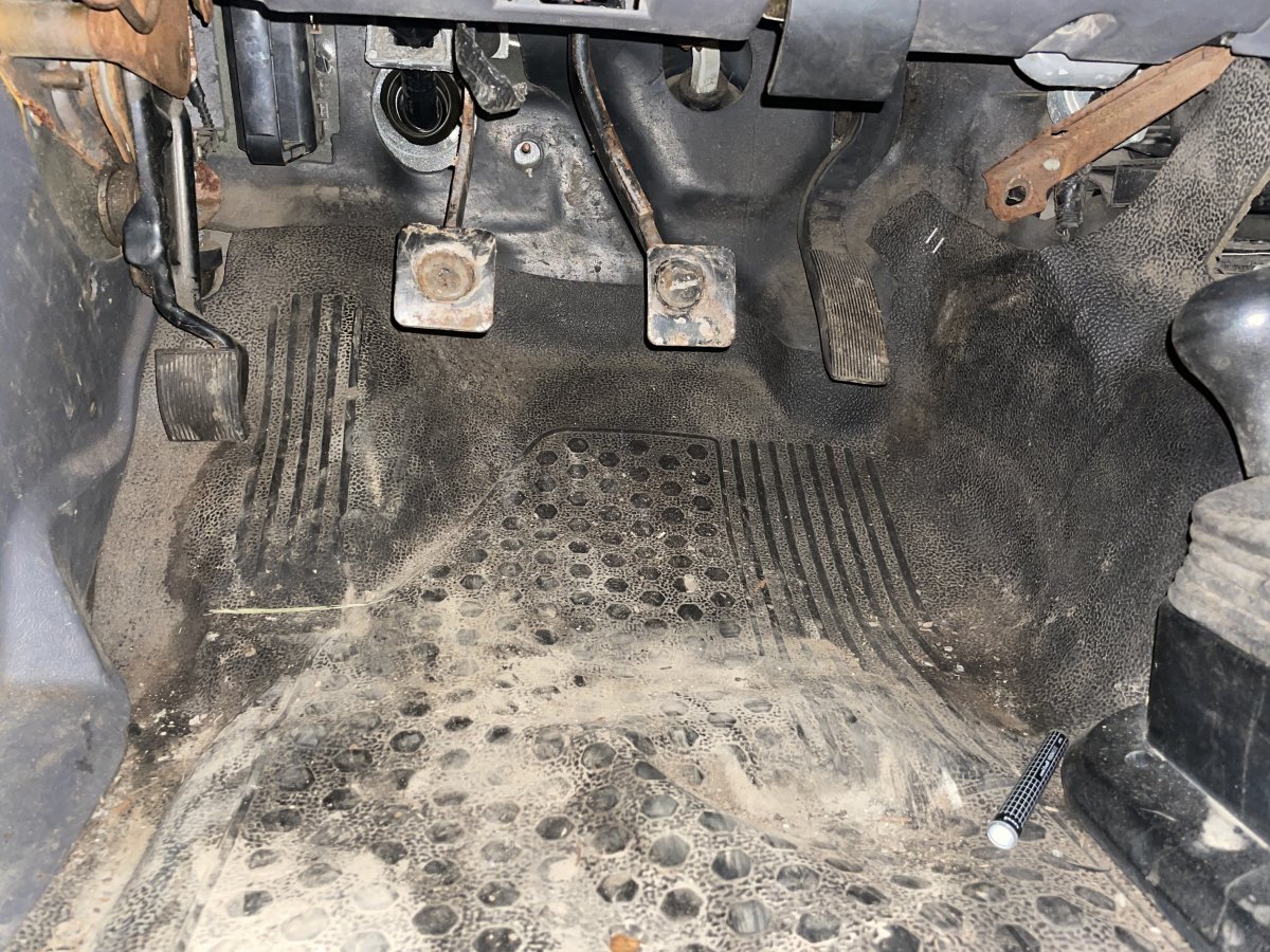

Now to continue on dismantle of “blackie trac” I am after the pedal assembly next (clutch pedal!!)

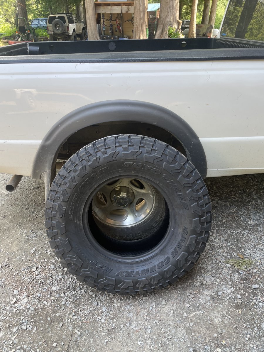

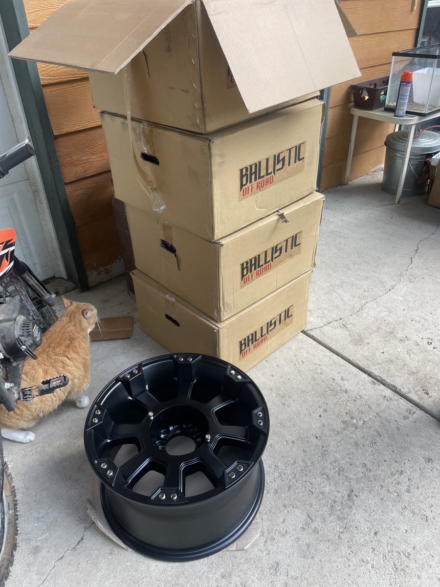

But first i Must stop working on tracs for a bit… the wheels and tires are here for the 07 ranger the other final parts have also shipped. I need to focus on that truck next week get eddiemoney his truck back!!!

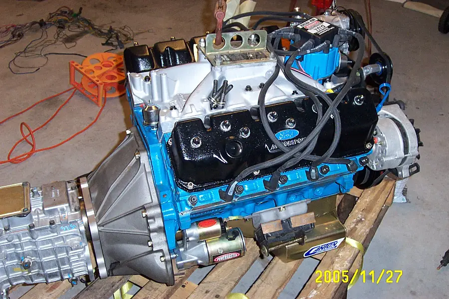

BTW, here's a 400 with the odd small block pattern on it, those were a partial first model year run. This was with a Tremec and the really odd SVO valve covers.
BTW also, I have a box with 400 rods already polished, balanced, and with 351C TRW pistons on them. That project ended but I got the pistons and block done.

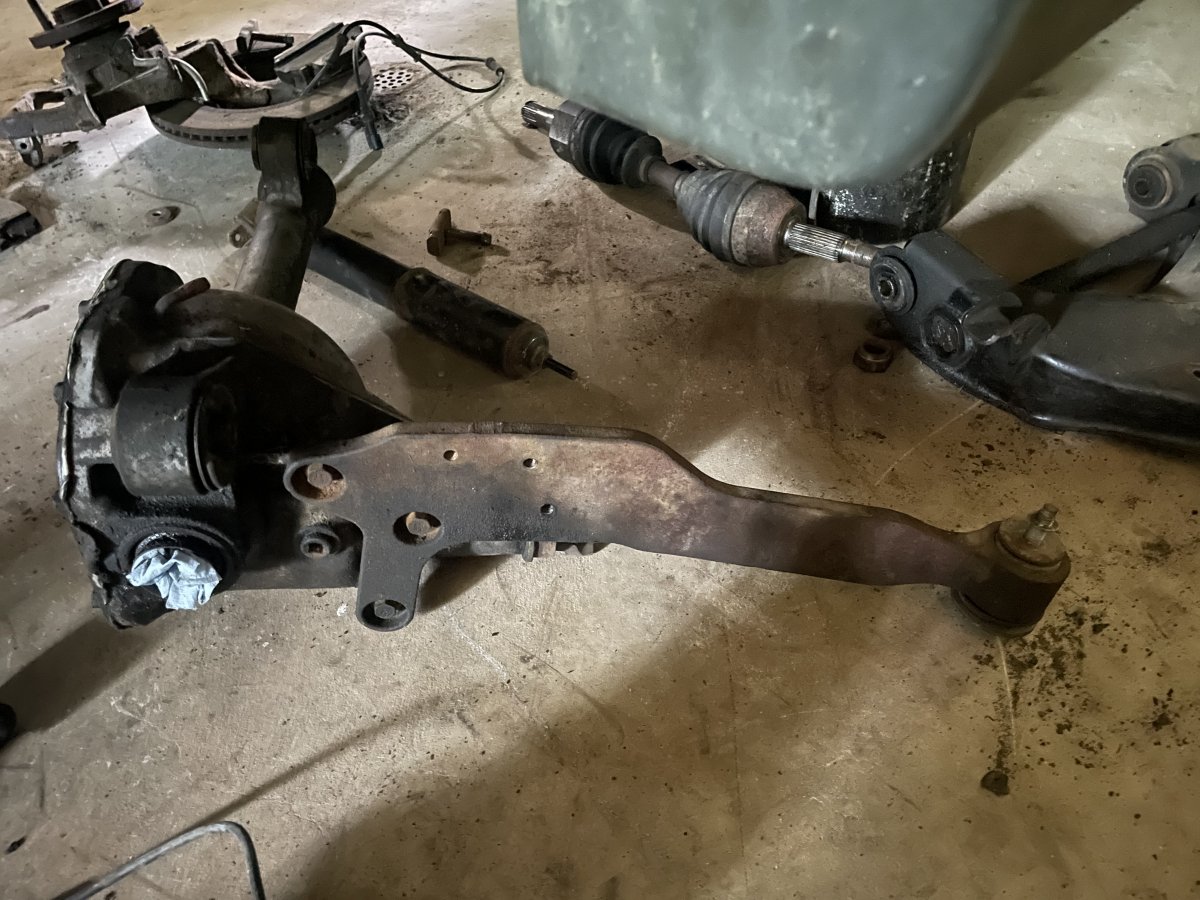

any idea why there are different torque arm lengths? (thats what ive always called em), if i am not wrong, ranger, explorer and sport track all have different length arms. i have 3 4:10 front diffs under my bench. all from explorers. i want to put one under my ranger to try chase a problem i am having, but if you have ever tried to loosen one of those bolts, you will know why i stopped.
