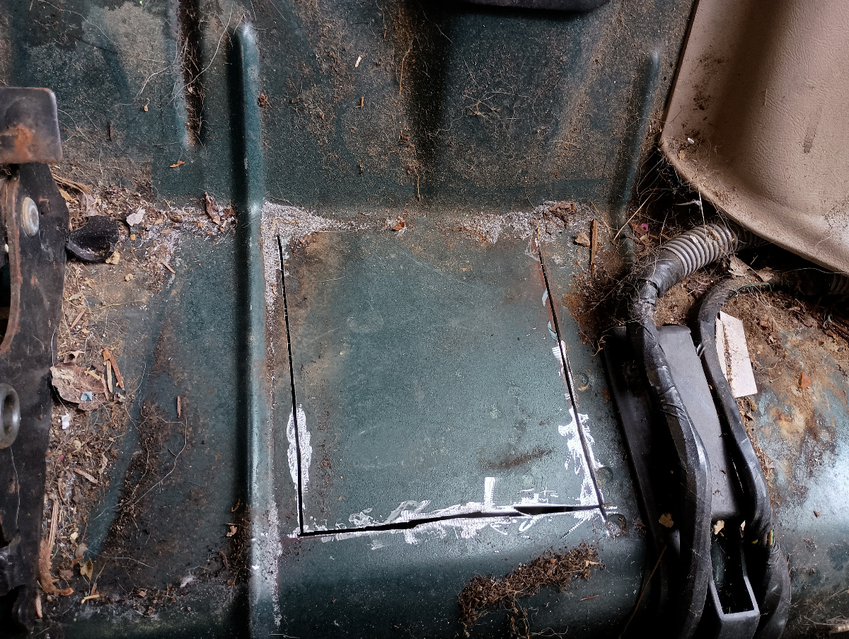

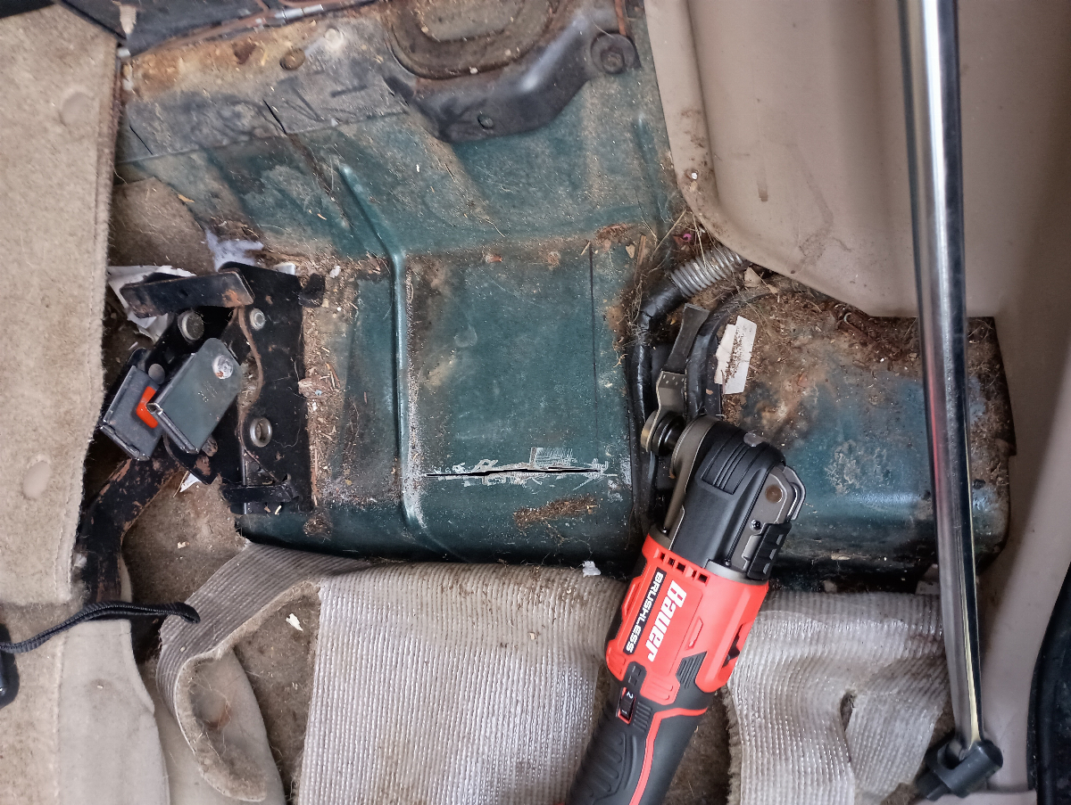

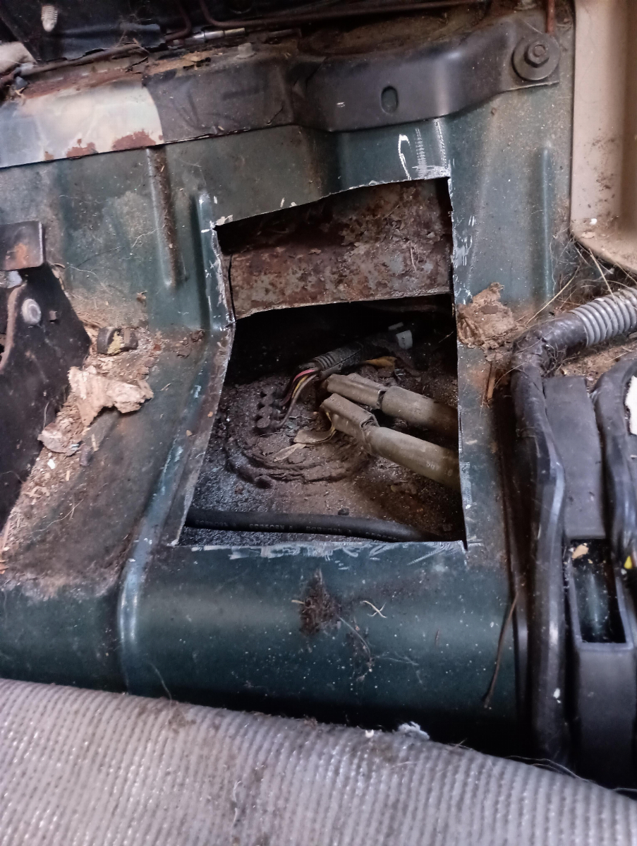

So my pump finally gave up last week. Trying to justify my oscillating tool purchase, I took a whack at it. It took 2 hours to cut with a carbide tip. A grinder would've been faster, but I know I would've slipped and knick something. It sure beats dropping the tank on this rusty boy, though.
