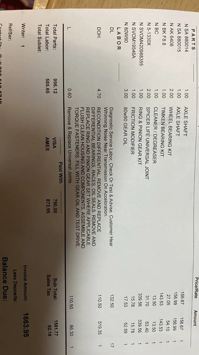

Here's the good cheer holiday news update. First I wanted to thank everyone for input and feedback. Special shout to fast_dave for the Driveline Vista shop referral. So far the rear 3.73 limited slip differential is going to be rebuilt. I'll break that down in my next post. Rear axels replaced along with both u-joints. I'm still waiting to hear back on the slip yoke. I'm having them dig into the front bearings because one side was loose and the other is worse, it's also on the rack. They did mention that my work on the front end looks really good. So that's where I'm at any guess on a price? I'm in San Diego county if that makes any difference.There's a shop up north/here called "drive line service" and I just entered their name and your location and got lucky.

The work should be done early next week. I mentioned that I wasn't in a rush and he thanked me and said he'd it would reflect in the end. I had so many worn parts being replaced that I had to ask where he thought the noise was coming from? His reply was the differential but the only way to be certain is to repair one problem at a time but in this case it wasn't practical.@1stTimer

The question would be: Would the rear axle replacement include install kit or is it the listed bearing kit. Also, even though I don't have the knowledge to complete the work isn't the biggest problem. Space, tools along with it's my only car considerations. As a disabled veteran it would have taken me weeks to complete the job. Trust me it hurt to pay that much. It's all relative, like going to the store for food vs being self contained by growing an slaughtering your own food. Off to work on my 95 P30 chassis.^^^^
Take a pic or scan a copy of the invoice & post!
We'll help you read it
