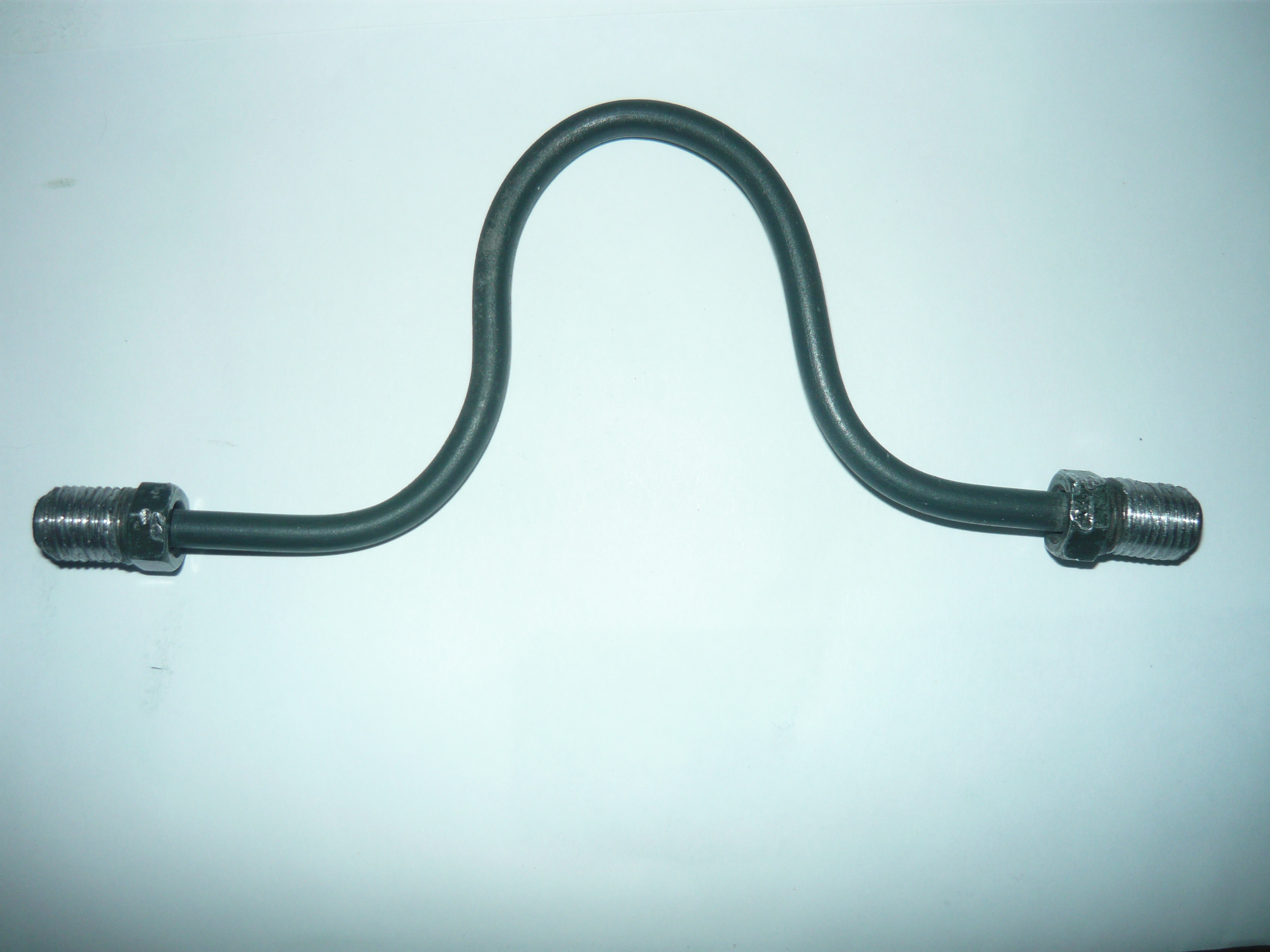

Rear anti sway disconnects
Update 9-2-2014
So the threads of that line were close enough to the other(SAE/Metric) size you needed, and run a die on it to make it fit the other size? Interesting, that will work if the threads are strong enough to hold the torque, neat idea.
I'm going to be moving my rear line too this year, hopefully just bending it. What size is the frame hard line if it needs to be altered?
Good thinking. That's easily forgotten to do. Be a bad deal on the trails if it broke.
I don't know if you remember, but when we did mine, we used a 10" L x 3/8" line, and made it into an S. We did get the union from OH Really's IIRC.
I carry a spare, for this brake line in the parts bag, just in case this ever gets over extended, and needs replaced on a trail.
I did have to run the die up and down slowly, it cut off quite a bit of material. I hope it will hold. However if they have a small chunk with the correct ends in stock I will pick it up along with the coupling union.

Threads re arranged from metric ( i think) to 3/8 -24 and now it fits into the fittings of the brake stuff i have laying around.
Just need to get an inverted flare union. They have these at oreillys so I will pick one up asap

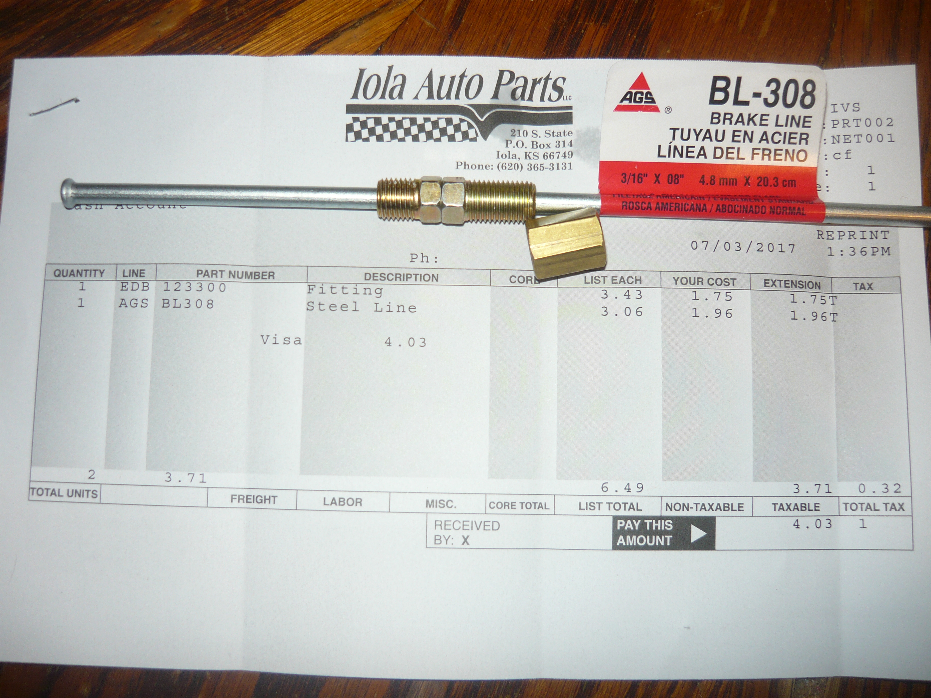

Just to put the idea to rest.
O'reilly did indeed have the union for 5.95. However, I decided to try another store. Glad I did.
Now my whole idea of using what I had to save money seems silly.
our shop has a rack full of little pieces like that. Various fittings that are less than common are on some of them. It makes it so we can run entire vehicles worth of new lines and still tap into the screwy fittings some makes and models use. Glad you found the right fitting for your application.
Yes, those special lines are gold.

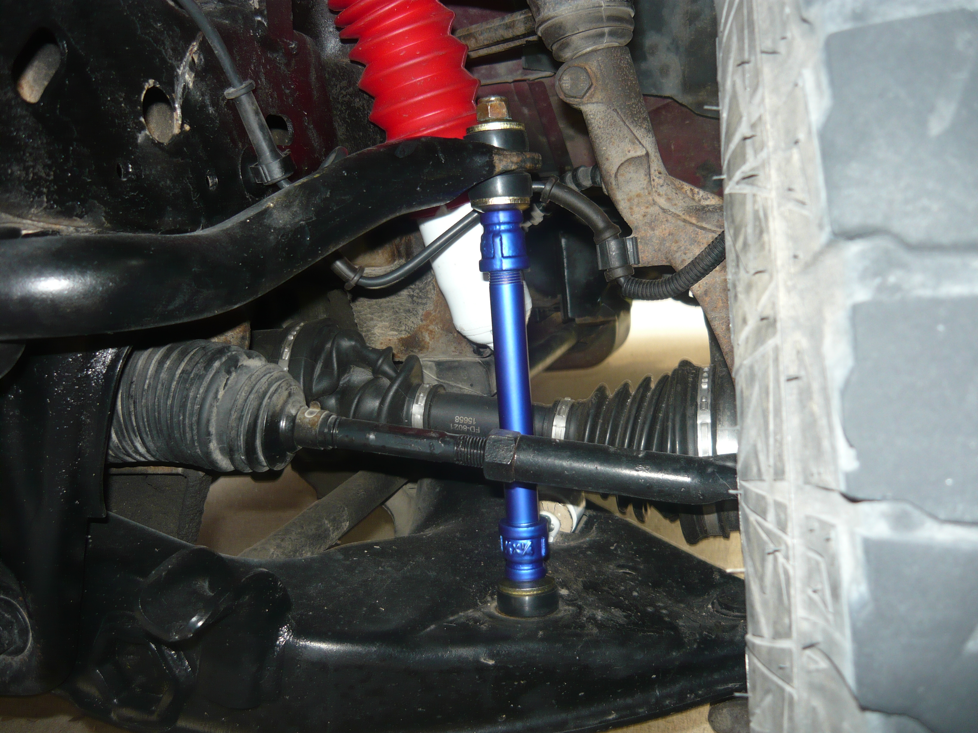

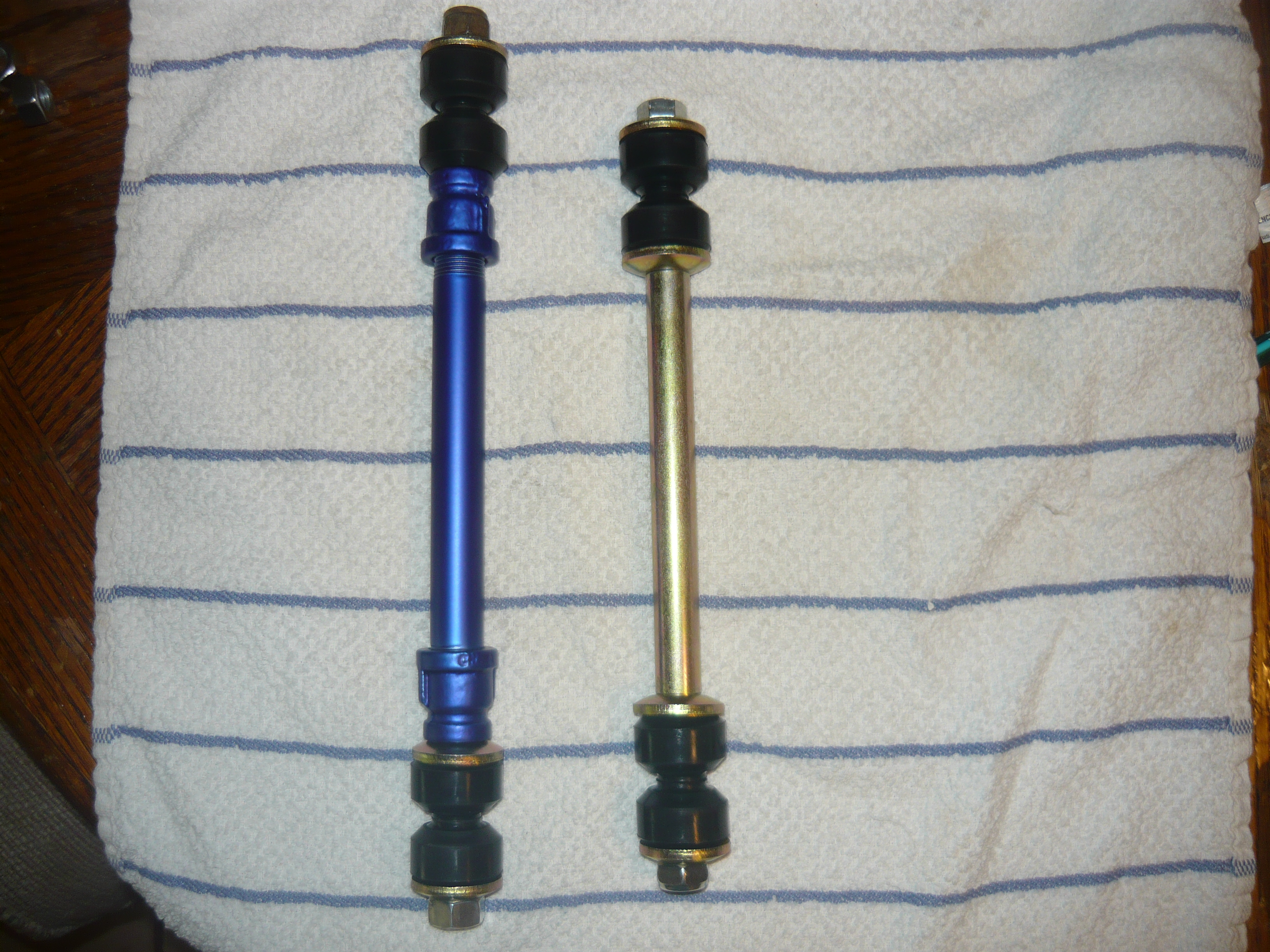

Problem:
Lifting an explorer via TT causes issues. One of which is the sway bar endlinks are now too short. This causes the sway bar to sit unlevel, binding the endlink bushings until they crack.
7/16 all thread and some plumbing. Now the sway bar sits level and the bushings seem happy.
Picture 1 shows "turdle links" on left, stock on right.
BTW
The MOOG problem solver with 7/16 upsized bolts suck ass, and are actually a problem creator for the next guy going in.
The spacer tube is not seamless. This allows them to rust inside. I had to cut mine off after only 2 years.

Hi Mike.
I am going to answer this with a short story.
Back when I had a superlift installed on the black truck I had some 4" extended links made from 3/8" all thread. Although it is shaky, the all hread held it's shape and did not bend after being in Moab on another truck, and in colorado where i broke 2 cv axles.
These are made with heavier 7/16". If these work out when tested, then yes I would be happy to make them in color choice. That is my plan. I just need to make sure they hold up better so they would be a viable option.
I wanted to get these done yesterday, and the local place had no 1/2" sleeve or tubing in stock. That is why i used the plumbing fittings, but to be honest I kinda like the beefier look.
That works for me. Of course I'd be happy to run some tests for you here in the desert if ya want.. hehe
That's cool Jon, you added some color to a typical drab part.
I wasn't happy with the end links I had on hand when I upgrade my car. I had an ES kit planned to use to replace the Addco kit(their stuff is usually garbage hardware). I also had pieces from past saved end links. I took them apart and chose the best bolts, sleeves, and bushings. Those have held up for me for 50k+, and I put them on my mail truck for a while.
I like the Ford blue bushings the best(90's Mustangs), and the ES large diameter bushings are just as good. I think the Addco bolts were right for my lowered truck, and some old unused sleeves were the right length. Mixing components often works well for non stock height trucks.
Don, I went with rubber bushings this time around, for a softer feel, and to see if they will last a little longer. However i think it was the severe angle that made the other split so bad.
