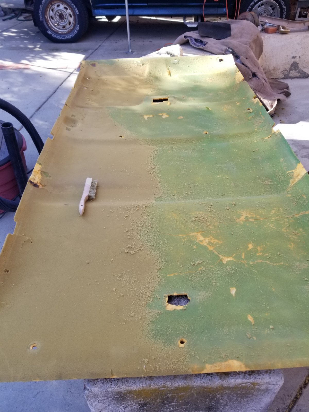

Its going well. Now that I have stripped the foam off the headliner, I am glad I stopped pulling on it. It has fractures all over. I ended up using a large brass brush I got from Harbor Freight because I wanted the steel brushes in the same kit. It worked very well. I put no downward pressure on it and scrubbed the foam off. Took a few hours, but did not do any more damage to the headliner. Its ready for repair and recovering.
In progress;
Completed

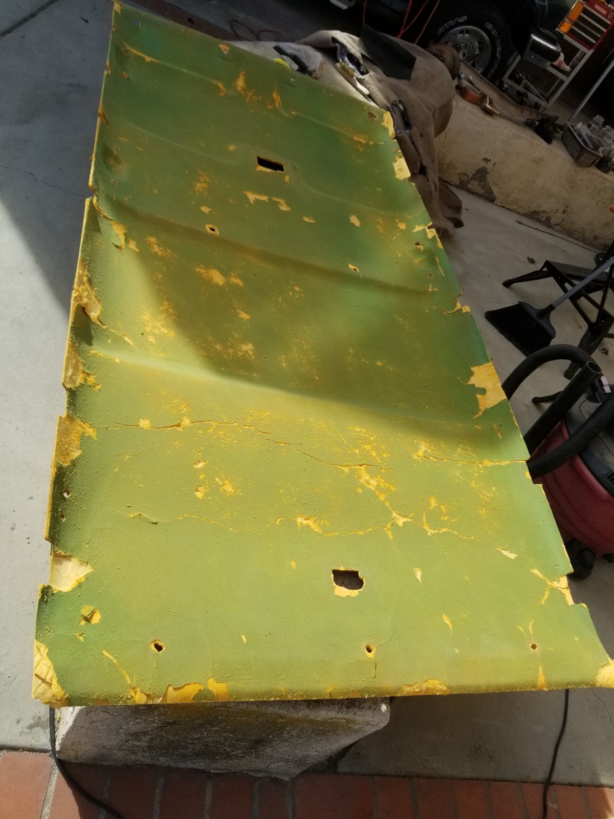

Fractures in material

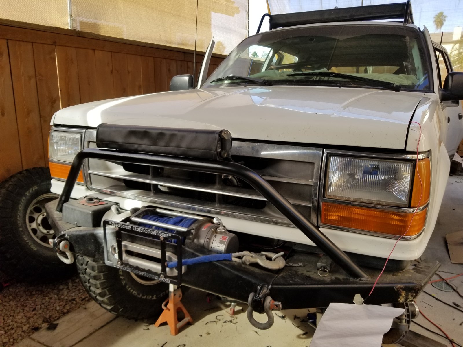

I also mounted the bumper LED light and grill.

Sorry the liner removal was a bust. I was afraid you couldn't get it to drop low enough, to pull it out the back. You seen what I meant about how it cracks.
It only needed to drop a few inches. When I pulled the cage off the cut tubes, the headliner dropped right on top of the cage and then I could pull it out the back The dropped cage will make a good rest for reinstall. The headliner is cracked, but mostly intact.
What about a strange repair to it? Use something like mesh tape for drywall with something like that cheapo bedliner in a spray can that they sell at home depot? Together I would think that you could "glue" up the cracks and give the headliner a coating of a rubber like substance that would help it stay together?
I think that would look awful and make a mess. My interior is going to look pretty good when its finished, so it was worth it to me to recover the headliner. Like I posted earlier, if it was strictly a trail rig, I would have just ripped the cloth that was separating off.

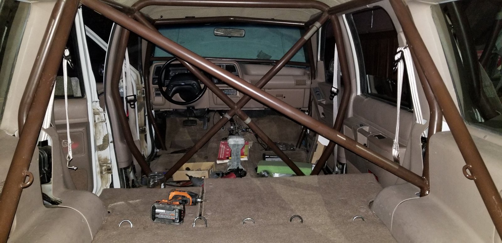

Cage welded back in, cleaned up and painted!

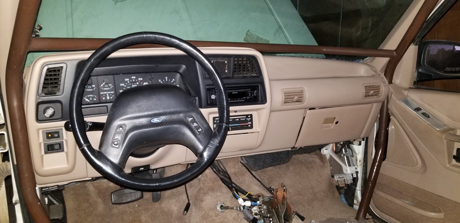

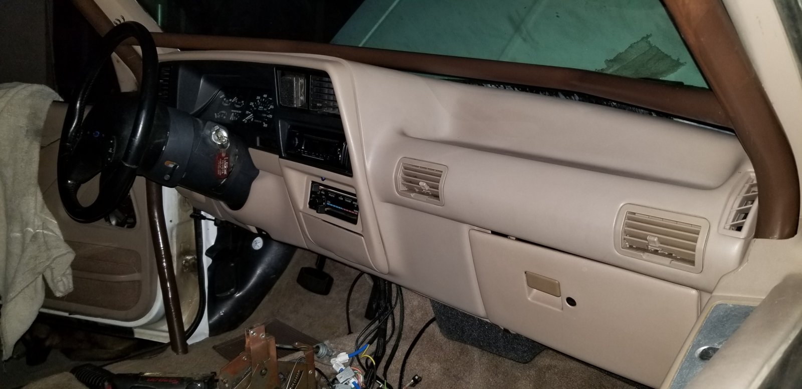

Dash - COMPLETE!

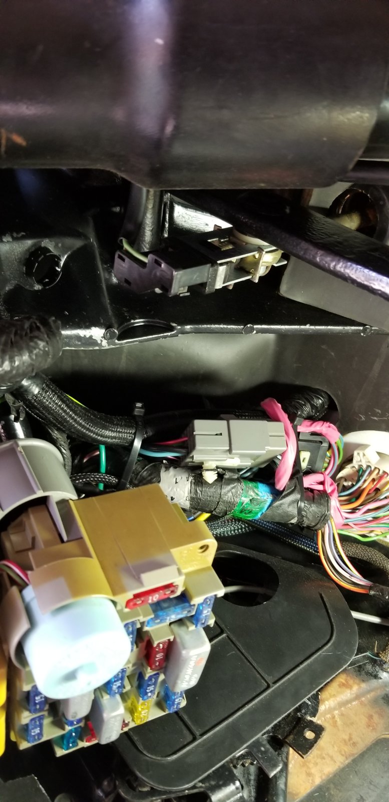

Interior wiring - DONE!
Also got most of the interior panels, and the rear cargo carpet installed. Just need the console, lower kick panels and seats installed, and interior will be finished. Should be able to get that finished tomorrow. Looking at the pictures, I need to adjust the glove box door.
Picture of wiring under the dash. Sure looks different than version I and II.
