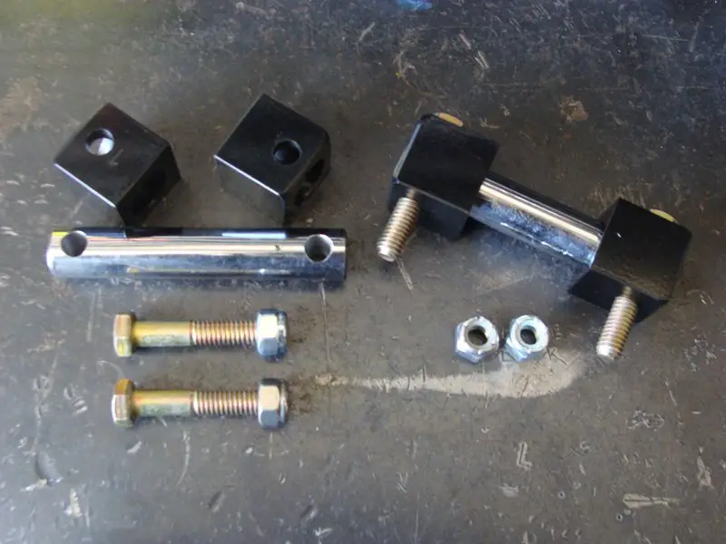

I decided to make my own BPE out of a piece of chrome plated rod I found in the scrap and some 1" bar stock.
The benefit of the BPE is that they preload the bushing, I added 1 washer per side since I made a small calculation mistake in the length of the pin and wound up with zero preload on the bushing. With the washers the preload is perfect. Another benefit is that the BPE are much beefier than the stock bar pin mounts.

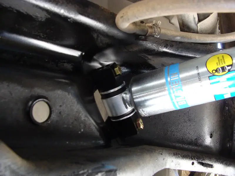

And installed:
