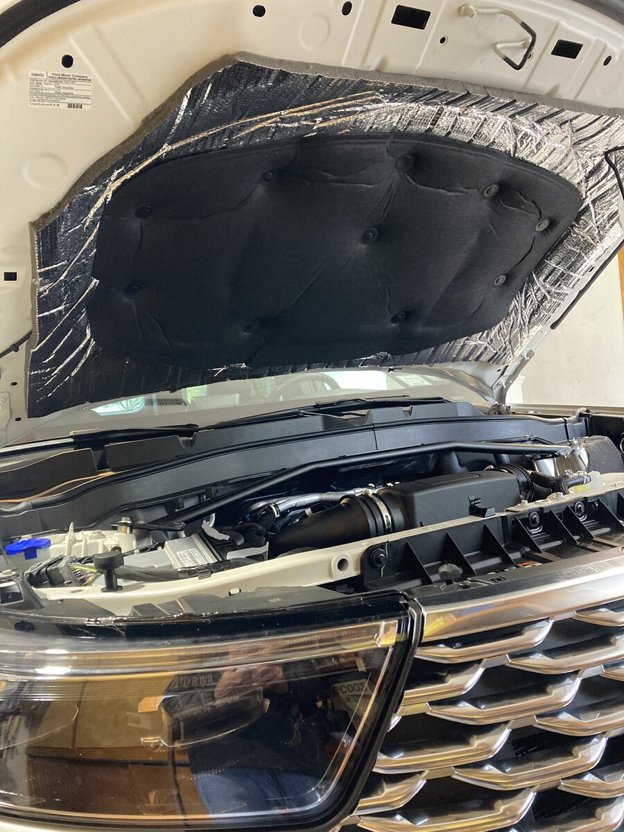

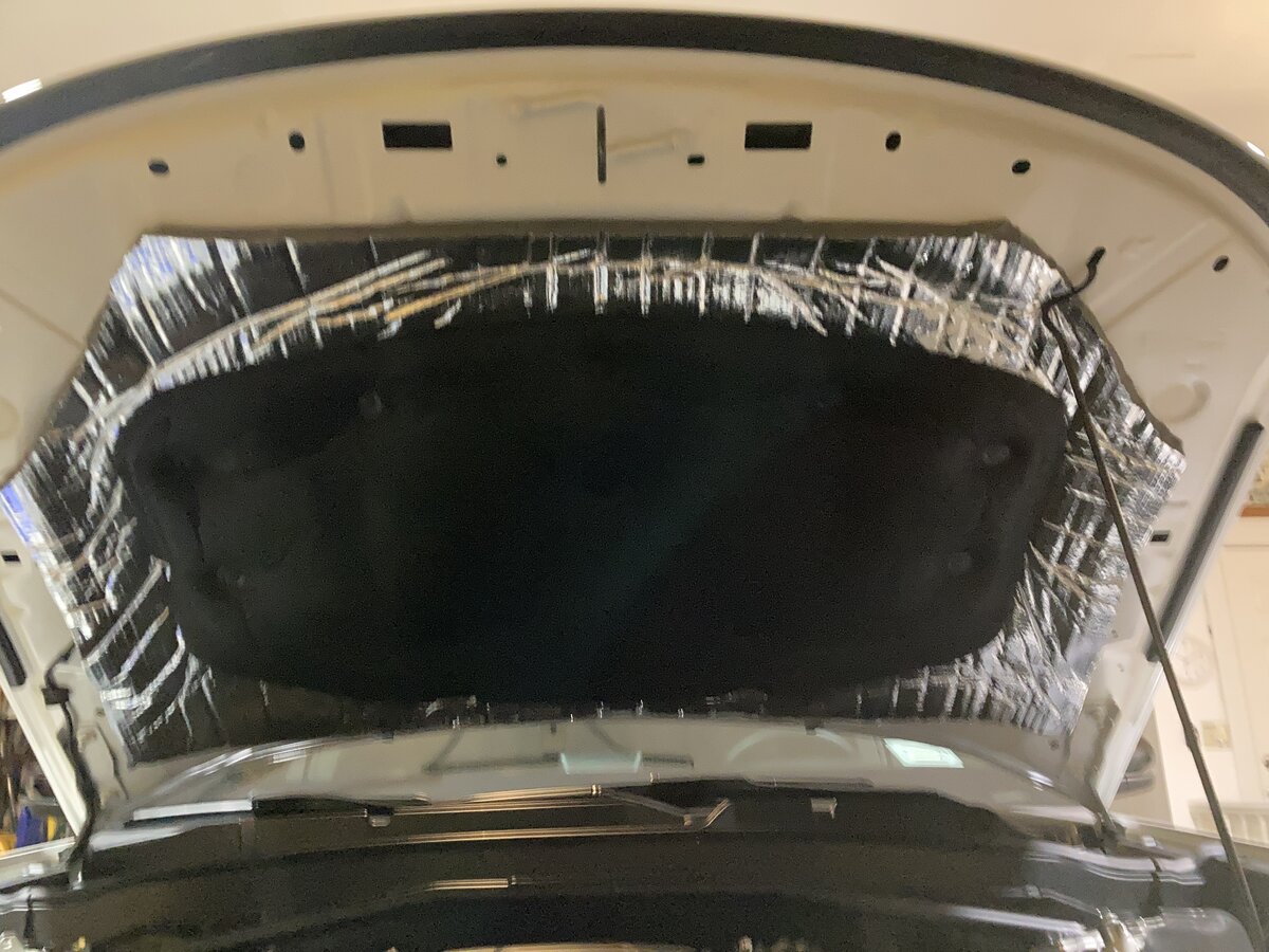

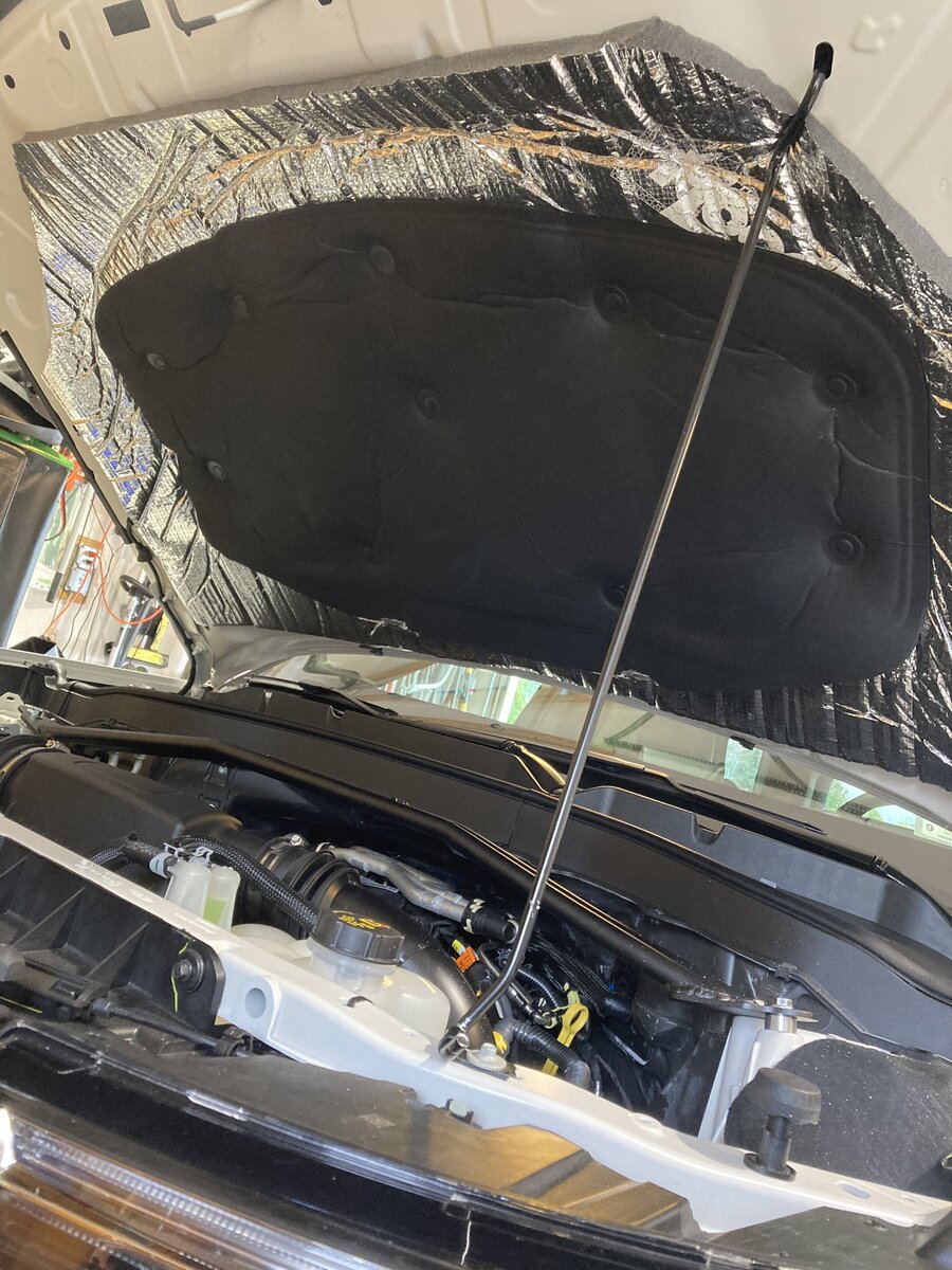

Significantly reduced engine noise inside the cabin by installing a Dynamat hood liner under the oem hood insulator.
I fabricated longer nylon retainer clips from the oem retainer clips by cutting off the short stem, drilling a hole in the original head and inserting a long nylon retainer.
Dynamat HoodlinerView attachment 422890View attachment 422891View attachment 422892

The Dynamat hoodliner is made up of an acoustical foam that converts sound waves into heat energy. So there must be a lot of sound waves bouncing around in the engine compartment that the small oem hood insulator cannot mitigate.
I'm very pleased with the Dynamat.
