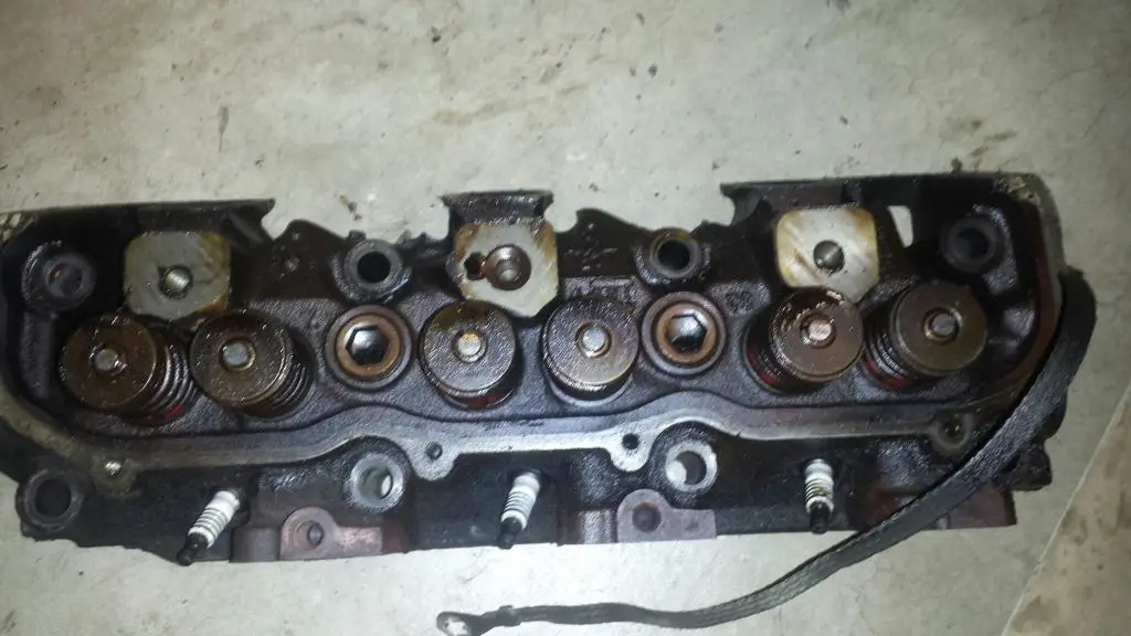

Man its Saturday. ..lol I didnt have to work at 8am thank god!! I thought I was dreaming about posting on here.so any word back from titian? Back to where that chunk fell outa of? Which hole did it come out of? Look down through the oil passage way on the middle mount for the rocker and make sure its clear, maybe even take a hanger or something and run it up and down through it.make sure no chungs or anything is in there, that will clug your rockers right up..
no word yet from titan. in the pic where the piece is sticking out of the head you can see where it came from. it was too big to slide out, i had to break it into two pieces to get it out.
in this pics its the oval hole with the black smudges next to my point finger
