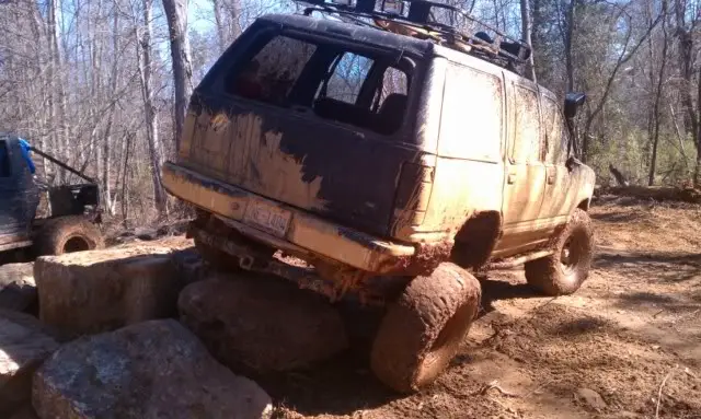

Well took the explorer out wheeling for the last time with it current setup yesterday. Not too much damage. Just typical stuff. Another window, more body damage, and another axles. Broke the short inner passenger side this time. A buddy of mine went along in his Sammi he just got the the first time. It will be unstoppable with some gears and lockers.
Was trying to go up a slick ass hill in 2wd and about made it to the top on the second try and it started sliding back down and got little bit off to the side and slide right back into a tree. Busted out the rear window and bent up the hatch a little.

Little bit high centered here.
Hooked the winch up to a tree and started winching it off and damn near pulled the tree down on top of the explorer. Let off and it stood back up so moved on back to the next bigger tree and winched it off.

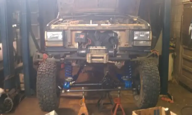

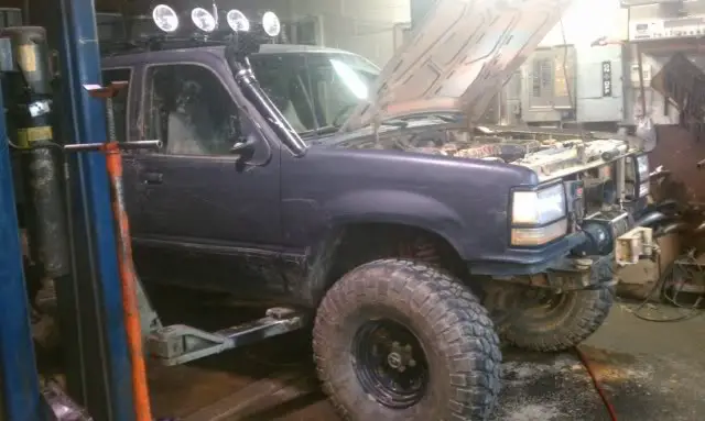

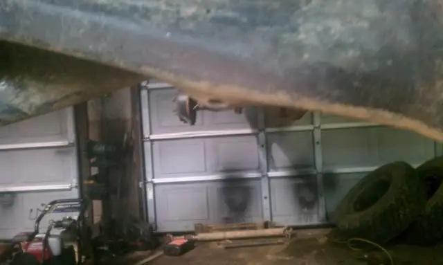

Got some work done last night. No more body lift, no more slider, and no more suspension. Stay tuned for more later tonight. About to head back down and start working again.
35's with no body lift or slider.

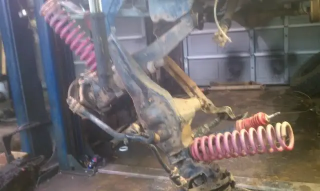

Hows this for suspension travel. lol

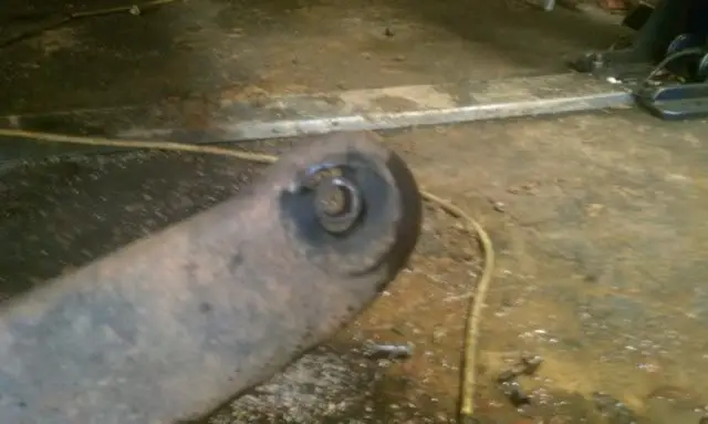

Beams are all bent up and cracked.
Pivot bushings? What pivot bushings?
How I left it for then night.

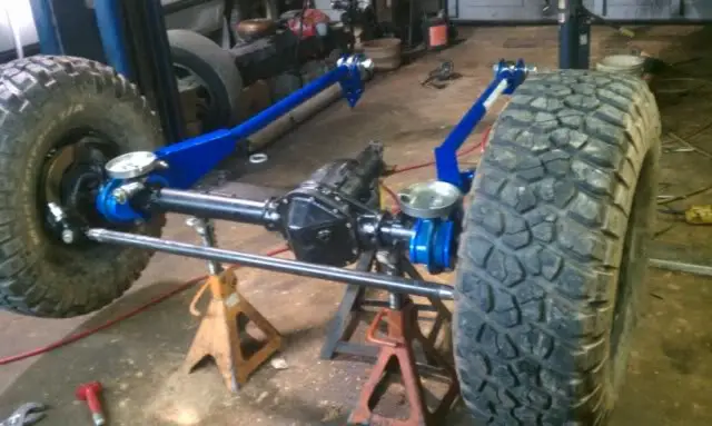

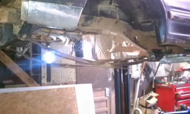

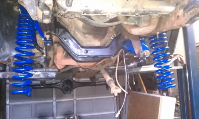

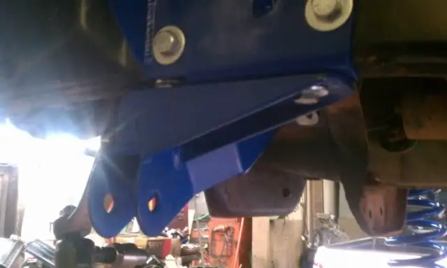

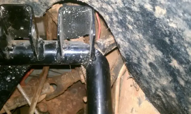

Didnt get as much done as I had hope to yesterday. Had to run get my wheels changed out and a couple other things. Going to try to get it as a roller today. Only thing left to drill hole for are the radius arm mounts.

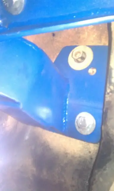

Ran into some issue with the driver shock tower. It wants to occupy the same space as the clutch master cylinder. Has to notch the top corner out. Going to go back and plate the notch and gusset the inner corner.
Lowered it down to get a idea of how it will be.

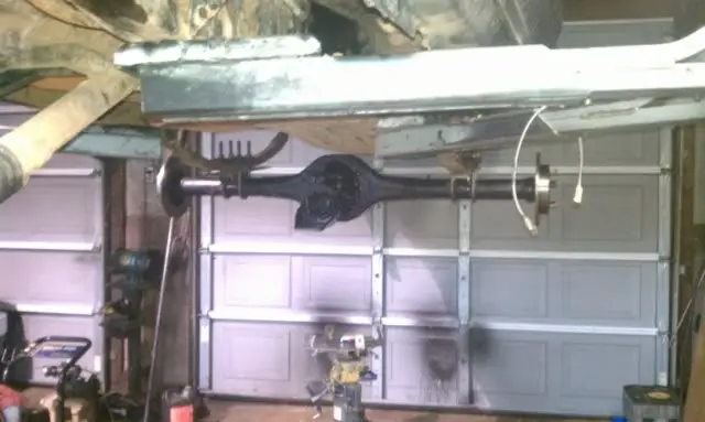

No 8.8
9" Hanging(pinion angle not set)
