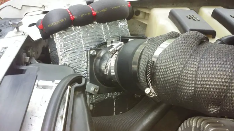

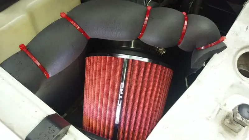

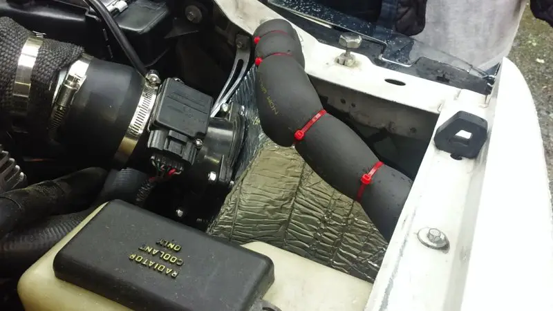

I added back the original Plastic wall the fa ctory snorkel fits thru. The space right there is totally enclosed and should stay somewhat cooler than the rest of the hot engine...
Are you going to do anything with the upper rad hose? I’m wondering because I built mine so it would get the intake away from the hose to prevent it heating the pipe.
