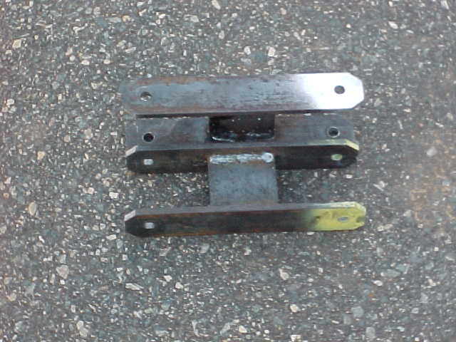

Here is a pic of my shackles.Tell me what you think..The plate steel is 5/16 x 2".The mounting holes are 8.5" center-center.The plate in the middle is 3/8 thick.My stock ones are 5.5 c-c so I am hoping to get about 1.5" of lift out of these.Does anyone know if this is right?
