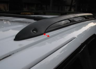

I measured here:

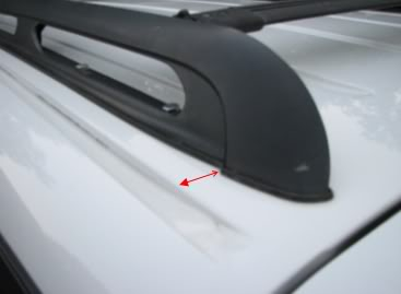

And here:
The rails should NOT be in the outside slots on the roof. This is the main difference between the mountaineer and explorer roof racks.
