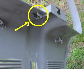

Lift up on the front edge by the mirror- mine was already gone, but there would normally be a clip here, that simply lifts out of a hole cut in the door shell. If you pull forward, it will break that clip.
The clip is normally at the top of the panel, you can see where it broke off:
