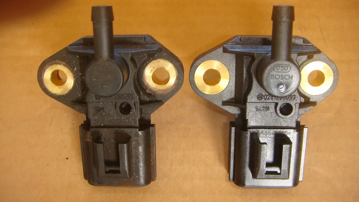

My Explorer has 173,x.. miles on it and yesterday it threw a P0193 (Fuel Rail Pressure Sensor) code. The recommended fix is to replace the sensor which is located under the upper intake manifold. I have searched this site but did not see a write up on this procedure. There are two videos on Youtube that cover the steps to remove the intake manifold and remove the sensor. One video mentions a deep well 8mm socket, wrench extensions, a T20 torx and the intake manifold's gaskets. Is there anything else I should make sure I have on had to perform this sensor replacement?
